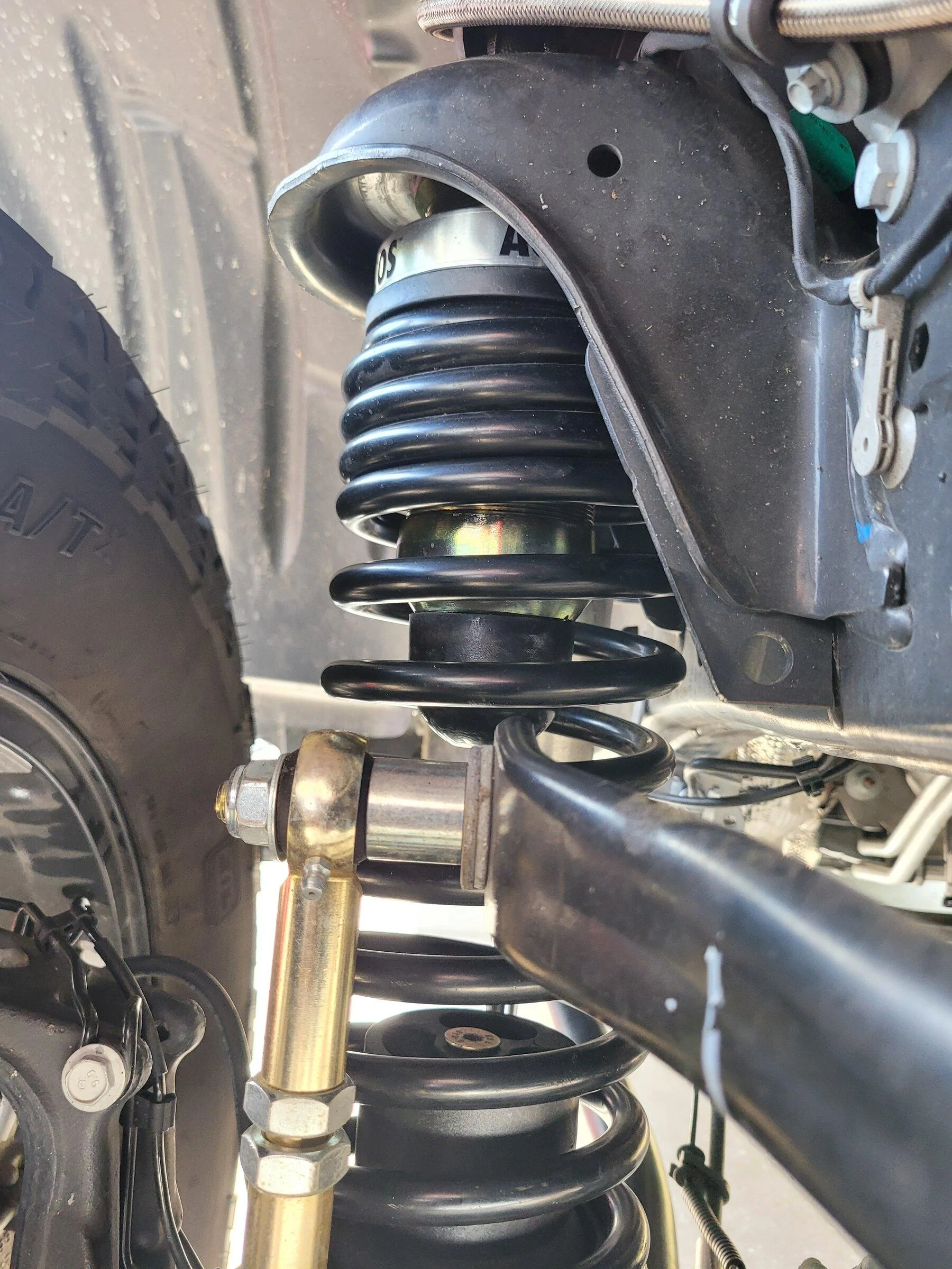

could I refer you to JKS ACOS spacers( I hate to put plastic suspension component) and bumpstops or hydro stops..
Jeep Gladiator Eco diesel Suspension bottoming out on normal roads 20210407_151002
