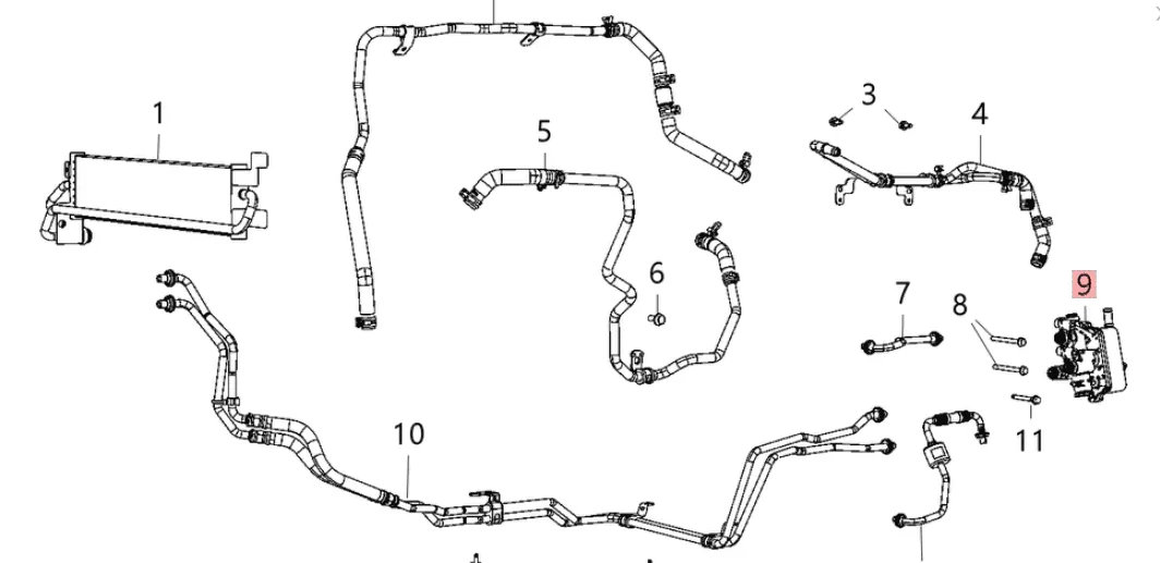

10 in your diagram is actually the transmission heater and is the single only point where coolant and ATF may make contact.
The cooler is a distinct item that's in front of and low in front of the radiator.
There is no coolant in the cooler, the heater - that's the only place they come close to each other.

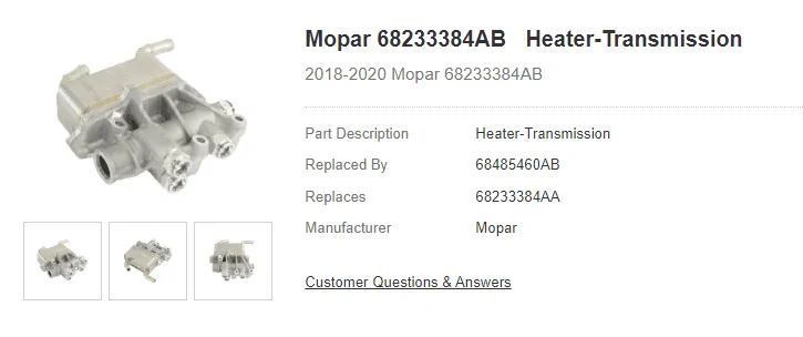

This is the transmission heater-

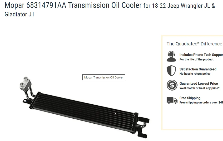

This is the cooler -
Yes, correct. It’s the transmission heater. Service manager first thought there was a leak in there. It was good.

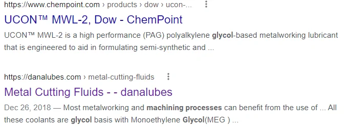

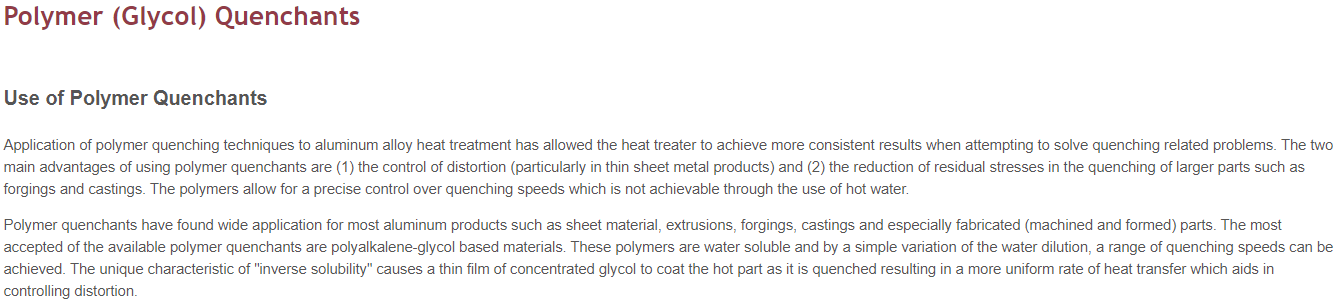

I've read in other threads that Glycol is used during production of the transmission housing. If it is not fully rinsed, it will appear if a lab test is done on the fluid. How much it takes to damage a transmission after assembly is not clear. I bet a lot of these would show some Glycol in the fluid if tested. ZF probably accounts for that during production.
Glycol isn't used only for these transmissions, it's one of the most common coolants and lubricants used in milling, drilling and so on. It's an extremely common item used in any sort of industry where aluminum castings (and likely others) are made.
ZF and MOPAR are but a drop in the bucket as far as who uses it.
