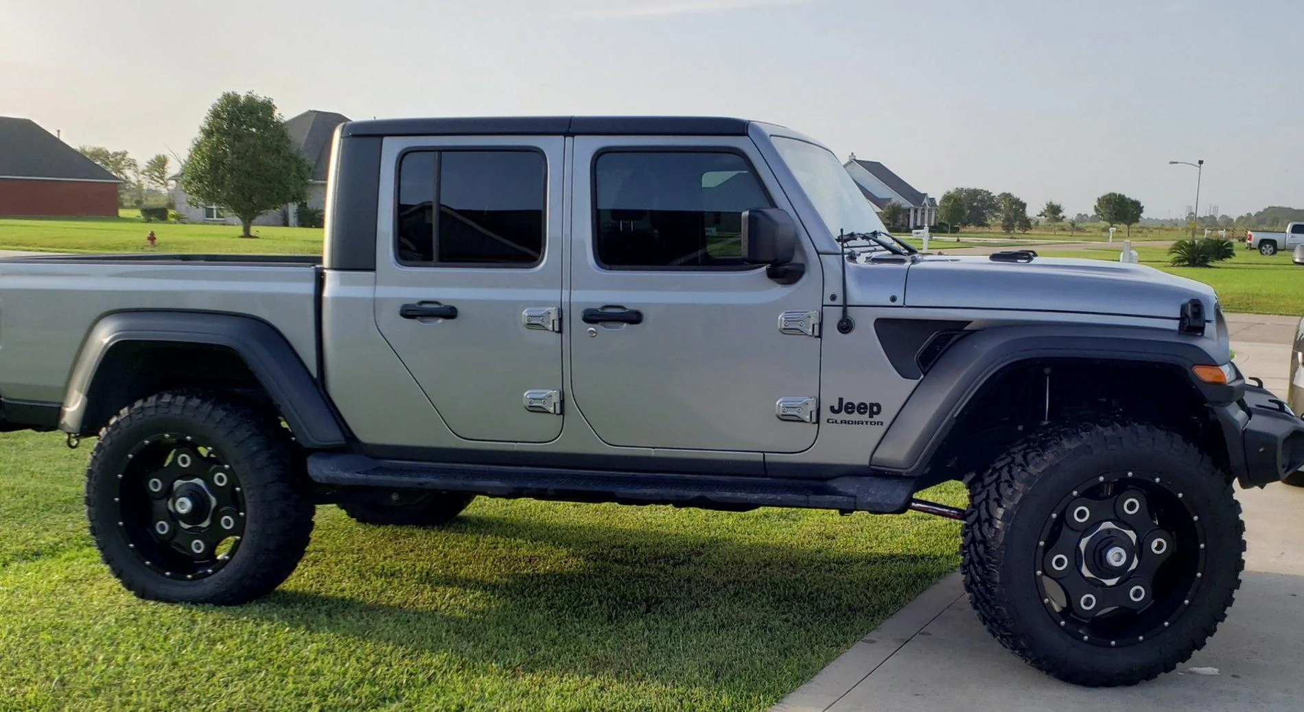

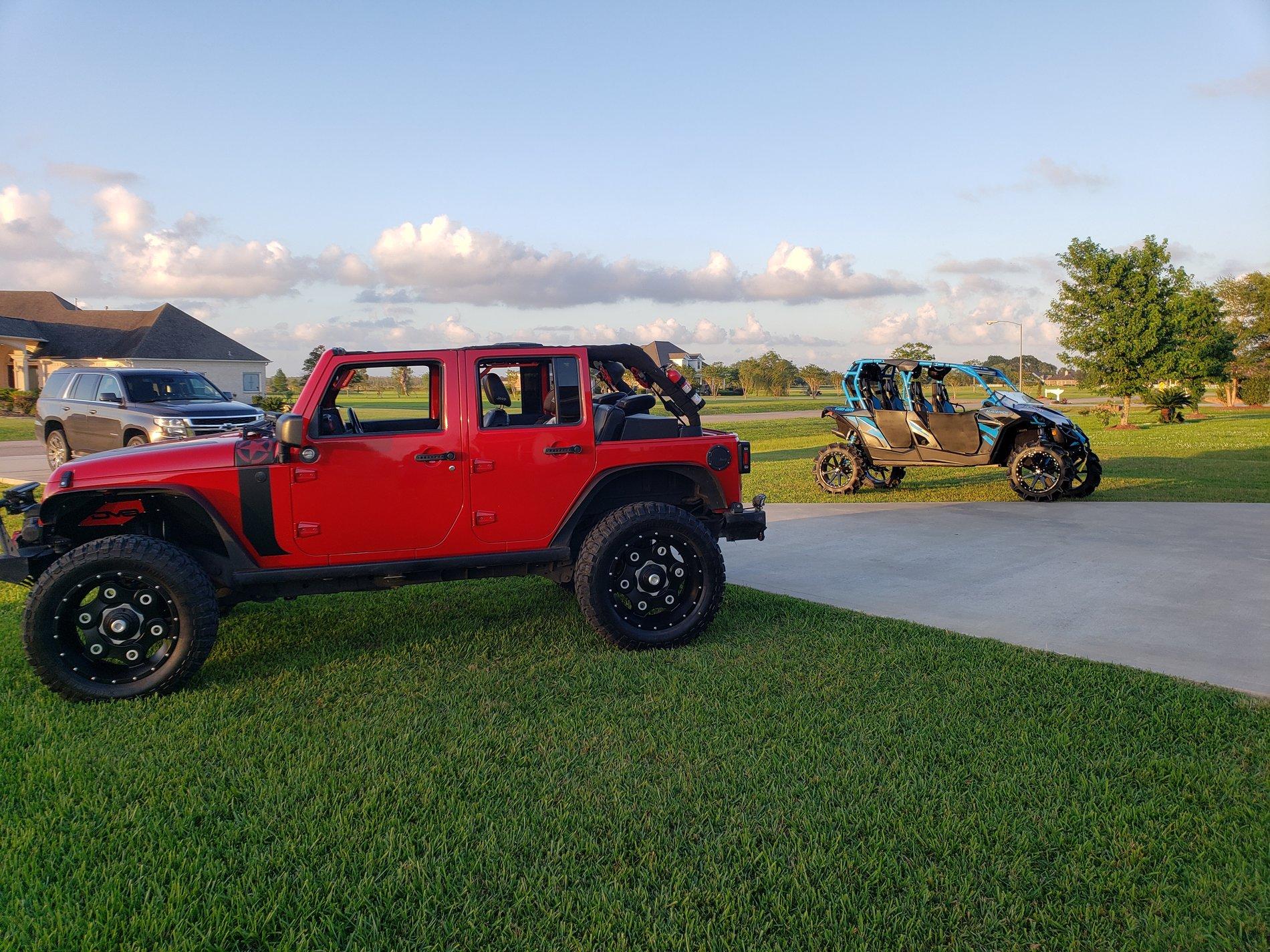

I am running essentially the same set-up. 37x13.50r22 RBP Repulsor (78.73lbs) and Moto Metal Link 22x10 (51lbs). I bought these a few months ago and put them on my JKU knowing that I was gonna move them over to my JT when I bought it. I had a JKU Sport w/ 373's and compared to that, my Sport S Max Tow drives like a dream. Compared to a Corvette, it is a blind 3-legged dog with Gout. I haven't had a chance to pull my SxS yet but am planning on taking it down to Crystal Beach for Labor Day weekend. I'll report on how that goes.
