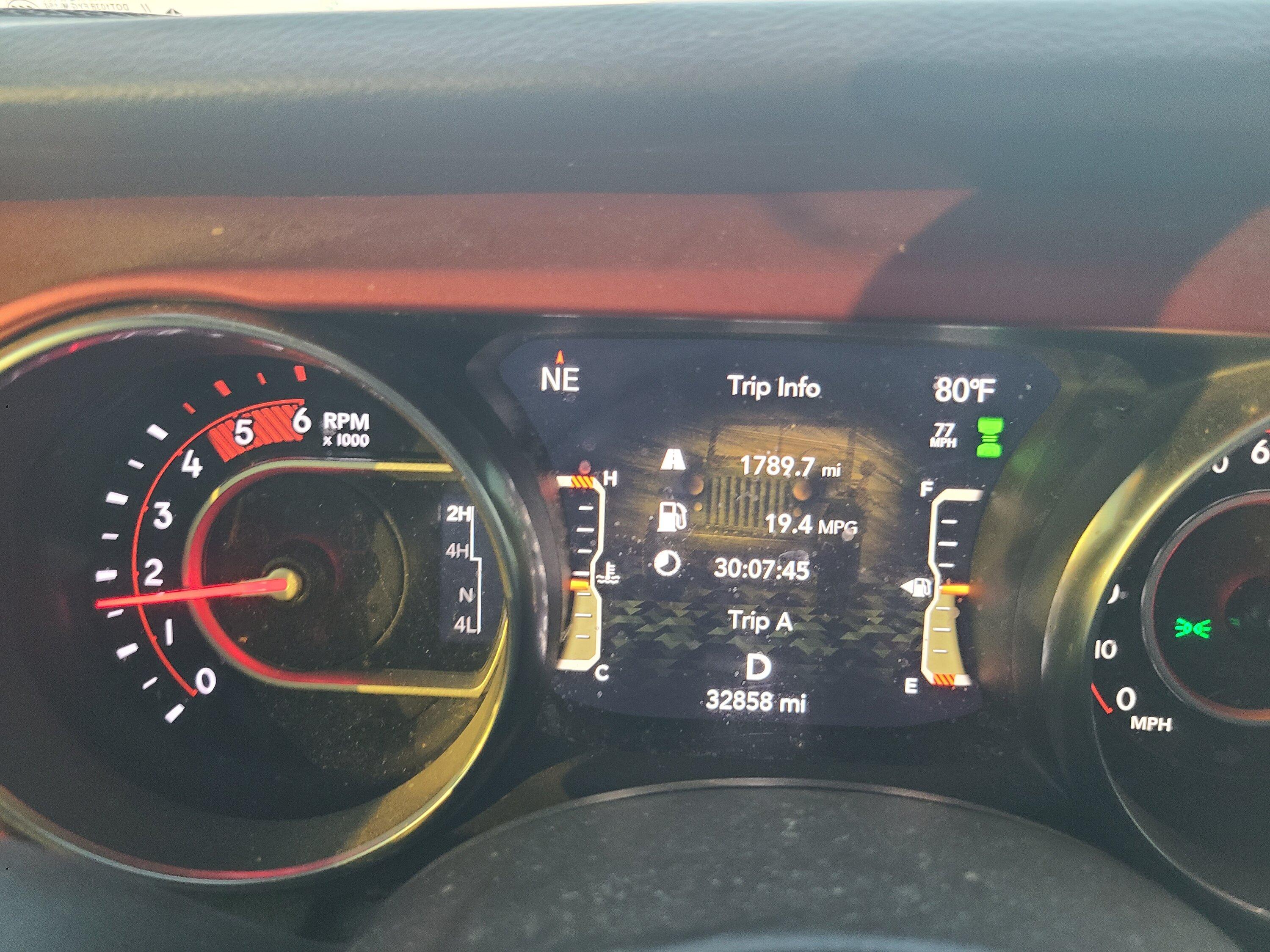

So for the third time now major failure of the diesel exhaust system and had to drive 65 miles to closest dealer. They did a forced regen and put me back on the road in 4 hours. Since then with a full overland load and averaging 82mph on cruise. Here is what it looks like

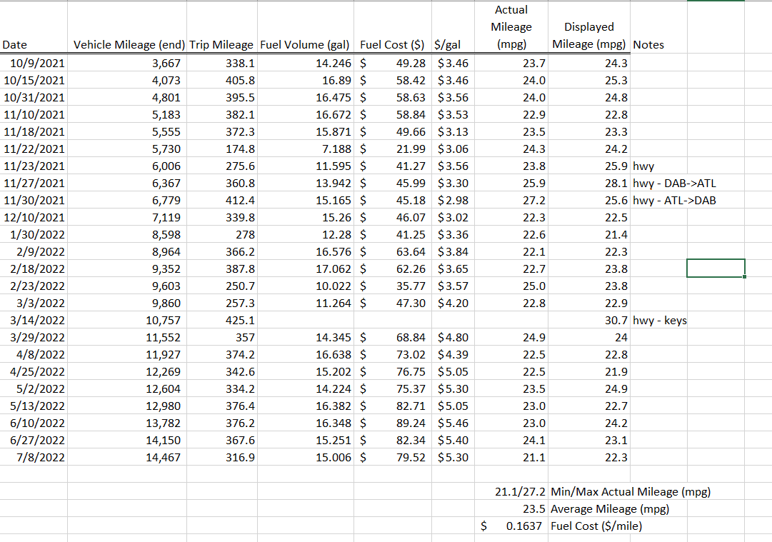

21’ Willys Gladiator Ecodiesel
Engineer
Stock diesel Willy’s. Almost all driving in Florida unless noted. 24 fill ups and 8k miles. Real data, non anecdotal.

Now that chart is not only believable but also very accurate. I too have found that the MPG displayed on the dash is higher than the actual.
So many claims of high MPGs here seem to be bogus, especially for the non-stock JTD's

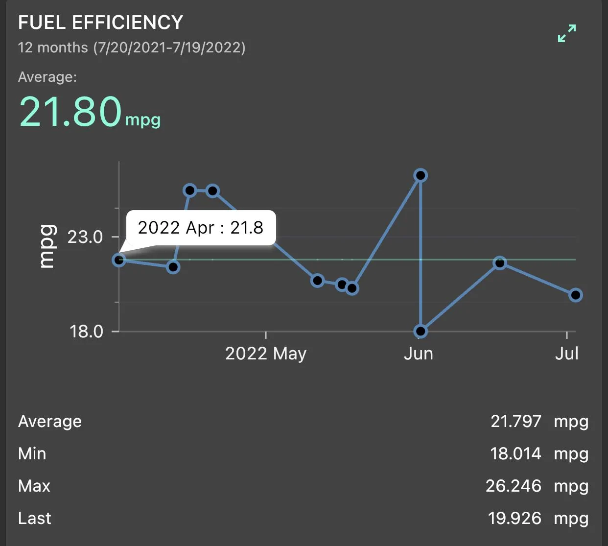

22 JT Rubicon EcoDiesel
Haven’t had the truck for that long (22 JTRD) here is my data. It’s all accurate beside one or two fill ups where I had to guess the odometer from a missing picture in my library (usually take picture at the gas station). Peak are usually long highway drive days. I unfortunately do a bit too much of city / traffic in highway for my taste but I try to get it to do some highway miles as much as I can on weekend
Ive been going to a gas station that I believe has so so diesel so I’ll try to stick to shell & chevron for the next 5 fill up or so to see if it makes any difference. Suspecting the other one is high moisture and not that efficient. I’m also introducing hot shots starting next fill up.

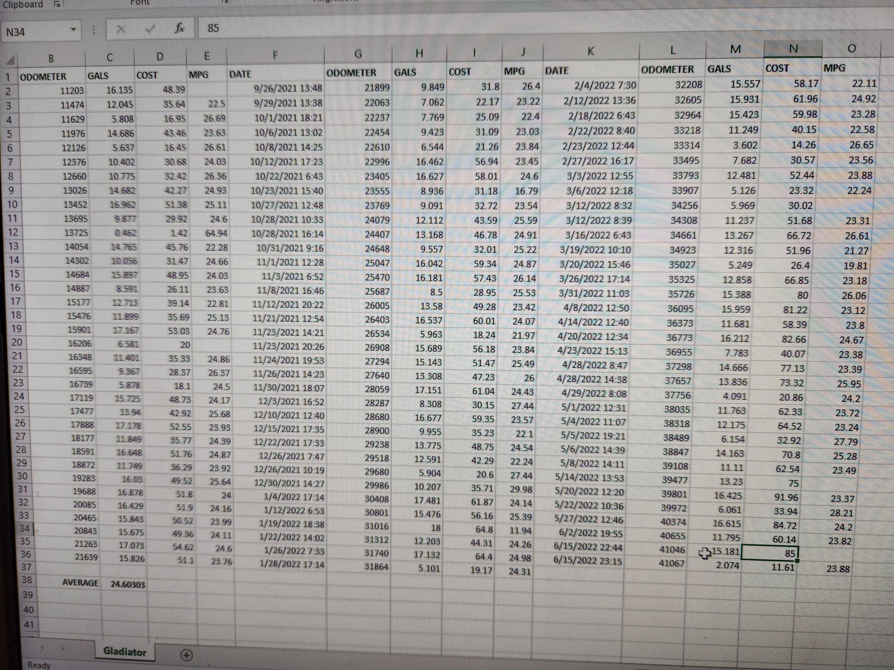

2021 Overland EcoDiesel
Culinary Operations Manager
Overland with 3.0 here. Drive about 57 miles highway during weekdays, city driving on weekends. Was using FillUp app pretty religiously to track from 9/21 to 6/22, then kind of let it slip. Imported the results to Excel, here's a screenshot, average in bottom left, 24.6 MPG. No towing, and a couple of long trips in 11/21 and 4-5/22.
