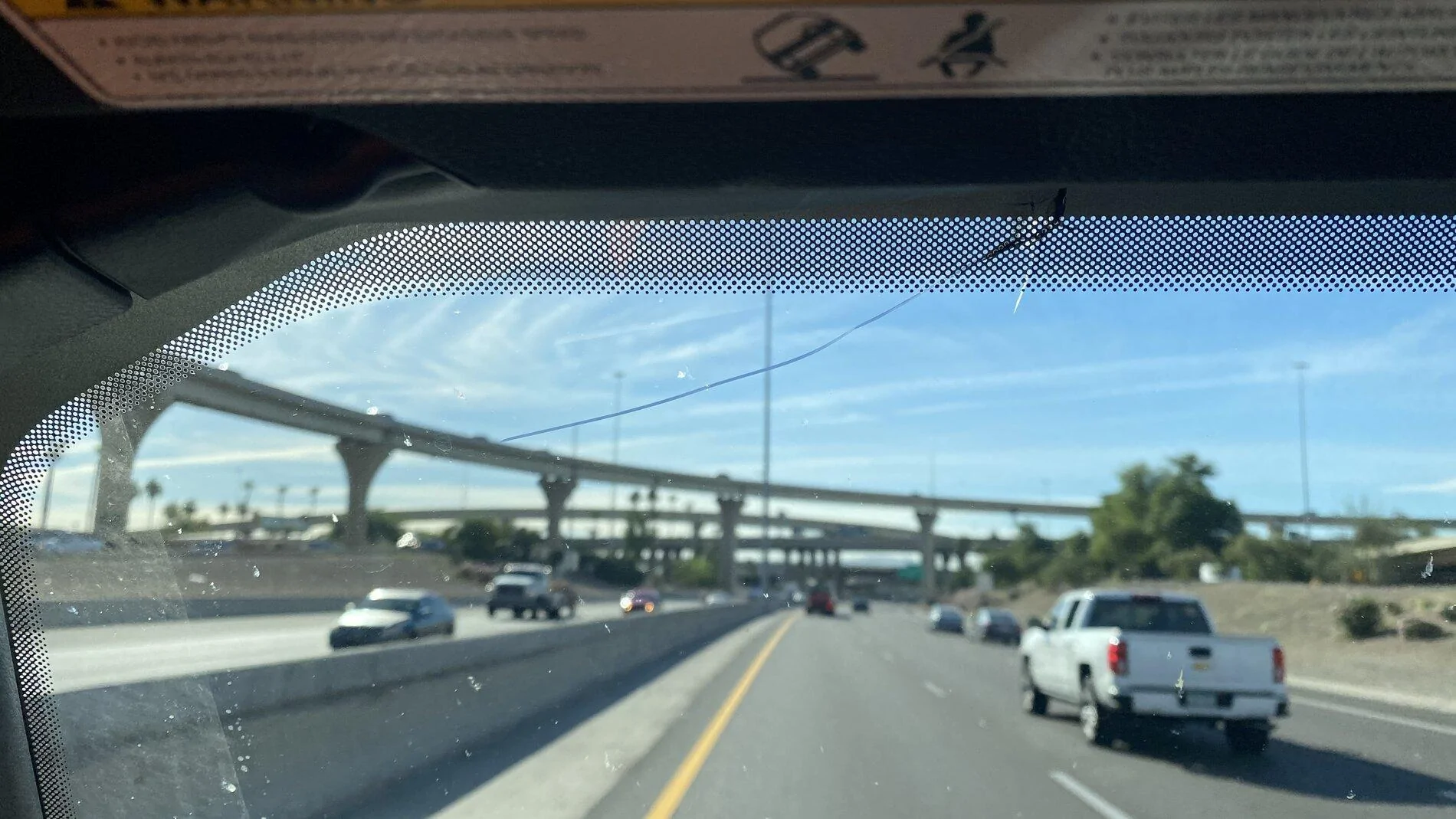

Is this too close? No. I drive a semi and go through a couple windshields a year. Phoenix is a shield killer. Sometimes the rocks come from the other side.

Tech talked to me about it as I was having my wife’s rear jk window replaced. He mentioned how the pieces, when shattered, aren’t cube-like or gravel-like, but fractal and sharp. Thinking about it, I really wouldn’t want that in my vehicle no matter how much I vacuumed.
I did get a wind deflector for the JT though, which has surprisingly helped a ton with small rocks and bugs. Wouldn’t stop a large projectile but still a great help.
I got glass in the face on my first hit! The cracks that really spread were on the inside part of the glass. It was at night so I wasn't wearing sunglasses either......
