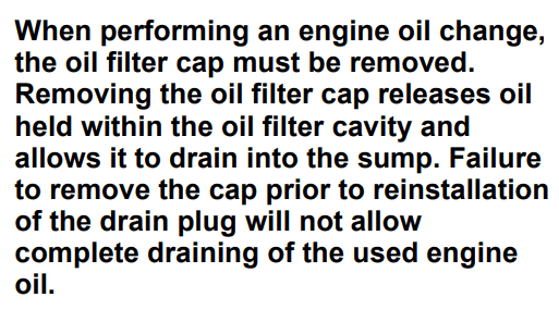

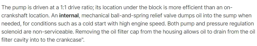

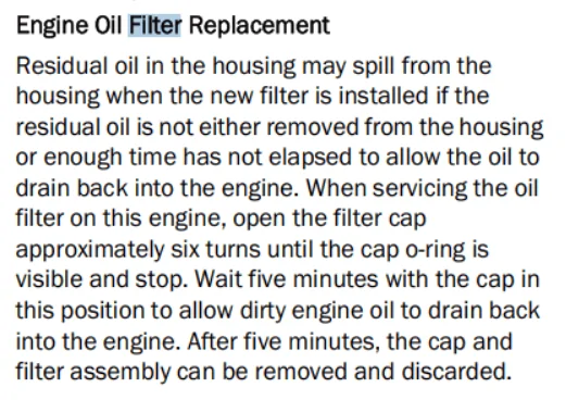

For the gasser (proving there's no drainback on shutdown)- the first is a technical document explanation, proving oi is held in the filter cavity until you pull that cap -

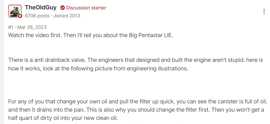

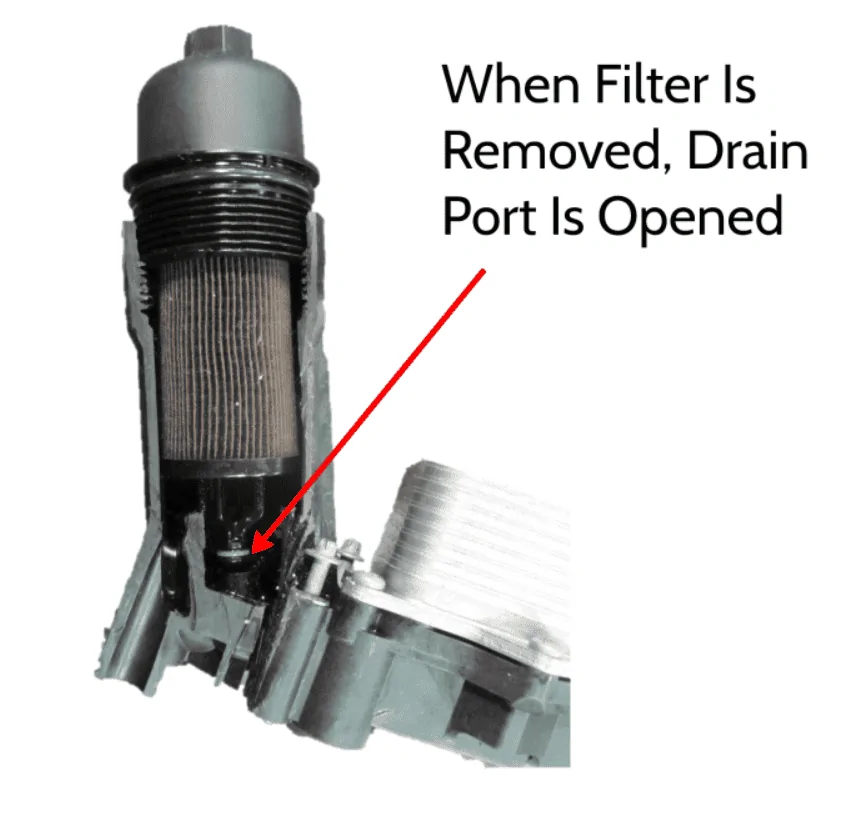

There are engineering drawings out there showing these don't drain back on shutdown.
The reason people are tricked into thinking they do is marketing hype, and the fact that once you pull that cap, the oil does drain back.

Simply put, there is not an anti-drain back valve in the 3.6 or in its filter.
Show me a picture of the anti-drain back valve or find one in a parts diagram or parts list and I will be happy to eat crow and retract those words.

I've already posted FCA tech info talking about how when you remove the cap, it releases oil from the filter housing, and another where it says to remove the cap first to allow oil to drain from the filter housing.
