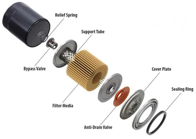

If my understanding of physics is correct that air pocket at the top of the oil filter housing (the cap) will be compressed. Compressed air over the oil will be force the oil out of the oil filter housing. This is the reason the filter doesn't have lots of oil on it when it's removed after sitting overnight. A very small air bleeder orfice with a check valve an a oil drain line going into the cam cover would eliminate this condition.
Just my two cents. :rock:
If what you are saying is true then all vertical filters would not completely fill including the factory filter.
There is a bypass valve at the top of the filter that would bleed off any air.
When ever I change my oil filter on my two Wrangler with the Baxter you must do the filter drain procedure and if you don't all the oil in the filter will spill out every where. That's because of the anti drain valve in the filter and the anti drain back valve in the Baxter.

Back in the good old days spin on oil filters were mounted low on the engine block in a vertical position. Some were at a 45 ° angle against the engine block. The engineers knew if they mounted that oil filter threads down there would be an air pocket in the top of the filter that would not allow the oil to fill the chamber completely. We all know that the 3.6 Chrysler oil filter is not dripping oil if you let it sit overnight before you remove the filter. The oil isn't completely filling the oil filter chamber. If you turn off the engine and then remove the oil filter you'll notice the liquid oil isn't completely covering all of the filter media. The Engineers put bleeders on cooling systems to get the air out so it is completely filled with liquid coolant. The same thing happens in that oil filter chamber. The Mazda RX7 back in the '80s had a extended tube that forced the oil to the very end of the oil filter media. It was mounted what we would call upside down, like the 3.6 L is mounted. If you remember the original version of the oil filter on the earlier 3.6 l engines added a vertical tube up into the center of the filter media. Without a bleeder to purge the air out of the cap you have pressurized air which just like and accumulator cylinder when the oil pressure drops so does the level of oil in the chamber.

Has anyone with the spin on oil filter adapter removed the oil filter after the engine sat overnight to see if the oil spills out or has drained back overnight like many have said they've witnessed with the original oil filtration design?
Lycoming 0-235 is a wet sump or a dry sump?
Hootbro
Apr 13, 2019
10,212
20,020
2025 Gladiator Sport
Good way to make a mess to prove/disprove a hunch. If buying a recommended size quality oil filter, the ADBV should be keeping all or most of the oil retained.
My setup, I have to add a 1/2 quart of oil to account for the filter and have check my old levels multiple times in the morning after a cold sit and the oil level is fine and never rises. That tells me the oil is being retained in the oil filter.

I have seen oil spill out of the oil filter on my Baxter only when I don't do the procedure that empty's the spin on filter long enough.
So unlike the factory filter the Baxter is full of oil.
