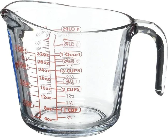

What if the oil containers were wrong, and didn’t really contain the amount advertised. You might have uncovered a conspiracy by the oil companies to make more money by selling less oil. I think we need to start measuring the oil from the jugs before pouring it in our Jeeps.
(I’m joking, you probably don’t actually need to do this...maybe)
