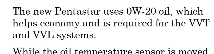

If you change oil viscosity by much you can make this a lot worse. you can also make the transition between valve lift stages rattle because the oil isn't flowing fast enough. Flow rate matters with these. There's a high volume pump for a reason.
Jeep Gladiator Hmm, this is an interesting solution. No More Dry Starts 1723313148925-7n

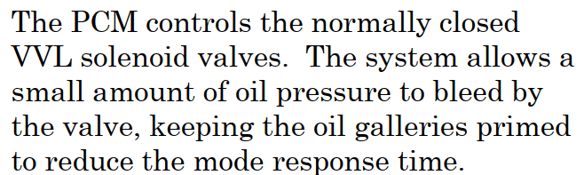

When you start these engines, the oil pump is in high volume mode - oil pressure builds FAST. It jumps up to about 70 psi within a couple of seconds, then drops back to low volume mode. It does this to fill everything near instantly upon startup (cold or hot start)
Running heavy oil and cold temps may make the owner/driver feel good, but really does the engine no favors (and so far no one has any proof it's helping anything but make them feel better.
