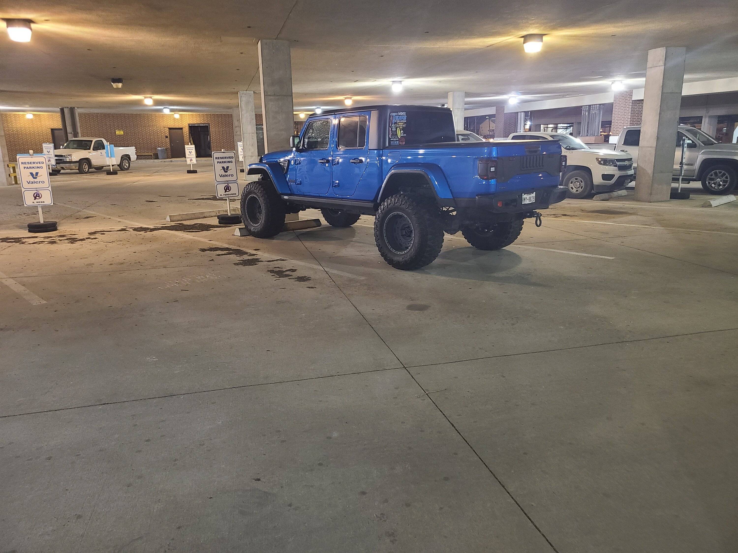

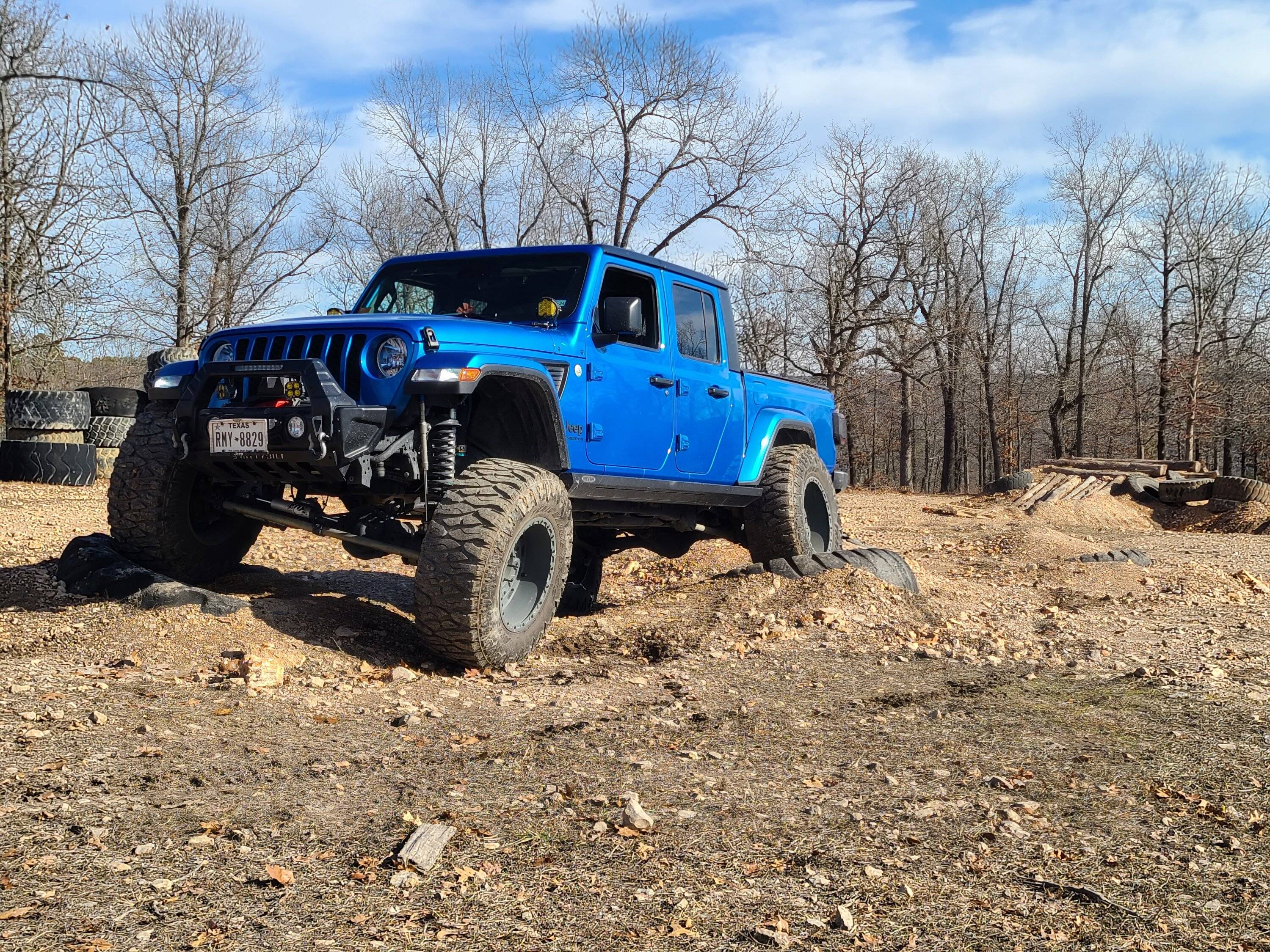

The lift kit is not complete. You need some adjustable control arms to adjust your caster and adjustable track bars to center your axles. Front and rear track bar relocation brackets will eliminate your bump steer. The wheels and tires definitely push the steering/suspension to its limits but if you finish the lift you'll be in much better shape. Then after you get all of that complete the first component that will likely wear out will be your ball joints...so if you pay someone to install all of these parts then I'd go ahead and take care of the ball joints. I'm running a 6.5" lift with 40x14.50r20 on 12" wide, -44 offset wheels. I have 26k miles and have had this setup since 3k. No issues yet but I can tell my ball joints are getting ready to go.
