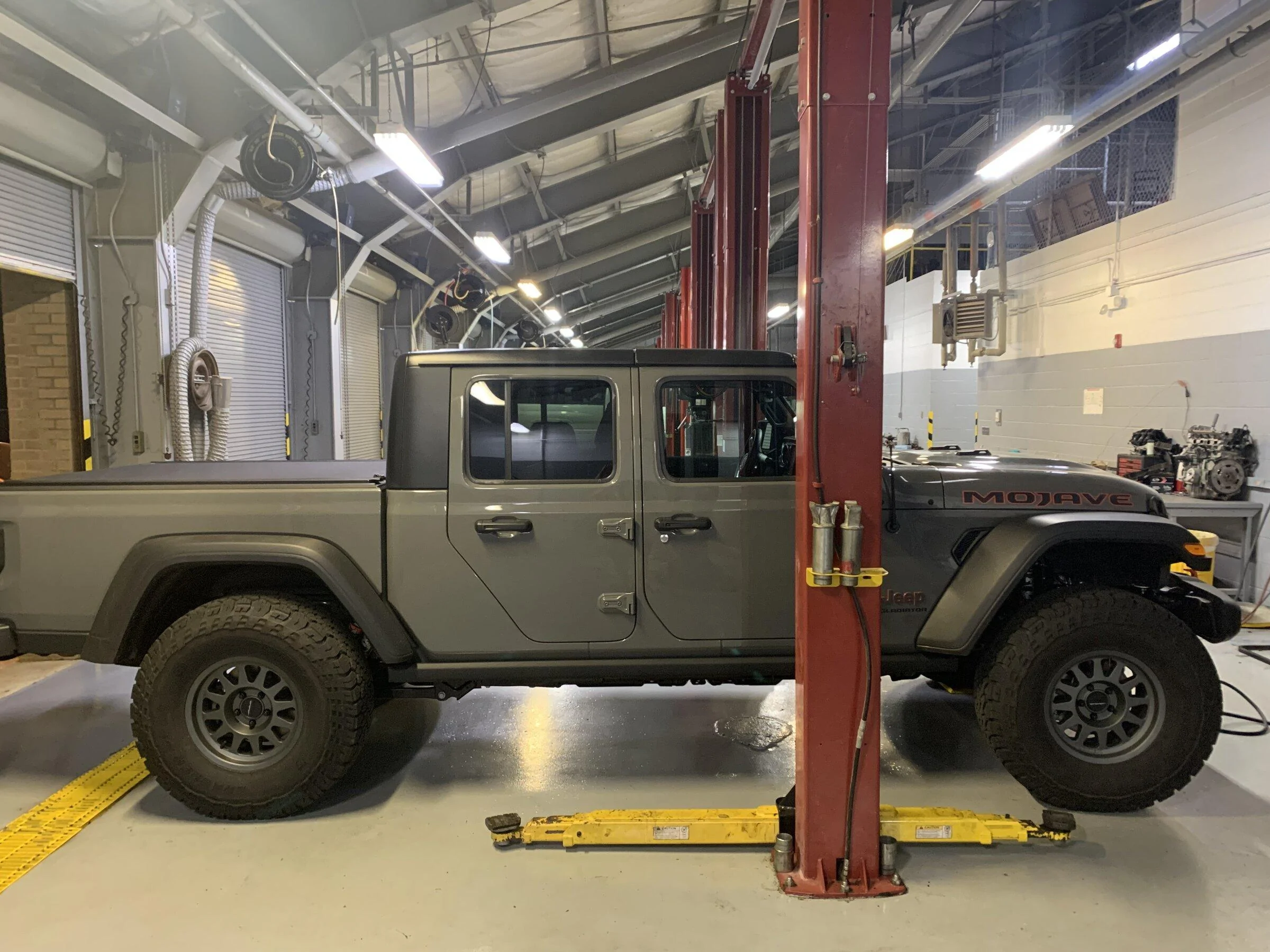

Here’s my 2¢ after installing the AEV lift with Geo brackets.
the truck does NOT need 2” of lift to comfortably fit 35s. Here is my truck flexed on 37s, before the lift went on. Unless you’re crawling, 35s all day on a Mojave. The 2” is just icing on the cake.

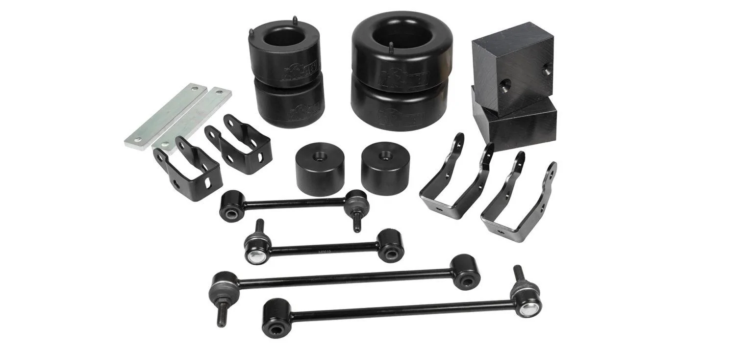

if you want to do the 2” lift, AEV is your one-stop shop for everything you need, great kit that I installed myself. Here the kicker though: NOTHING about the AEV kit is really all that special. Except maybe the geo brackets. The kit without brackets is 4 things for the front and rear: A 2 inch coil spacer. A 2 inch shock extension. 2 inch bump stop pads. And 2 inch longer sway bar end links.
Every one of these things you can get from any other manufacturer. 2 inch coil spacers and 2 inch bump stops are not hard to come by, they are just hunks if plastic or rubber, depending on the manufacturer. They are not specific to the Mojave. Several companies also make sway bar end links that are threaded and adjustable by cutting to necessary length, or just a set extension length.
There is actually nothing too special about the shock extension either. The only difference between a shock extension for the Rubicon or any other trim, is that the lower bolt is thicker on the Mojave than the lower bolt on the other trims. So the bolt hole on the bracket, for a shock extension that works on any other trim, is just a little too narrow. This can easily be fixed by drilling it out to size and painting it rust proof. Epic Adventure Outfitters did this with their Mojave. Check out their YouTube channel. AEV shock extensions are specifically made for the Mojave so you don’t need to enlarge the hole, but it’s not hard to do.
All you really need to mimic the AEV lift are those 4 components for all 4 corners and you have the same thing that AEV packages up neatly. If you can’t wait for the back order and need your lift ASAP, a Frankenlift doing what I just described is a perfectly viable option, that doesn't mess with the suspension. Adding the Geo correction brackets would just tie it all together by dropping those CAs down 2 inches each, and essentially you’re back to factory suspension angles everywhere.

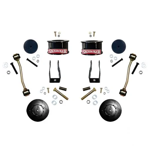

AEV (since 1997) makes amazing products, but Skyjacker (since 1974) has been around a hell of a lot longer. Both kits are spacer kits so you retain the OEM springs. I’ve never bought from either company but I would never dismiss Skyjacker as not worthy. FWIW, you don’t need a lift to fit 35’s. Mount them up and get the lift you want later. That’s my plan.
AEV kit
Skyjacker kit-
Pretty much just echoes what I said above. That kit has the exact same components - coil spacer, bump stop spacer, shock extension, longer sway bar end link. Although, it looks like those are just components for the front end? So this would be more of a 2” left, or just a front lift? I only see a pair of everything - shock extension brackets, coil spacers, bump stop spacers, and end links. I installed my Mojave lift over a few days and did just the front first. It was definitely nose high with a 2” lift up front only.
