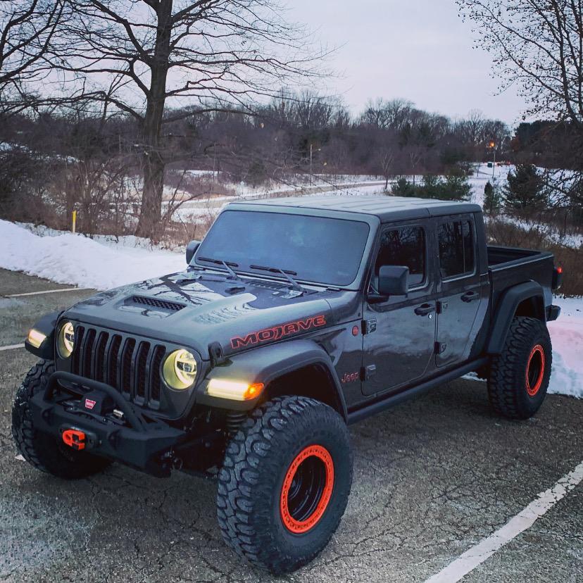

What’s the consensus on ReadyLift? I am about 94% sold on the AEV 2” spacer lift… but always window shopping.
https://www.readylift.com/jt-gladiator-mojave-4-terrain-flex-max.html
I’ve seen this lift up close…. yes it’s cheap but you get what you pay for…. and 37s look small.
There’s a Mojave by me at a dealer with this lift on it. I called a local shop to me and they installed the lift. They said guy wasn’t happy with ride and didn’t want to spend more money to fix it. ??? Perfect example of someone not knowing what they bought and wanting it to be something it’s not lol. So many better options then this lift…but at a cost…
$1,300 is cheap for just 4 springs, control arms and a track bar? ?‍? lol I went and looked and Clayton is $2,500-$3,200 for the 3.5” lift. Holy cow. ?
