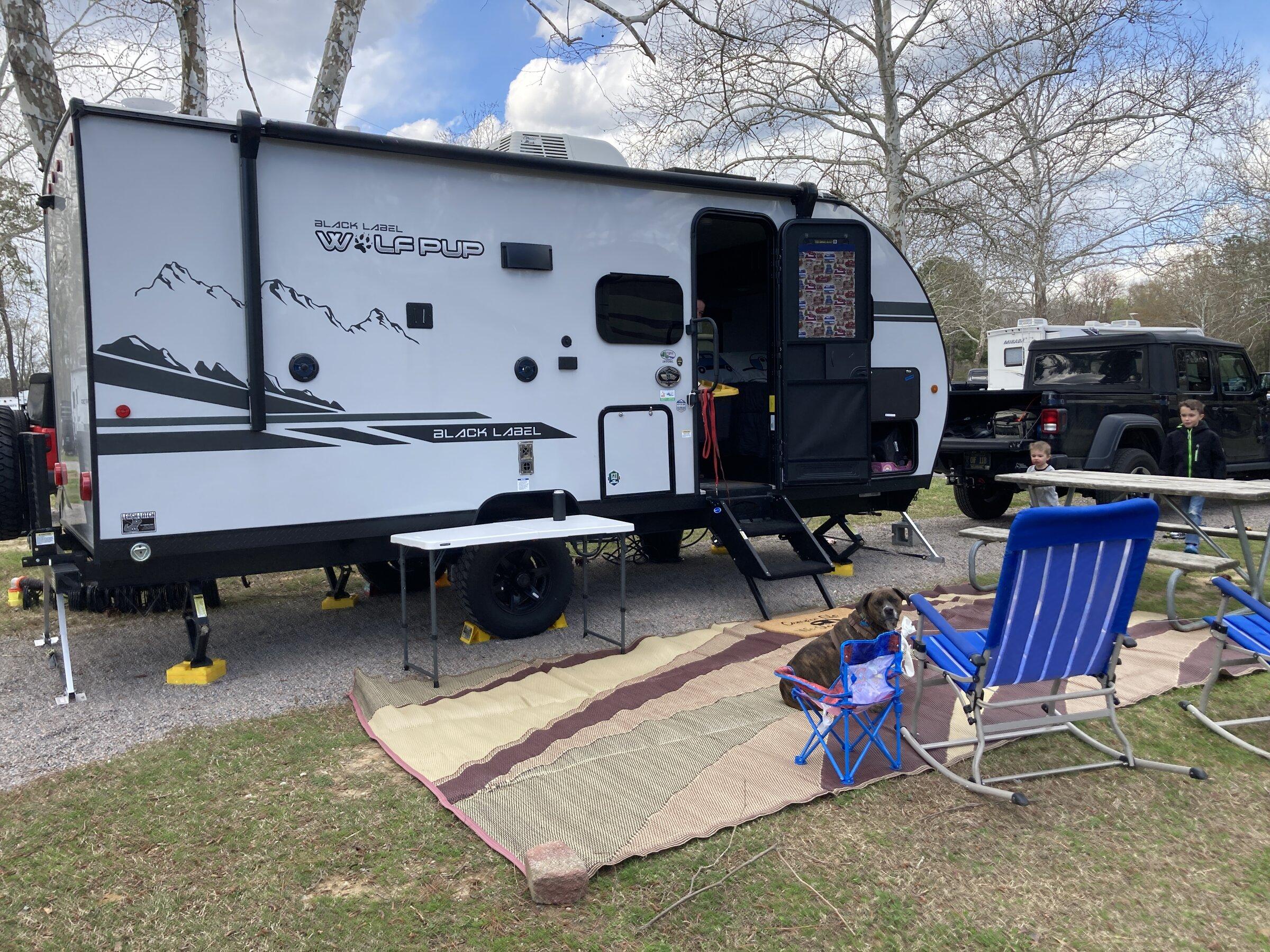

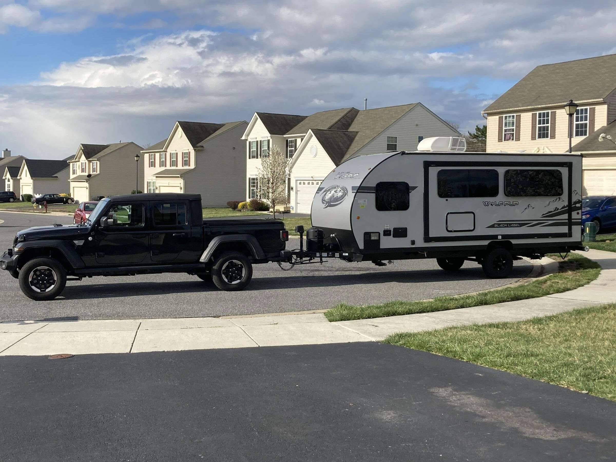

I wouldn’t have any other model than an MT. The payload and the tow capacity make a massive difference. And just knowing i have wiggle room when loading for camping, and not NEEDING to doing the math, is worth the cost.
not to mention the added benefits of the 4:10 w/o all the off road stuff I wouldn’t need or use.

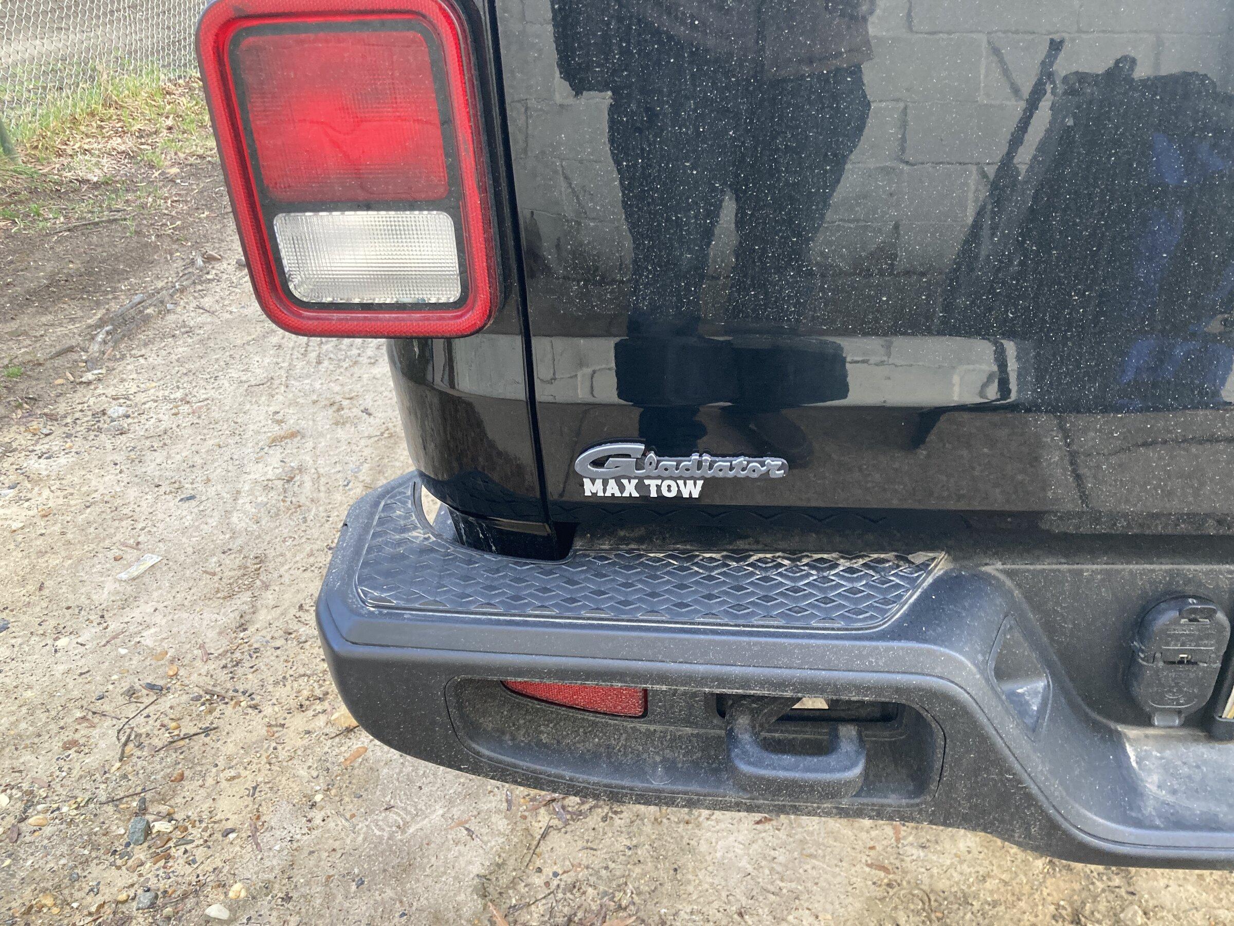

Laughy emoji for that badging. Love it
