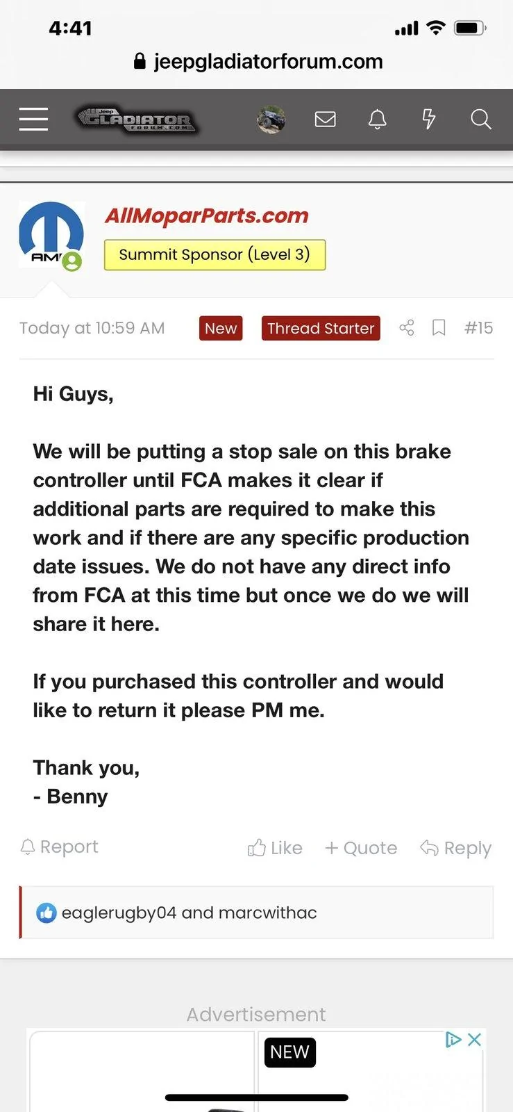

Not sure if anyone saw this post yet. I purchased mine from them and I am returning it.

Clear??? Some work, some don't , mine works fine, allmoparparts is stopping sales basically due to posts on this forum, I had alerted Benny to all the threads......Jack
