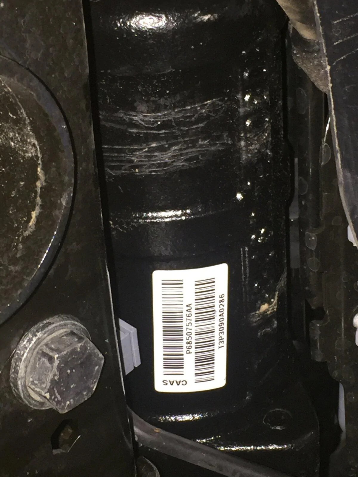

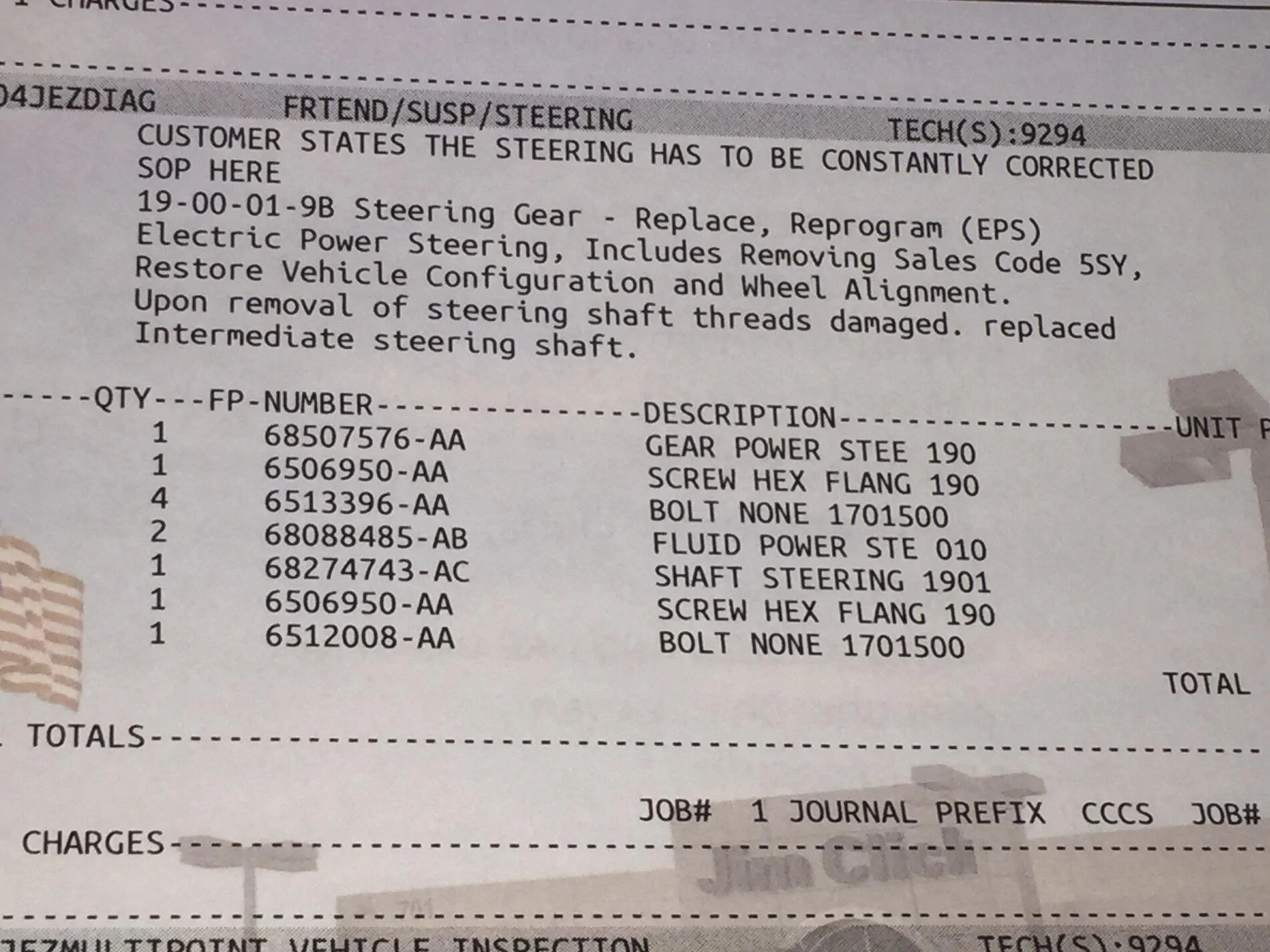

... they called on Friday and my steering box will be replaced tomorrow, exactly 2 weeks after approving it. .... Will update after driving for a while.
It took two days, but they got her done. They called near the end of day 1 and said a bolt into the steering shaft had been cross-threaded at the factory, so they wanted to replace that shaft and they needed a day to get that part in. I appreciate that they didn't just jam another bolt in the effed up threads and pass it off that way, so I was fine with the extra time it took.
Haven't had it on the highway at speed yet, but found a suitable stretch of road that convinced me it is noticably improved. :)
Jeep Gladiator New JT Gladiator Steering Issue TSB 08-074-20 (for "Improved Steering Feel") IMG_7035
Jeep Gladiator New JT Gladiator Steering Issue TSB 08-074-20 (for "Improved Steering Feel") IMG_7036
