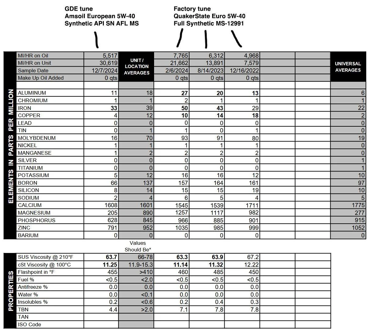

Some improvements. Hard to know which was doing more heavy lifting, the GDE tune or the oil, but based on what I've read over on the Ram forums (and here- I can't remember what I've read where but it's been a lot) I think it's more likely the oil is the bigger contributor to the improvements. Usually you wouldn't change two things at once but I didn't like how this was going. There's a gap between the third and forth report where I made the changes and did a shorter interval oil run and didn't send the results off. So these results are all fully on their labeled tunes and oil. No transition period.
Jeep Gladiator Official EcoDiesel Oil and Filter Recommendations oil testing

Thanks for posting up!
Thanks for posting up! Add 20% to this number as Crapstone is off due to non ISO testing and calibration. They want to make max money and not focus on pesky costly and time consuming calibration.
The right tune can lower aluminum. That has been shown to be related to the post combustion fueling to keep the heat up in the DPF and SCR systems. Looks like GDE has done some changes to improve this and I heard they might be doing more and release updates.
The iron though 33ppm or 40ppm corrected. Still a little high and you have Amsoil MS so it should be better. You need to use a another lab so we can see true fuel dilution. Is the Iron wear from what?? We don't know with crapstone.
