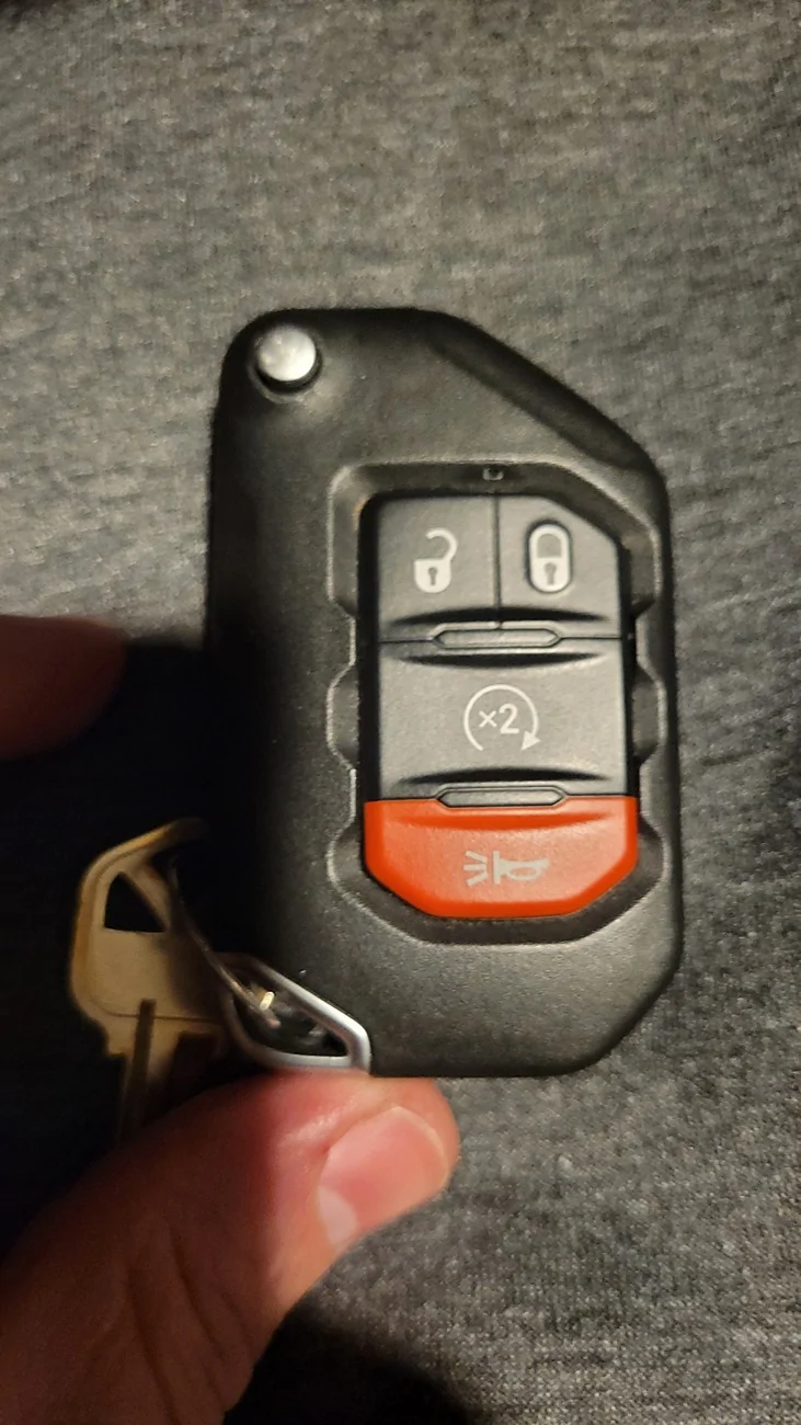

The other thing I’m having trouble with is remote start with the key fob. Today was the first time I’ve tried but I can’t get it to operate. Everything I’ve read and seen says it works almost exactly like it does on the gas model. 1 push on the lock button and two on the start button. I’ve also seen that it could be 1 for lock then two start while holding down the button on the second push. Neither of those nor anything else I’ve tried will start the Jeep. I believe all the conditions are met to allow remote start. The only thing that is close is the fuel level. I’m above a quarter tank but less than half, gauge shows approx 3/8 tank. One thing I have not yet done is to check fuses. Before leaving Delaware I pushed them all down, several moved, but I didn’t check to make sure they were all good. The other thing I’m curious about is how good the batteries are. Last weekend I drove approx 400 miles before charging came down below 14 volts. The batteries in my 3.6 are only a year old and much higher quality than the factory battery still in the diesel. I’ll make sure they are compatible first but if so I’ll swap them tomorrow and see if that does anything for remote start.
You don't need to lock the Jeep. Just 2 pushes on the start button, x2.

Just regular pushes, not to fast or slow and you don't need to hold it down.
Or atleast that's how it works on our diesels and the inlaws also.
If you have a service light on, or low on fuel, somewhere around 1/4 tank, or if your low enough on DEF to have received a mileage warning.
If the batteries are low, it could make a difference. The batteries are the same. Some diesel owners have claimed they had an H7 as the main instead of an H6.
I swapped my H6 out for an H7 when it was time for a replacement. Also the Aux battery is under the main on the diesel, super easy to swap.
11,476
30,571
Yep....just 2 presses of the remote start button.
Make sure all your doors, hood, and tail gate are closed. A low battery will not let the remote start to work.

I’ve tried the remote every way possible including just 2 presses but it doesn’t try to start. On my 3.6 the horn goes off twice then it fires up. On this one I’ll get one horn but nothing else. It feels like one of the conditions needed for remote start is missing but I can’t figure which it is.
The batteries are where I’ll start tomorrow. They are original so a little over 3 years old. I’ll pull the batteries out of the 22 and see if that makes a difference. I’m planning to do that before selling it anyway.
I replaced the battery in both remotes this afternoon so that isn’t it.
No check engine light and JScan only shows two stored codes. Three instances of U0184-00 (lost communication with radio), and one of B16B7-15 (center stop lamp short to battery or open)
Doors, hood and tailgate are all shut. I have noticed the hood switch closest to drivers side is slower to fully extend that the other one but it does top out.
Something I have not checked is the wiring harnesses for the doors. If the previous owner bent a pin plugging them back in, that might do it
I get 2 horn honks just before it starts. Check the battery voltage first thing in the morning before starting. Check each one separately.

I should have opened the forum first and checked the voltage when I got up. Instead I connected the charger a couple of hours ago to see if that helps. I'll give it a little longer and see what happens. If it still won't remote start I'll see if the codes will clear. If it still doesn't, I'll look for bent pins in the door harnesses. From what I've seen here, a bent pin can cause all types of strange problems. I really feel like this is something simple just have to find it

I've looked at the EVIC sceen and it shows no problems. Start stop works fine when I forget to hit the button, no obvious problems anywhere. I just took the Jeep off the charger and it still won't remote start. I've got to go in to work this morning and will check the door harnesses when i get time. If they look good I'll check the plunger switches under the hood then swap in the newer batteries from the 2022 gasser.
