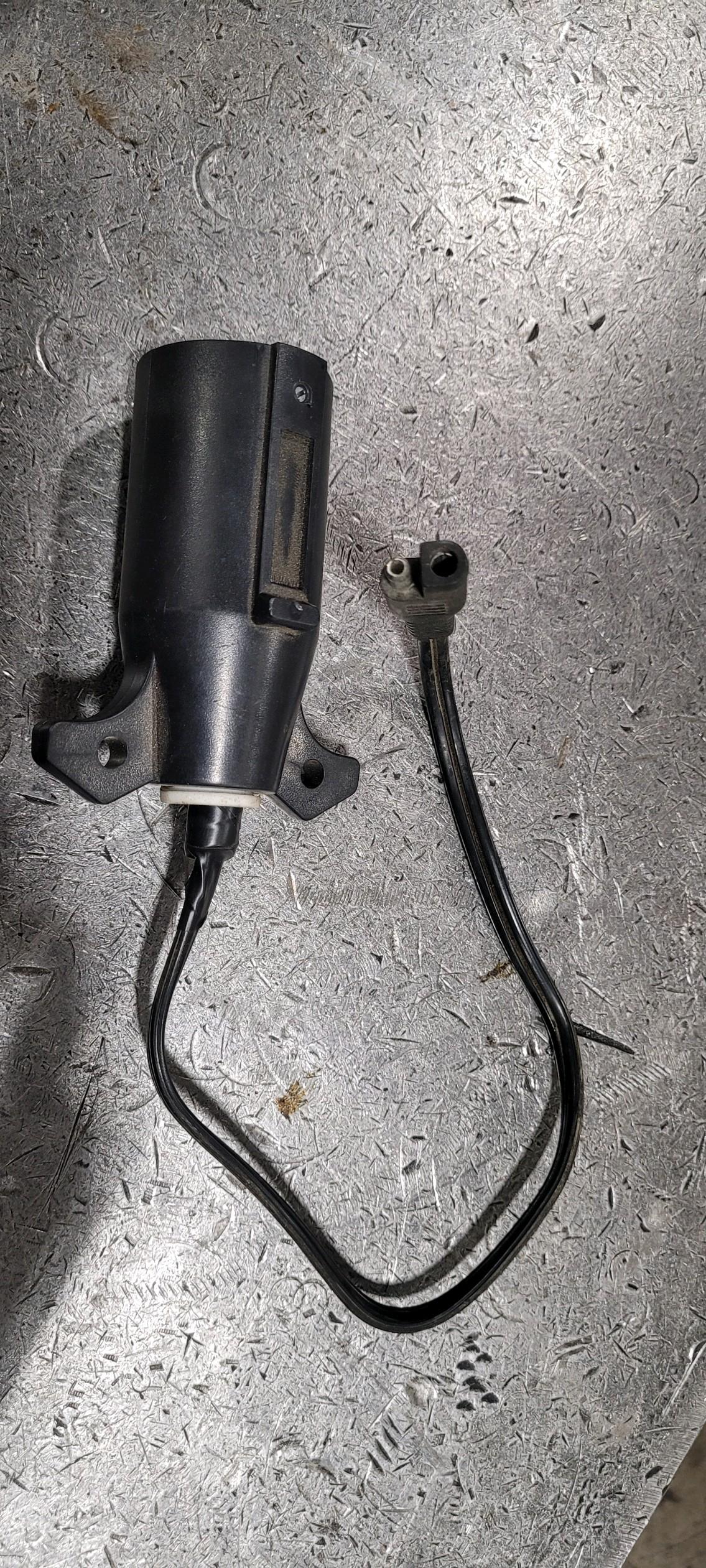

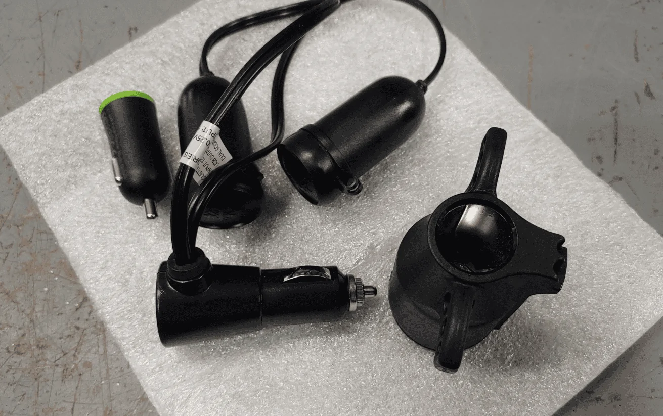

Yes, that's even better. Allows you to use your float/trickle charger with the ends it came with at other times.
I do that sort of thing as well - it's one reason I have tubs full of wiring bits and a couple of cases with various terminals and fittings.
And with these in my truck at all times, I can hook almost anything to anything - the one adapts the trailer plug to a 12v, another plugs into a 12v and give you two 12v outlets plus built-in USB charger........
I could run 4 things that plug into 12v outlets at one time if I needed to with my bed mounted 12v outlet, the trailer plug and these adapters, and the 12v outlet in the cab.
Same thing for me.....I have a bag of adapters SAE, Cig lighter, Andersen, etc..... This way I can charge w/ tender, solar, cooler in the bed, HAM radio......

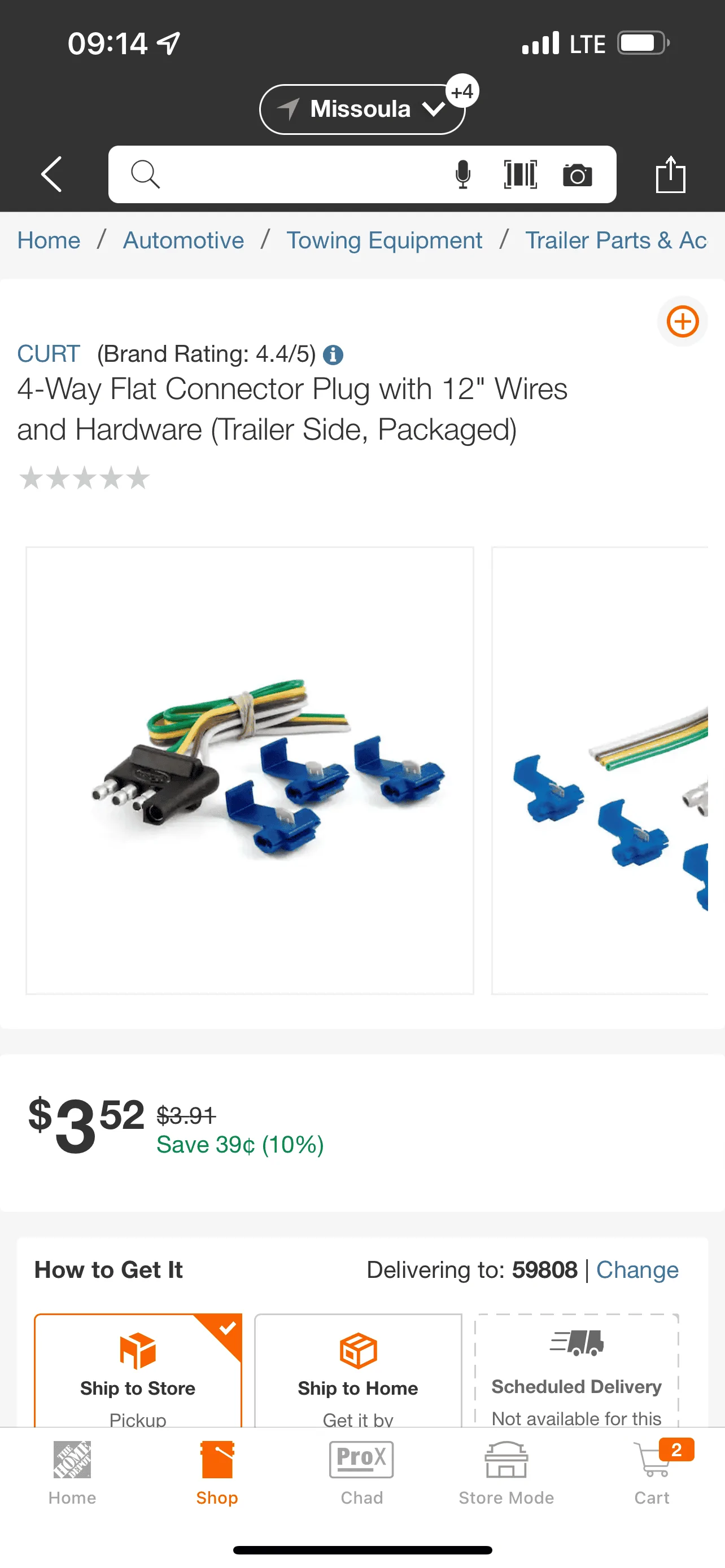

No to the flat 4-way.
The 4 way flat plug only has
ground,
left turn,
right turn
tail
- not power.
Buy a cord end from Amazon.
Wire this onto the charger's battery ends -
https://www.amazon.com/gp/product/B07HVS1SY3
You can also get this to turn that trailer plug into a 12v outlet -
https://www.amazon.com/gp/product/B002UC8U7G
That way I can plug any 12v accessory into it.

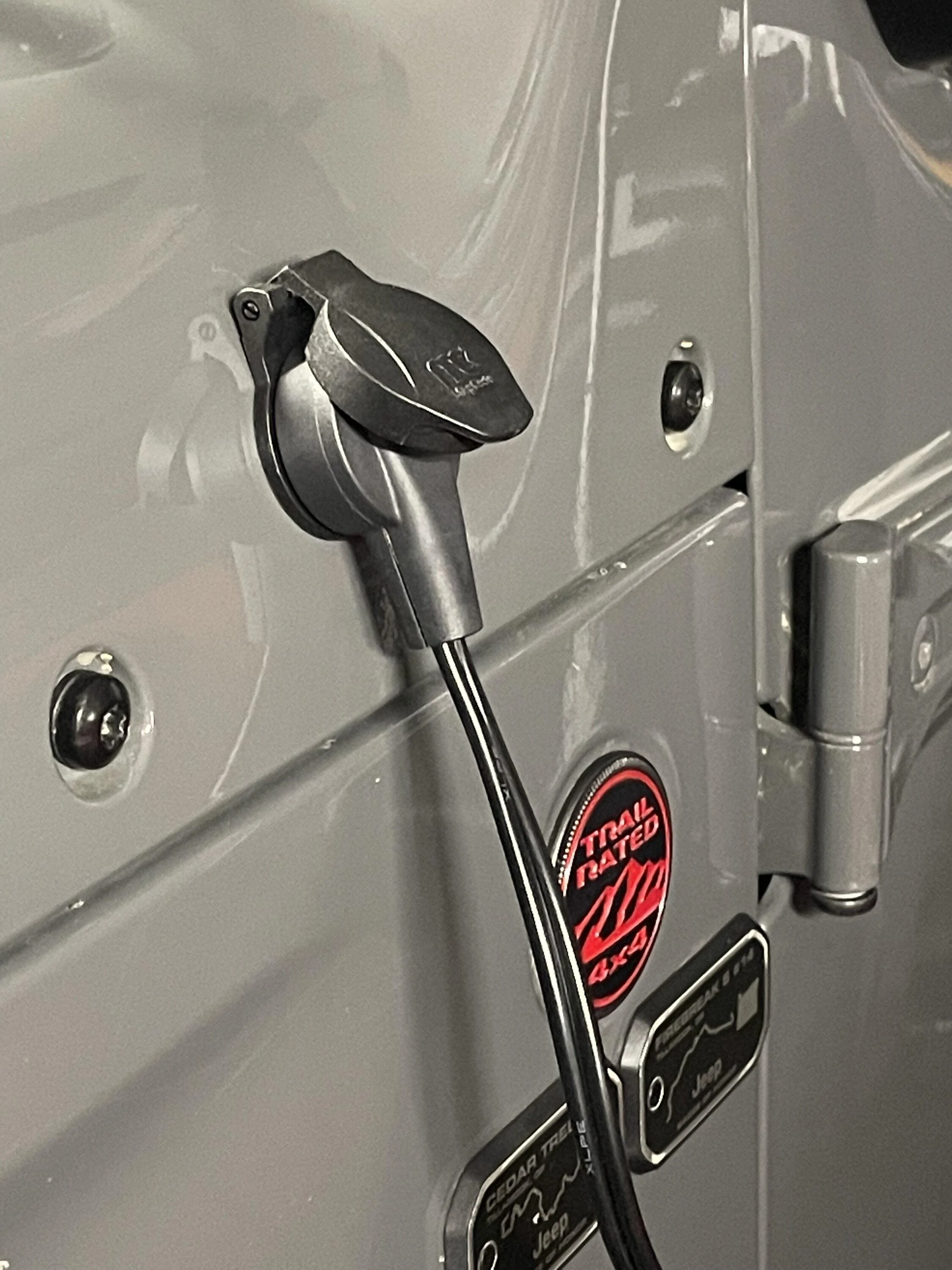

I hooked up a MagCode magnetic connector with a Battery Tender charger. Simple low amperage fuse (5A). Small hole in the plastic cowl and it looks pretty clean and cheap enough to replace if I had to.
This is the kind of ingenuity I love to see here.

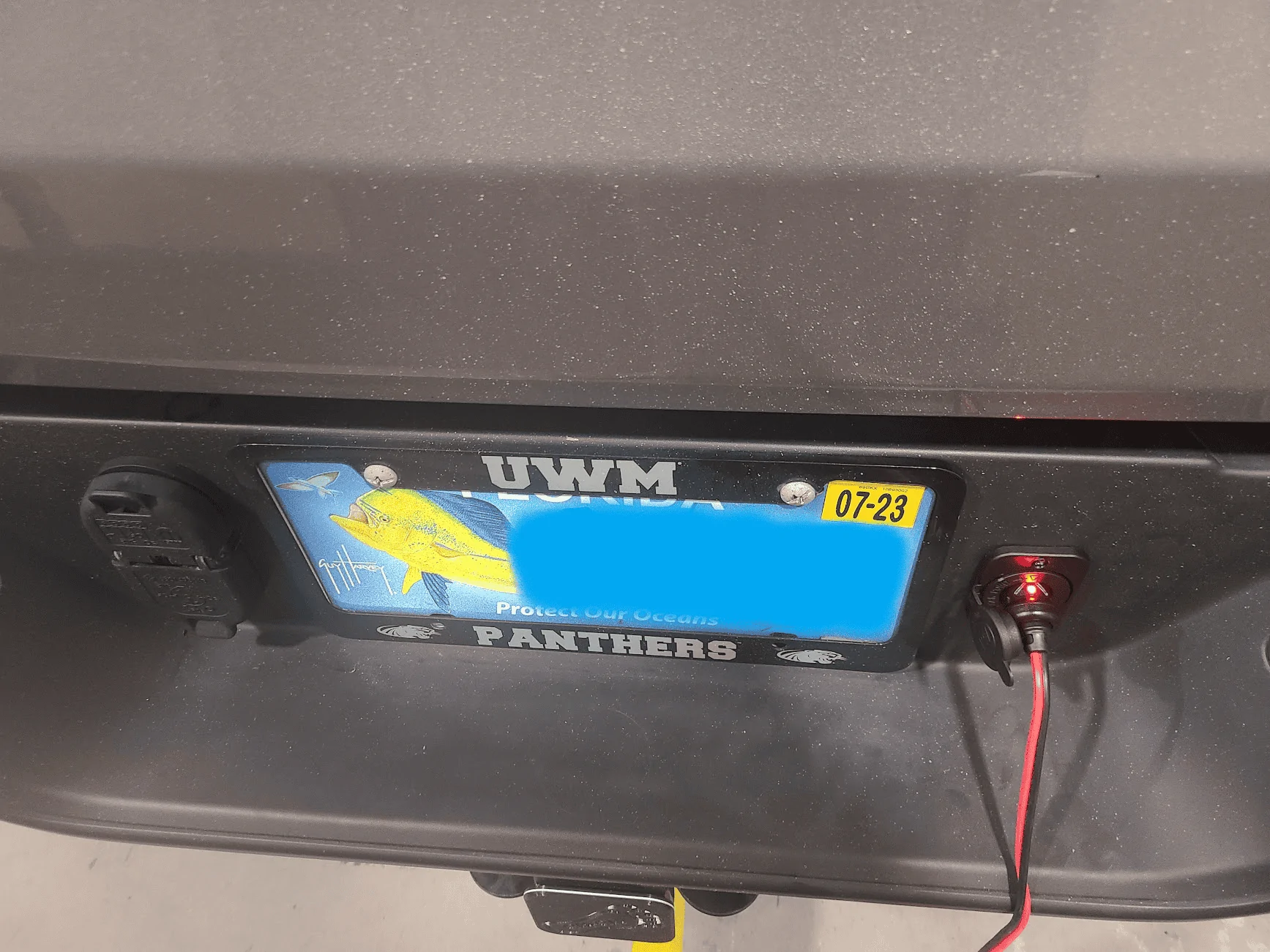

If you like the idea of connecting to the trailer plug leads, but want something easier to break away from (and also use to power devices out on the road), take a look at what I did here. It's a marine 12v outlet thats tapped into the hot wiring for the trailer connector. Works great to maintain a charge, but also works great to power other things if you need to. I've used this socket to power campsite equipment or chargers as well as using it to maintain the battery at home.
I do like the 7-pin to 12v adapters like @ShadowsPapa mentioned, I just don't like how big they are and that they clip in (important if you worry about accidentally driving off without unhooking it). Just the socket instead is pretty clean and will pop right out if you drive away. Bonus points for not having to keep an adapter on-hand.
https://www.jeepgladiatorforum.com/forum/threads/trickle-charger-through-7-pin-connector.62522/
https://www.amazon.com/gp/product/B082D8WKNW
Jeep Gladiator Permanent mount battery tender 1666182098702
