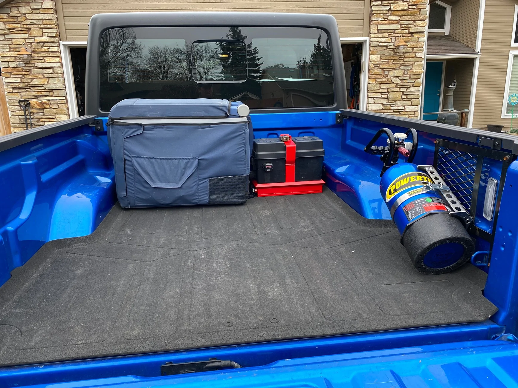

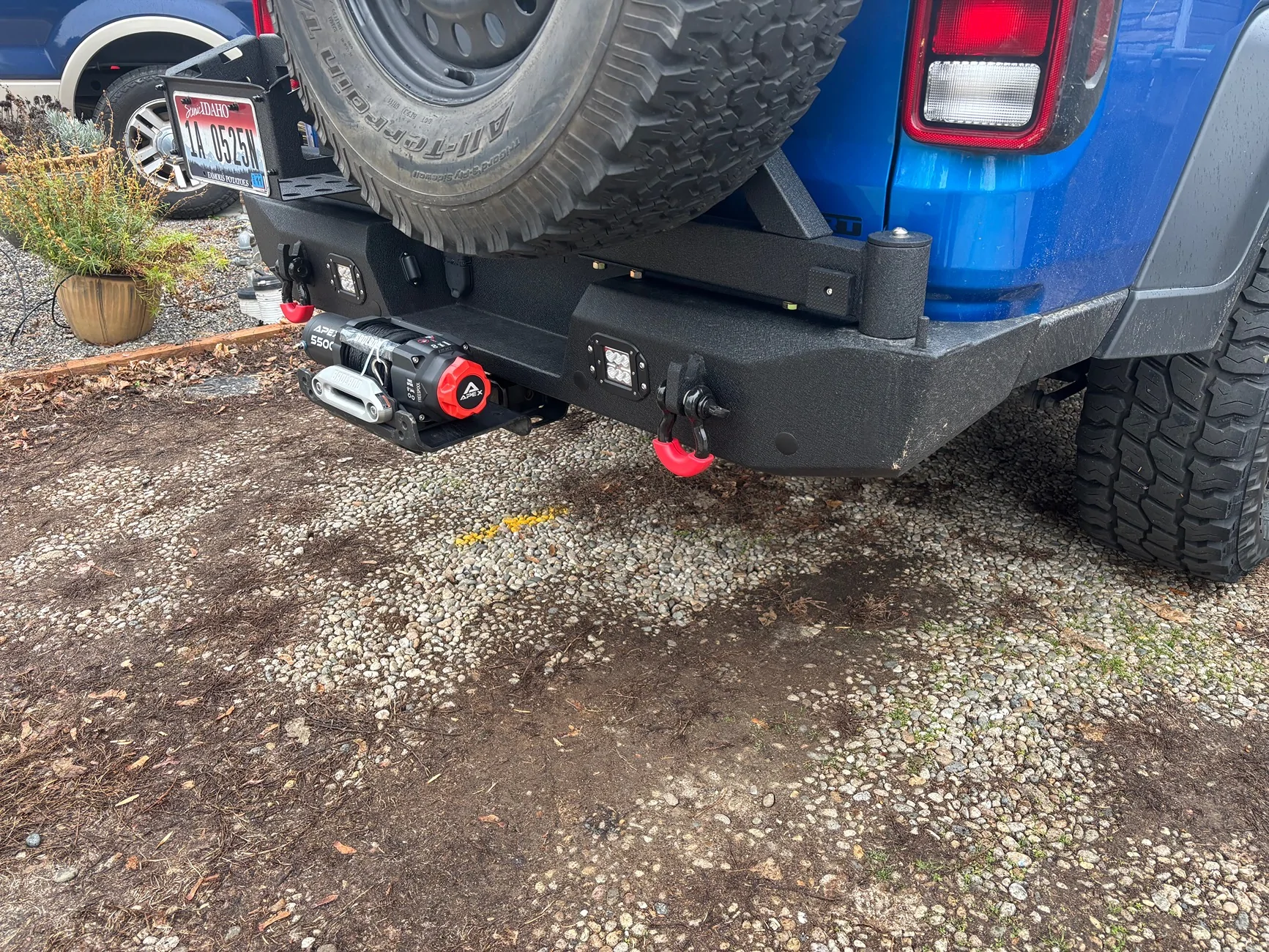

I’m right in the middle of the same project (kind of). Ramsey 8k mounted on front winch bumper(traditional style). Wanted a winch out back, for extraction if necessary.
Some things to consider:
Badland 12k is 67lbs
I have a Draw-Tite 2ā€ receiver winch plate with a solid 2ā€ connection shank. P/N 6495 (confirmed it is no longer being built). My weights about 30lbs. Vendor makes one (not a solid shank) but advertised pull rating is 15k lbs.

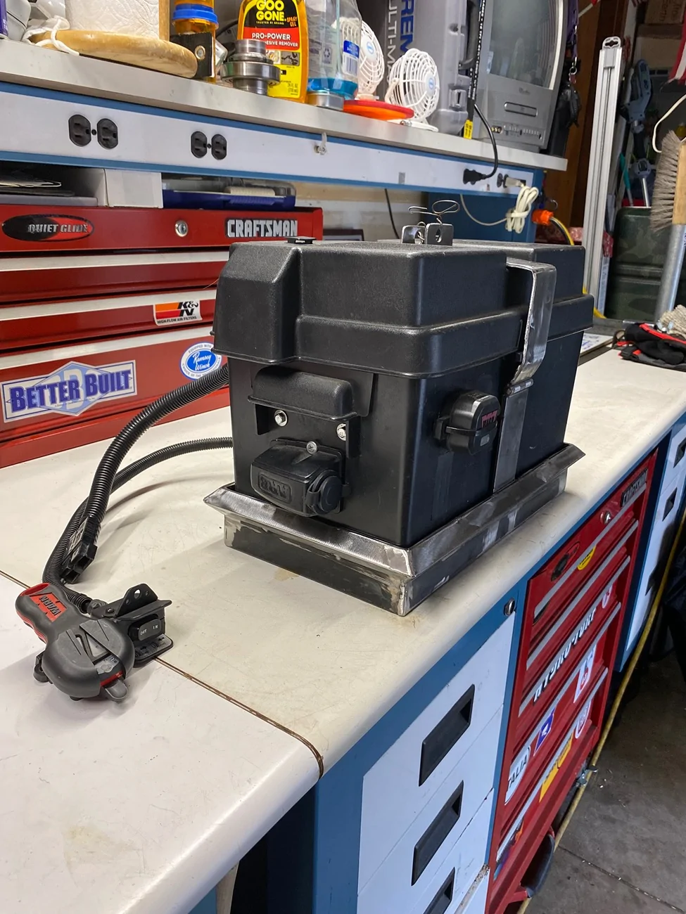

I use a house battery in the bed to power the rear winch, with Anderson connectors and a 150 amp circuit breaker and a cut off switch.
i looked at dragging 1/0 welding cable down the frame rail to power it from the JT main battery, but the house battery in the bed works great and can come with me now for my portable winch and receiver plate, for a completely out of truck winch efforts.
A few ā€œaway from truckā€œ projects with it yielded great results, but 97 lbs of winch and mounting plate and a 50 lbs of battery, got old in a hurry for an old guy.
So I’m now redoing some things with a much lighter Apex the 5500 long drum (only 37 lbs) on the rear with the same winch mount. Also removing the permanent ramsey up front, and welding a 2ā€ receiver to my front bumper, and reinstall the Ramsey on the winch receiver plate. I’m convinced that portable is better, don’t need one or both simply unplug. Pics…battery bed mount, and fit up of the new 5500 on the receiver plate.
Sorry this a windy message, but I hope it helps. Good Luck.

That's great info. The weight aspect is a concern I had, but I'm also concerned about how much you can realistically pull with the 5500. Have you used it for any kind of recovery-like situation yet?
No not yet, but a snatch block cures most of those ills if needed.
Taking it out this weekend and will give you an update.
Been thinking about your best practices question on adding the front receiver. On mine, my welding plan will be to completely over built it to combat the dynamics of extreme rope/cable angles on something it wasn’t engineered for below the current winch plate. 1/4ā€ flat bar and Sch 80 pipe full welded in every possible direction: frame horns, internal gussets, up to the existing winch plate. Full welds on everything, no stitch welds, I will also reinforce all the factory welds while I have it off for the surgery. Iā€˜m also going to reach out to a mechanical engineer friend I worked with for years to make sure I don’t miss anything. I will post up his comments as well to the project.

Instead of a rear mounted battery like Freems, spend that money on heavy wires and a 150 amp connector. Then you have a connection point that you can run other things with.
