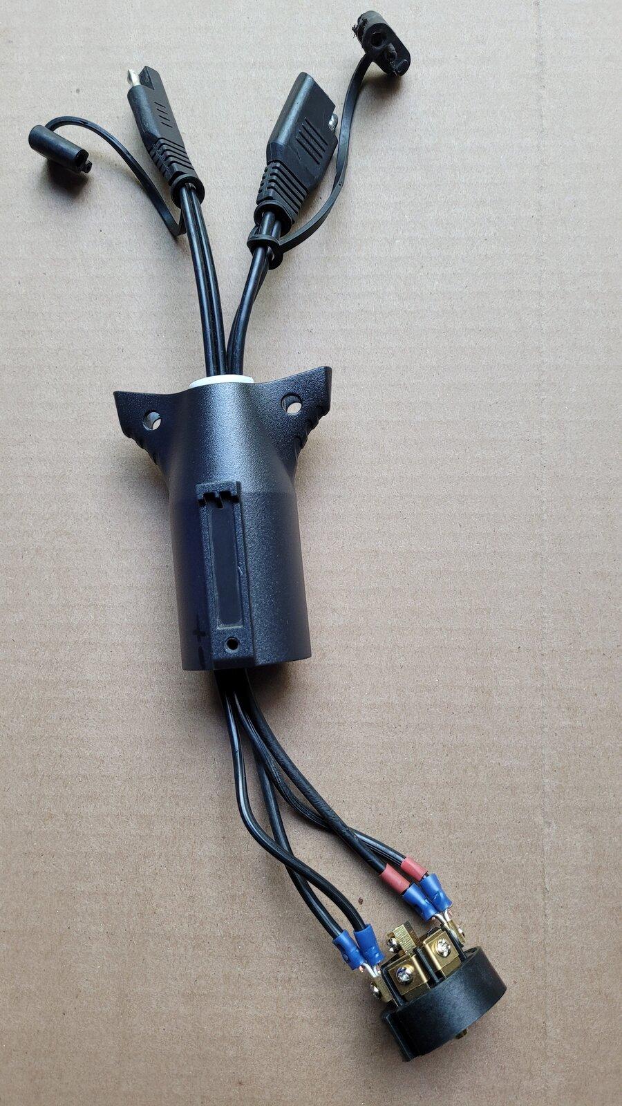

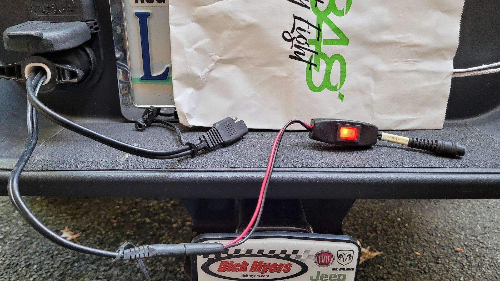

$10 @ Home Depot + 2 SAE connectors I already had = 2 12v sources from the 7 pin trailer connector. This connection is always hot, not switched by the ignition as I originally thought.
