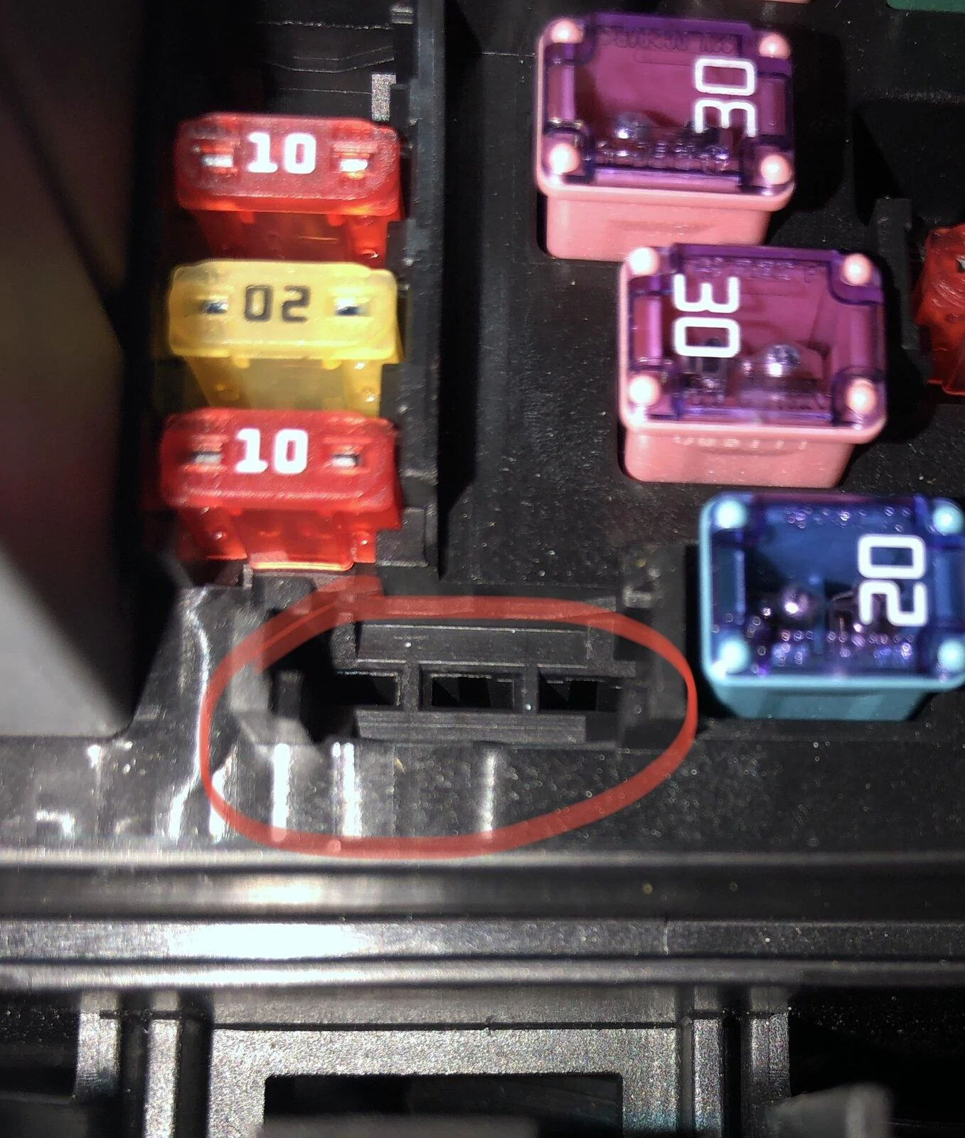

Ok. I got the Tazer and was able to enable the bed outlet with the help of ZAutomotive. New issue is it’s fused, which the dealer didn’t mention, and there’s no connectors in F43 and F45 for the fuse unless you have it from the factory! ZAutomotive is going to look at the schematics and see if there is a work around. Can someone with a bed outlet verify they have a fuse on this location?

There’s a new firmware version that includes this capability available for download from their website.
For the record, I screwed up when saying there was a missing fuse. I forgot that my fuse box lid was from my JL!! Duh. I have the breaking system for towing behind my motorhome mounted to the lid. The fuse location I was looking at was for the JL rear 12volt outlet.

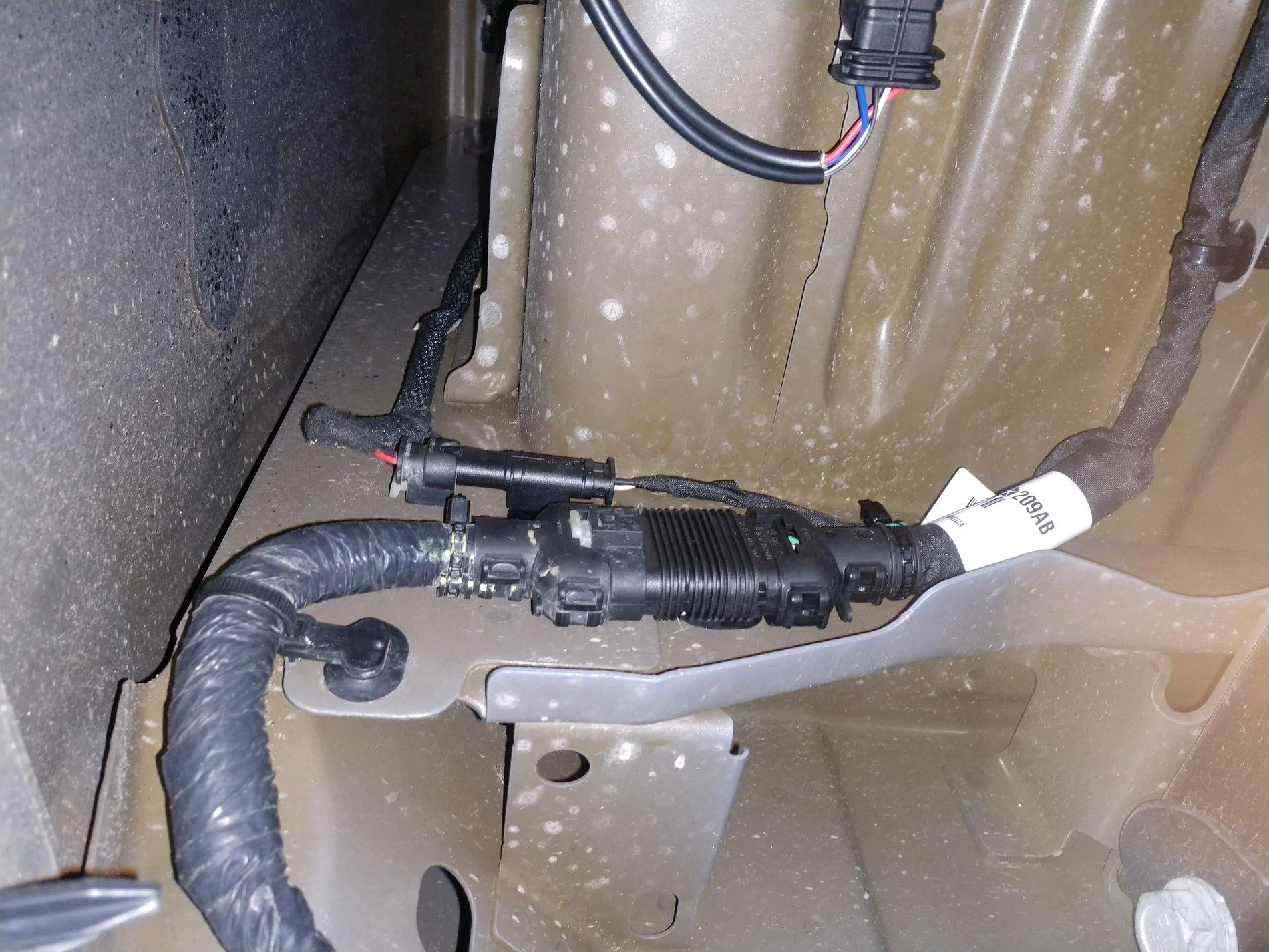

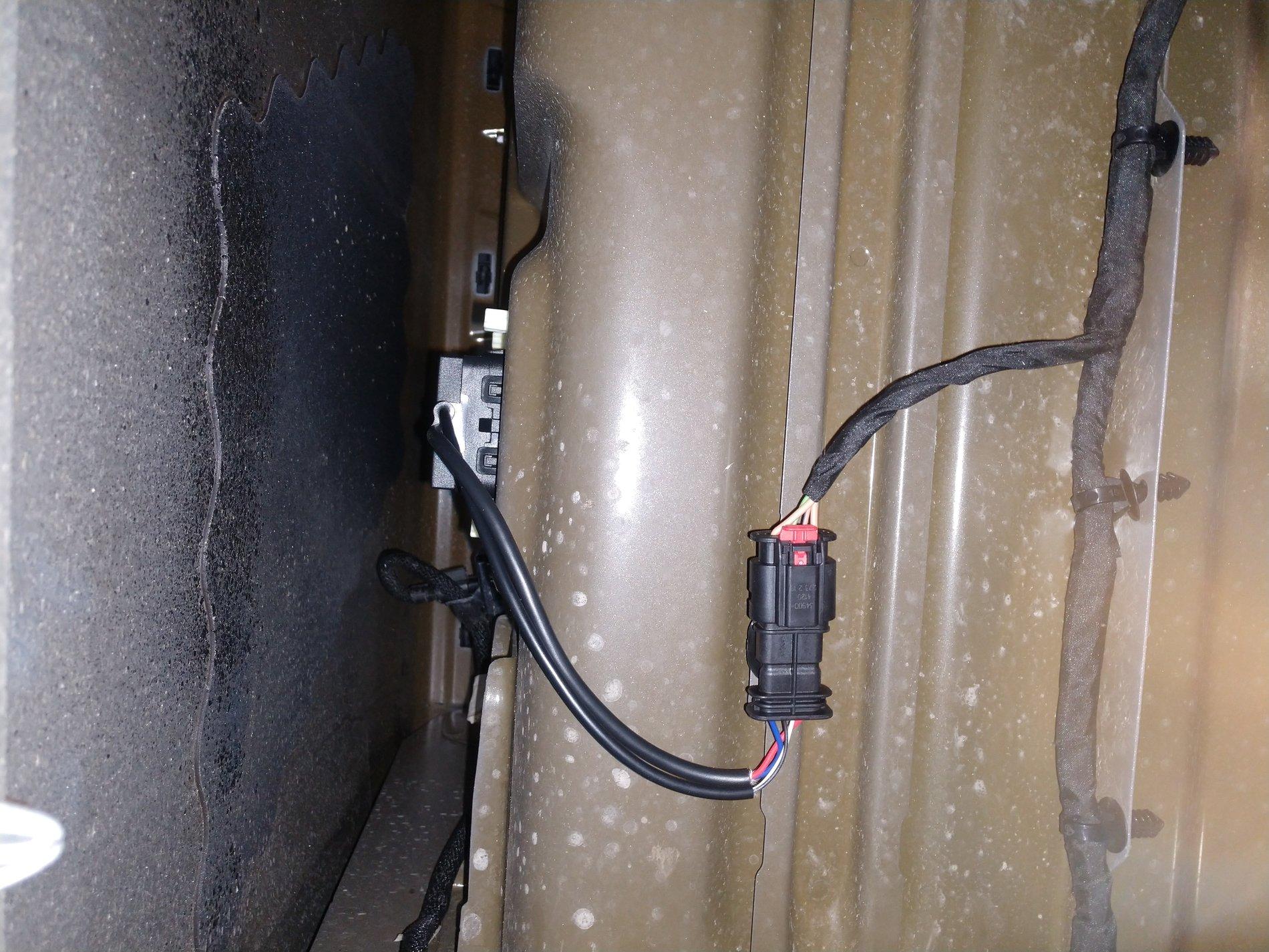

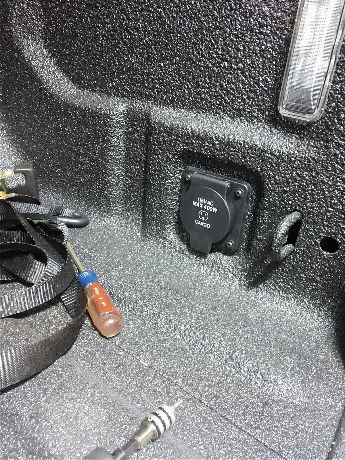

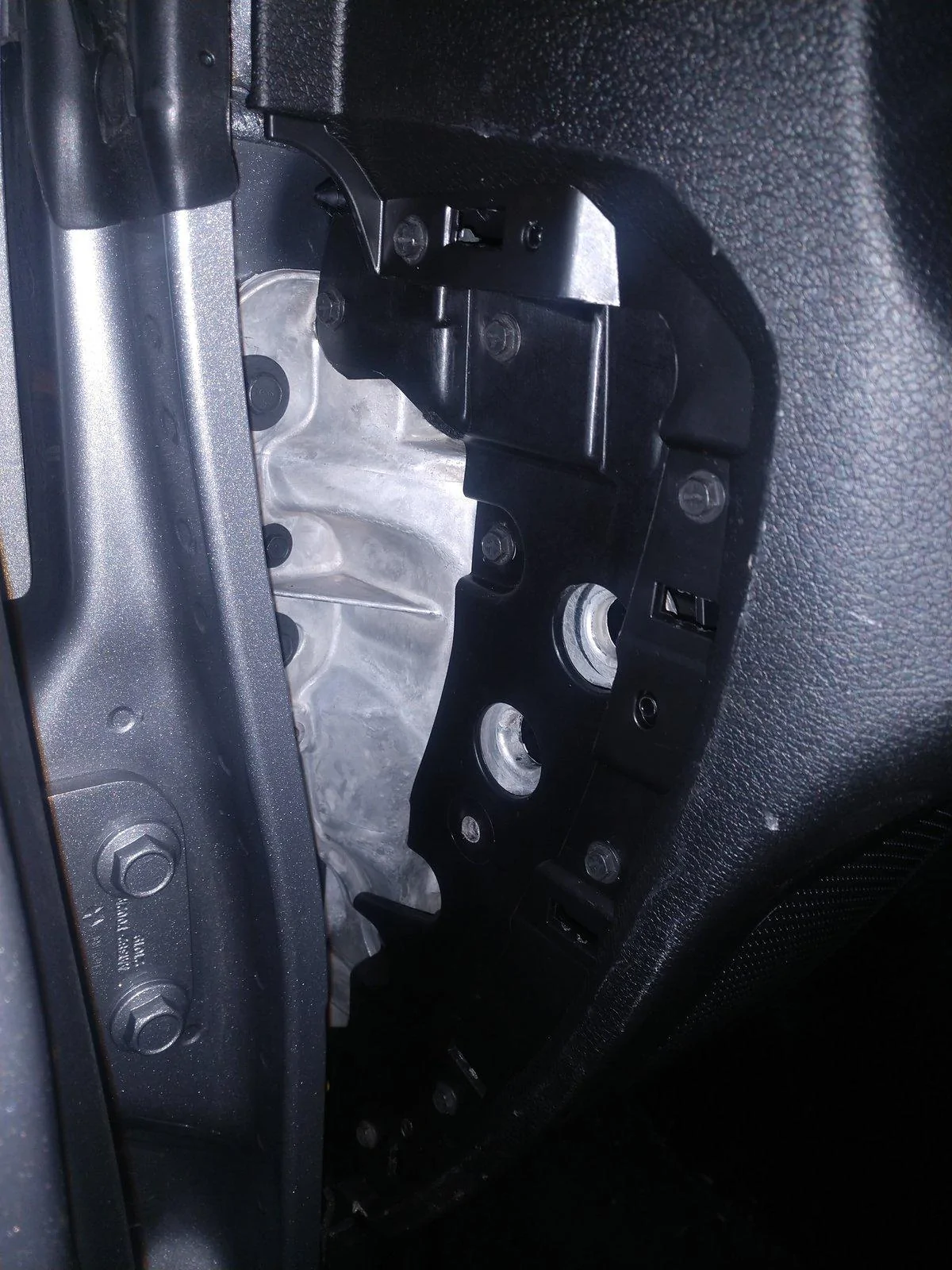

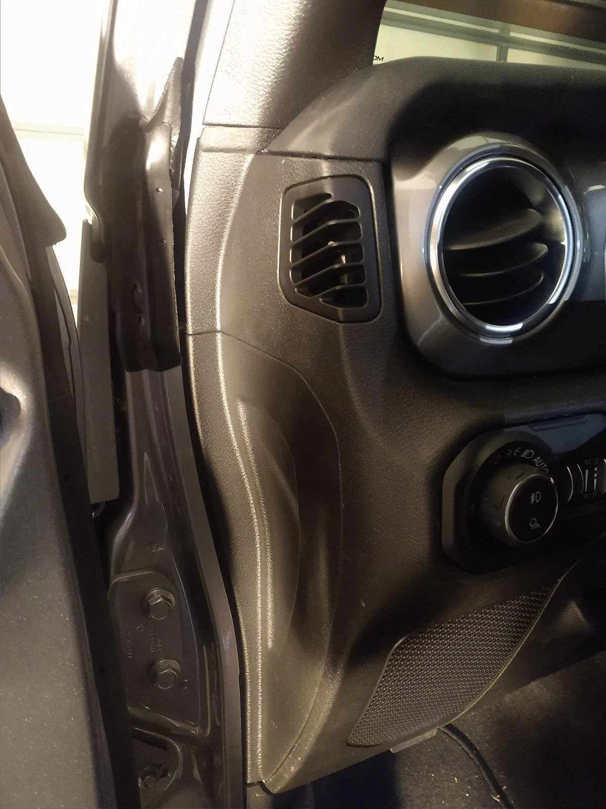

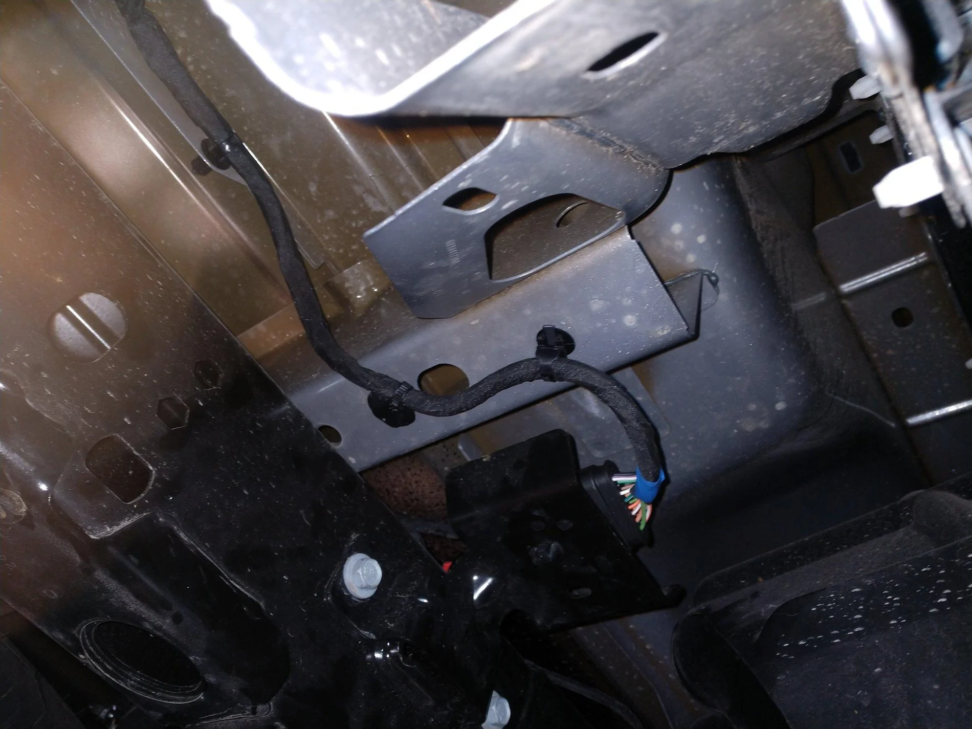

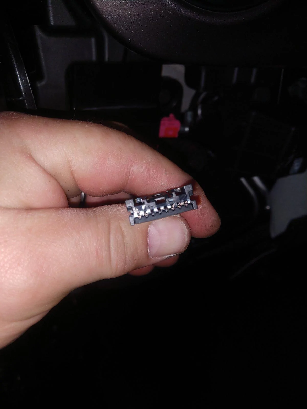

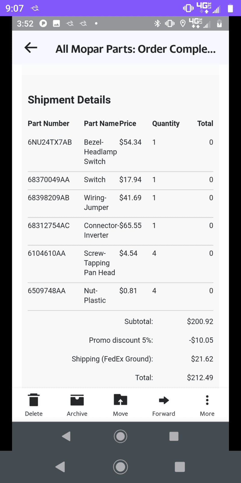

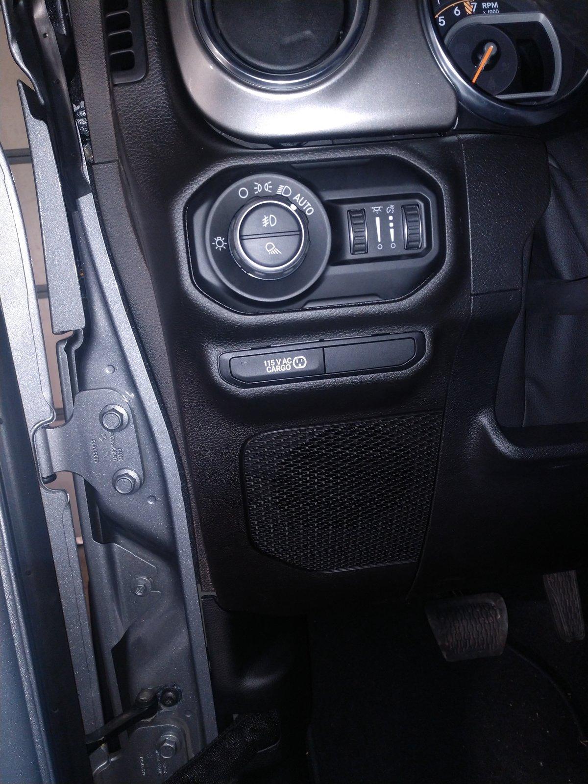

Ok with a lot of help from Benny with all Mopar parts I ordered the stuff. Since I already have the inverter I figured that it had to be possible. The harness for the dash switch was there and the wires to the rear harness on the passenger side were there. So I swapped out the dash panel, the wiring harness and installed the plug. The switch comes on when pushed, so I'm hoping the outlet will work once I take it to the dealer to have them flash it. Here's the parts and a few pics.
