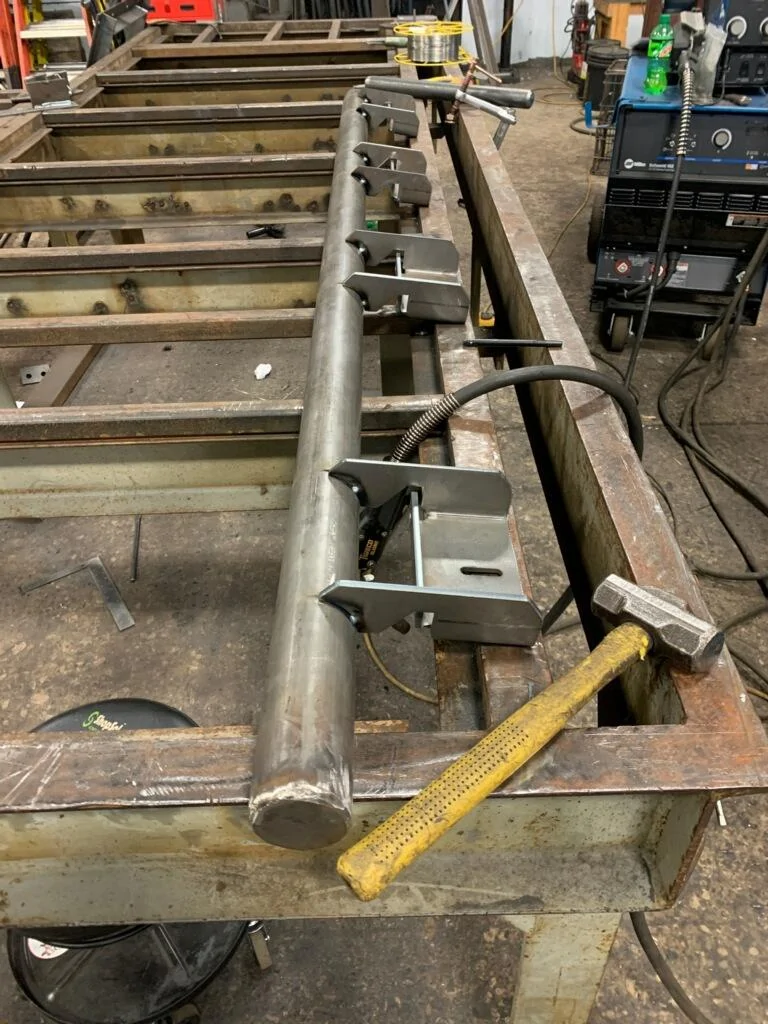

Latest update steps are taking shape. Will have to wait until tomorrow to test fit with the hours I'm working.

Had some progress on my steps made. The shop finally got someone on the brake and we made our first hanger. Noticed that there is some variance in a couple of the hanger locations and we'll have to massage the part in a couple locations. Overall satisfied with the outcome. Looking forward to having them fully assembled, hopefully the next couple weeks.
HA HA HA, now I get it. I thought you were just making a few steps for the rear corners of the truck box. Didn't realize you were making like "rock rail steps". or are you..., lol what am I looking at? I'll wait and see.:CWL:
Lol yeah they are full length step bars. This would be the main tube and hangers tacked on (upside down). They will be similar to Nfab with tube steps.

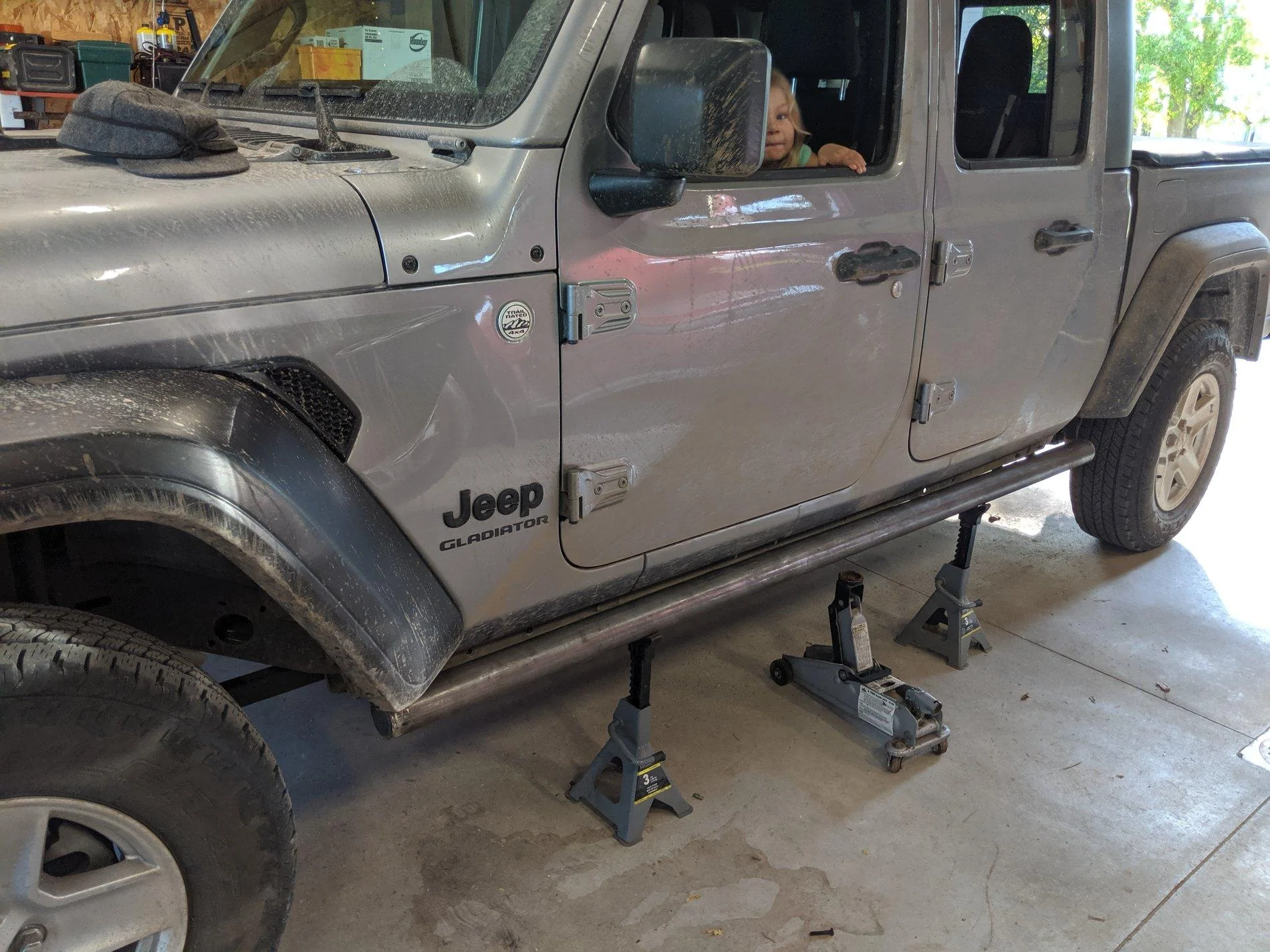

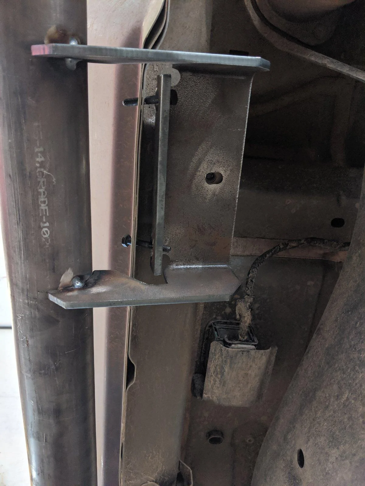

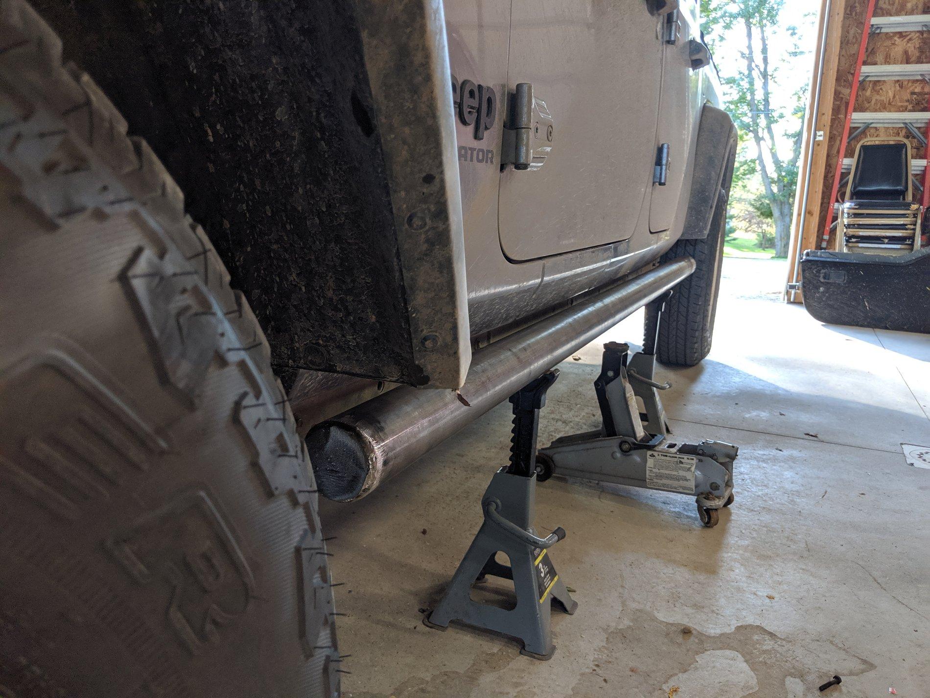

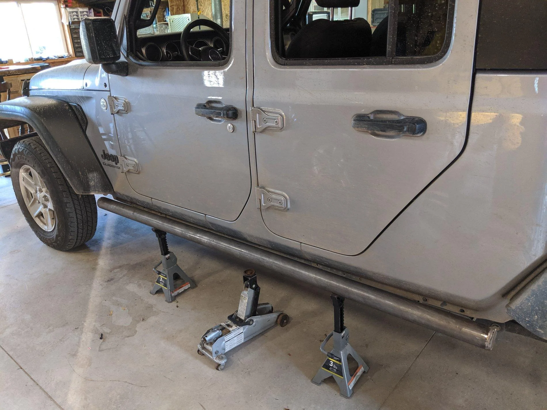

First fit up went well. They got the OK from me to get completed. We were mainly worry about the exact location of the mounting points. It's difficult to get real accurate measurements. Bolts were just pushed it to check alignment.
Lmfao, I thought those pads were stepping spots,now I see they're mounts for the bar..... I was wondering why there were like 4 on one side. :facepalm:
