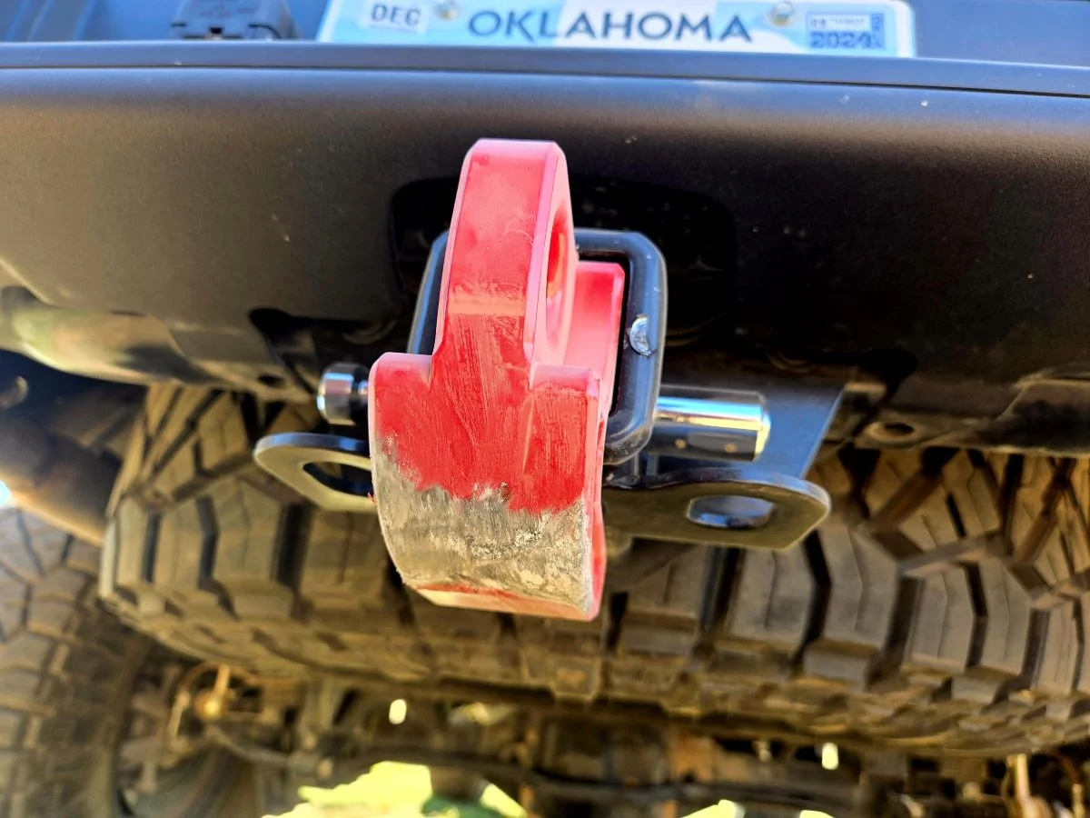

I would recommend a solid, full steel rear bumper and a hitch skid of some sort. The Gladiator's drag the tail everywhere. I now run the MC and it's held up well.
This was just after running Fins & Hells Revenge one time each.

I definitely will be getting one. But the ine thing I eliminated was that stupid spare tire . Cockeyed thing was always scrapping or dragging on something

This is the one I’m running. I like the flatness of it. Spreads the load a bit so there’s a greater patch if it were to set the whole rear end weight on it. In my mind the single skinnier point skid would make the jeep go wonky if I were sat on it.
https://nem-ind.com/ultimate-receiver-saver-1.html

Has anyone ever actually damaged a hitch by dragging it in the rocks? Bent tow loops is about the worst I've seen in 30 years of dragging rigs through rocks. The hitch slider to me are like diff skids. A solution looking for a problem. Drug the same Dana 60 through the Rubicon and fordyce and the dusy on 35s in my XJ for a decade without issue. Peeling the cheap sheetmetal covers open was a real risk, but an HD cover took care of that. I think you'd have to drag the hitch several thousand miles with the weight of the truck in it before it wore down enough to cause any problems. If it gives you peace of mind it's worth the small investment. On the JLUR we run a large pintle ring, but that's to push the rig out away from the obstacle so we don't drop down on the spare.

I got one of those tall 41.22 hitch sliders specifically to protect the spare tire when I have to leave it under the bed (which is most of the time). I was starting to accumulate drag marks on the tire from shelf drops. Totally stopped once I did - very happy with it
I can put the tire elsewhere at times (and I did on the Rubicon) but for some of us, some of the time, it's not so simple as throwing it in the backseat or bed where it would displace people, dogs, and hard-mounted storage
