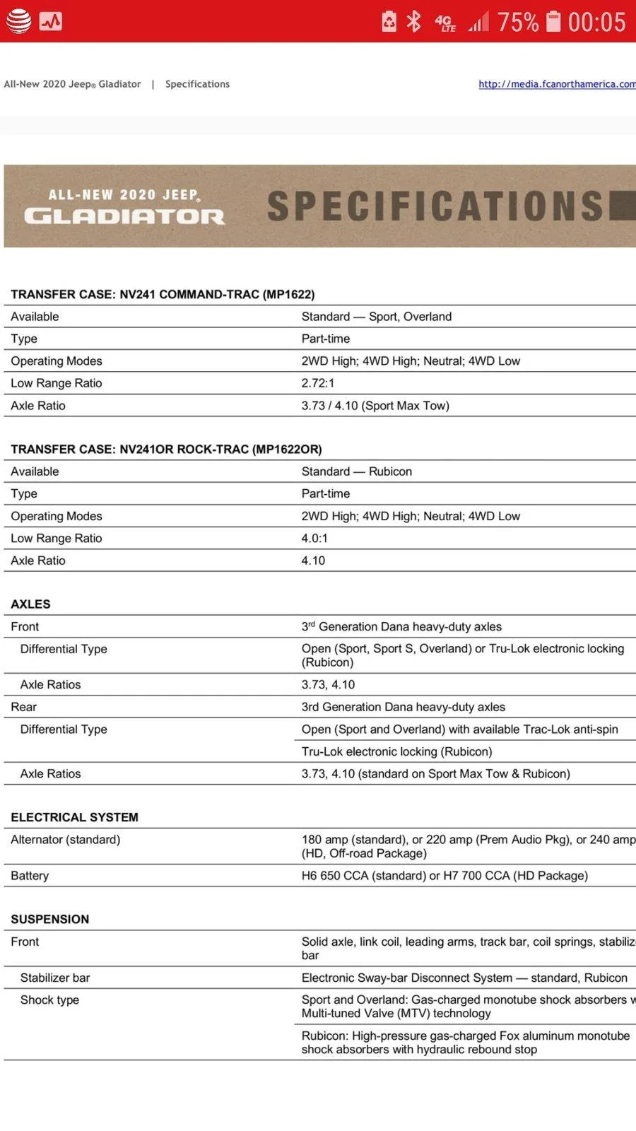

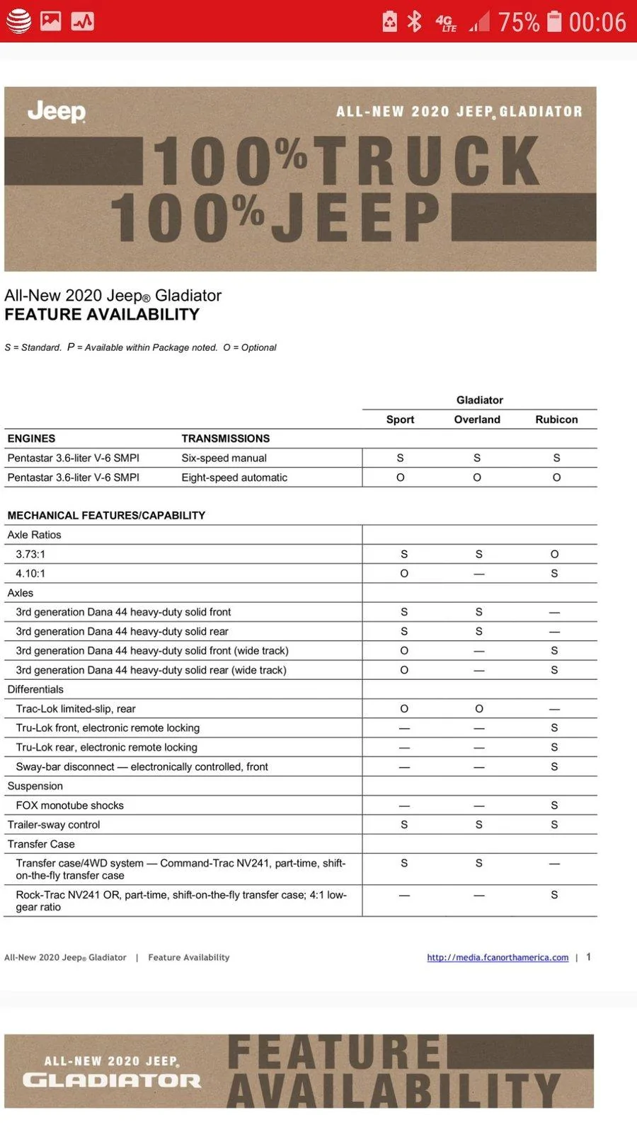

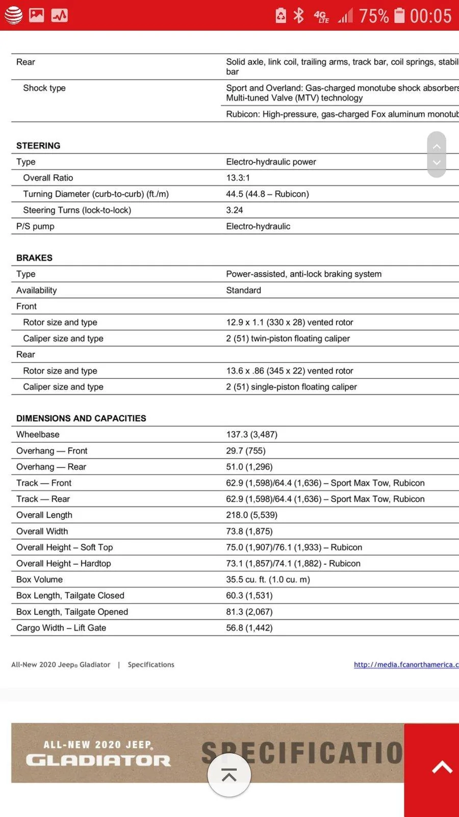

Here it is. Reference for gear ratios and axle width. 4.10 and wide axles Standard on the Rubicon/ Optional (with max tow package) on the sport

Nice, thanks for setting me straight. That reminds me, I forgot the need for the upgraded transfer case on my second option.
