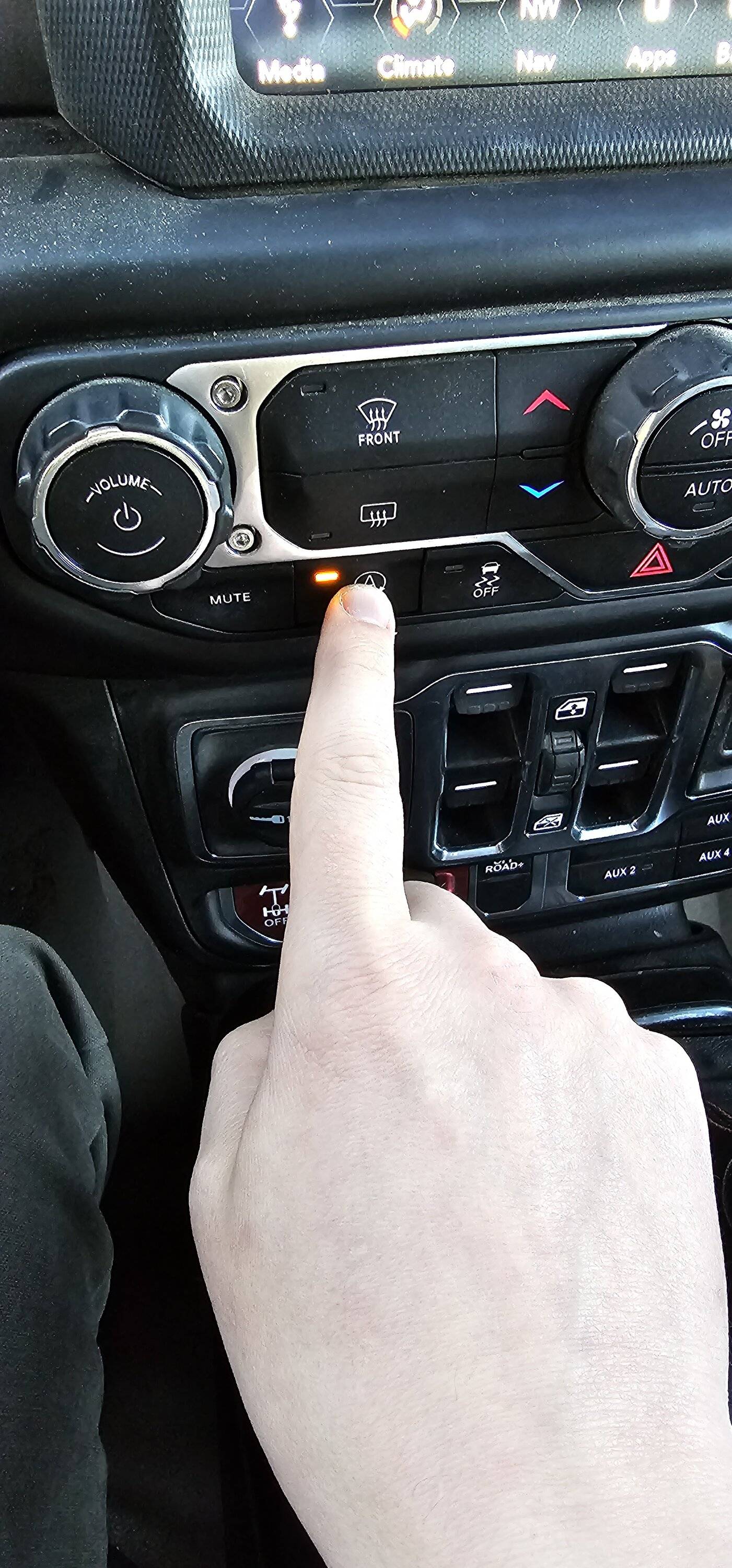

Here's the autostopstart eliminator I use:
