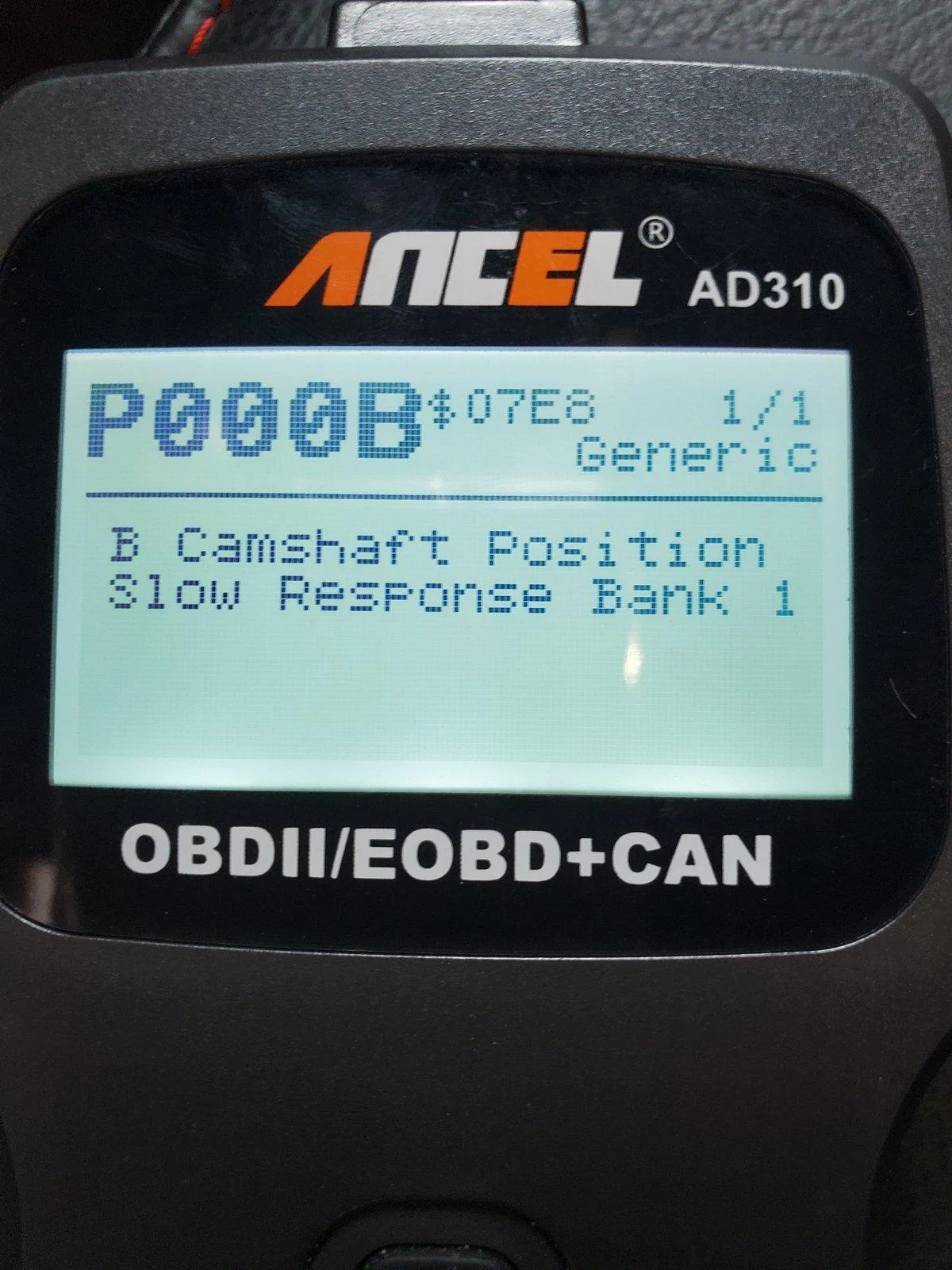

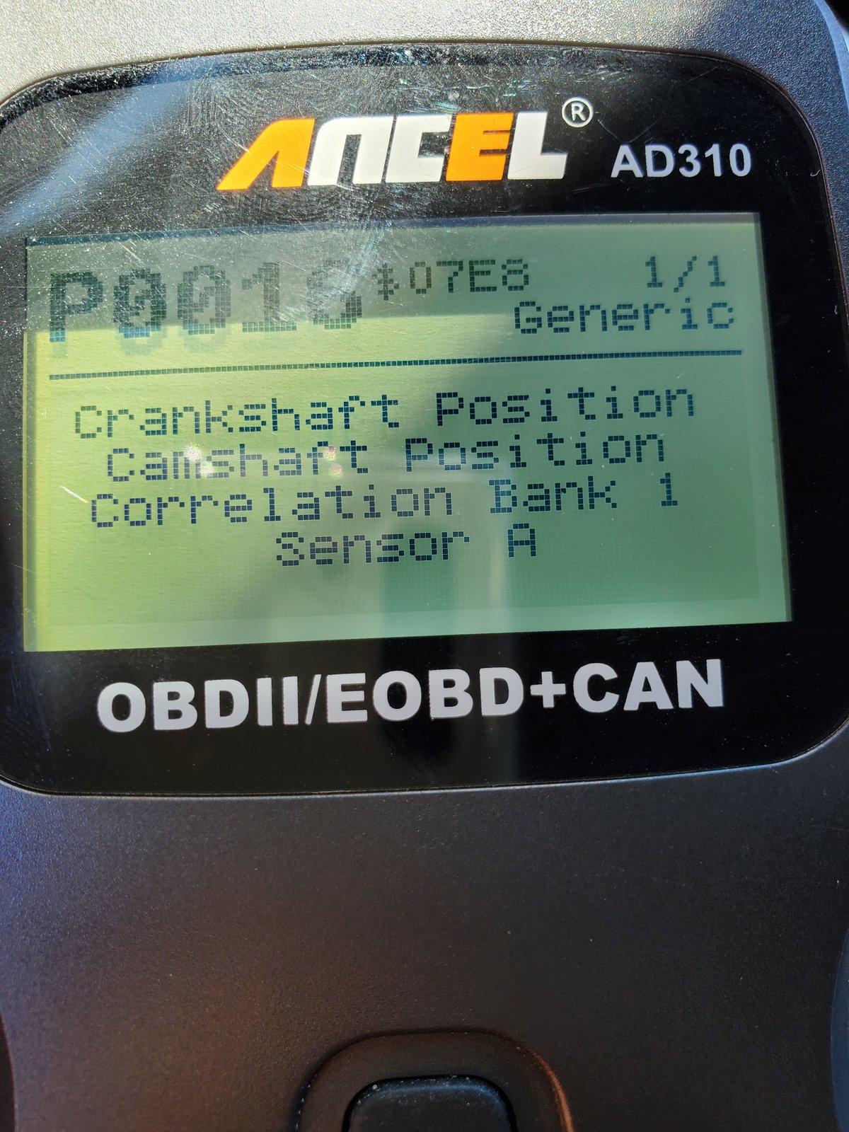

Had to drop mine off at the dealer Friday. Getting codes P00B and P0016. No clue what to expect, this seemed to be the first my dealer has heard about it.
4045 miles currently, Installed a Hamburger Supercharger at 3500 miles or so. No clue if there is any relation. Had no lights or issues prior to the install.
Hi Skyler,
Thank you for bringing this to our attention. We have responded to your private message - please continue to work with us there in order to avoid missed communication.
