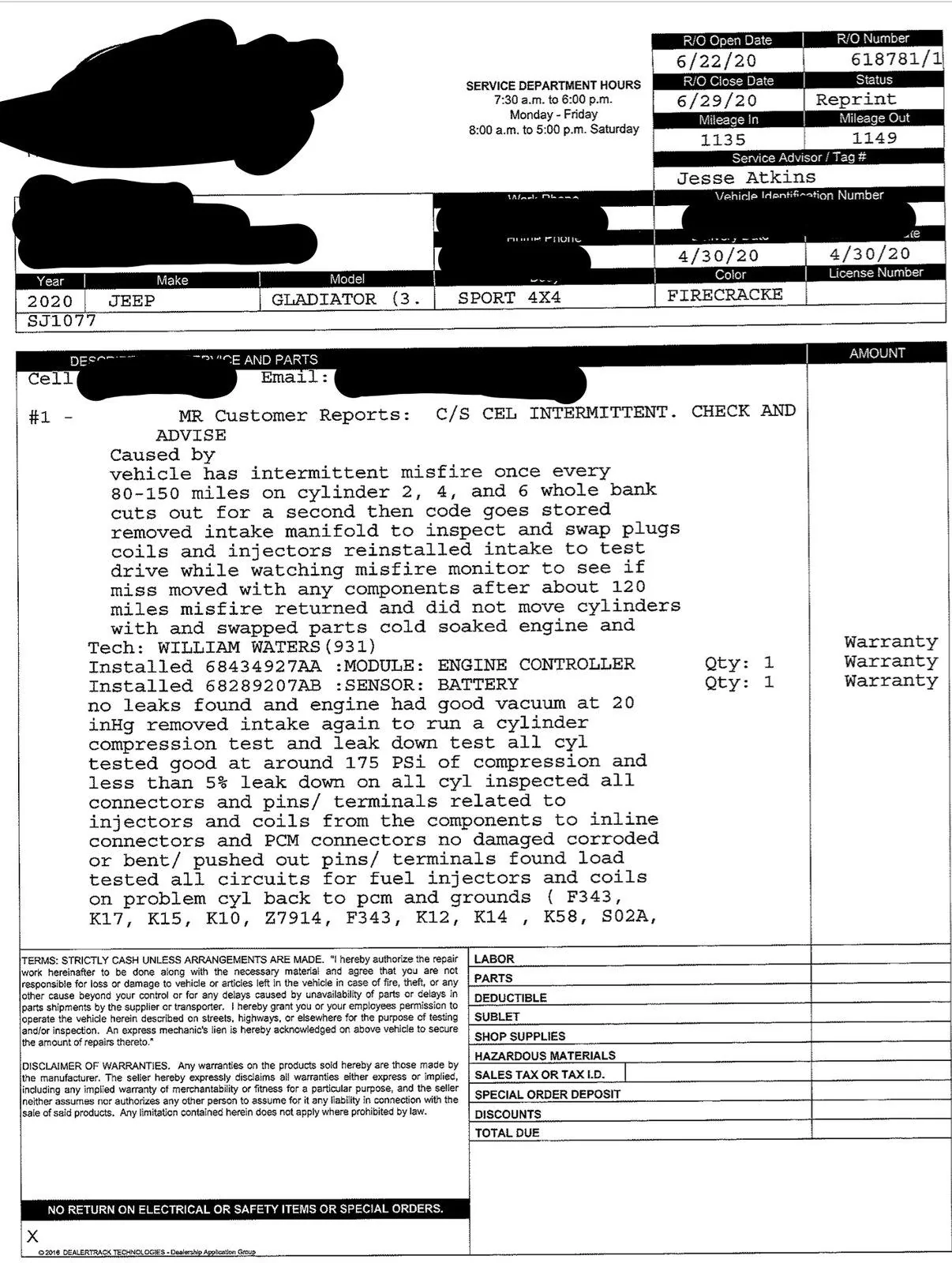

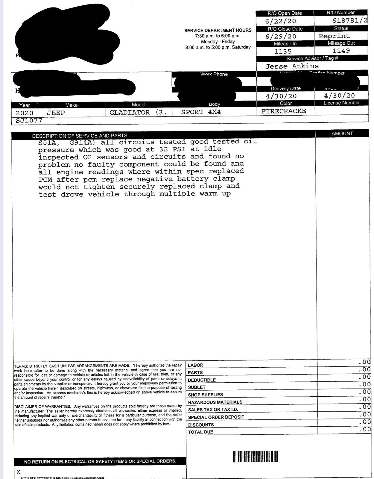

Sorry-I had to delete my last post because there was identifying information on the work summary. So here it is now. This was attempt #3 to repair the issue. Dealership is working hard. It’s unfortunate we are here.
Jeep Gladiator Survey- For those with misfire issues F295E314-4D69-42B3-B39B-9FB7E137DB9E
Jeep Gladiator Survey- For those with misfire issues 831E42F8-E4C9-4FDF-B0D7-B7923DB7E193

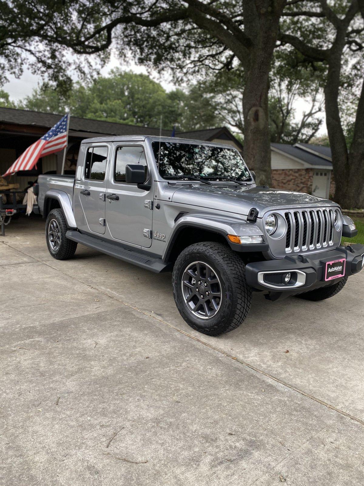

Build Date: TBD - It's in the shop...
Mileage @ first occurrence: 50-60 ( bought it with 36 miles on it and only had it 2 days
Times Occurred: 1
Codes Thrown: P0300
Ongoing Issue? Yes
Methods Tried to Fix: have not heard any attempt to fix yet
Was issue resolved? No my dealer is terrible tried to strong arm my wife to pay for a rental or said she could Uber to work, she had to put me on phone to force them to provide a rental and gave her serious attitude and very disrespectful to her. I expect this will not be fun adventure for us. It’s our only family vehicle my truck is a company work truck and we have 3 year old.
Location Kay, Texas
Dealer autonation dodge Katy (avoid at all coast if you can)

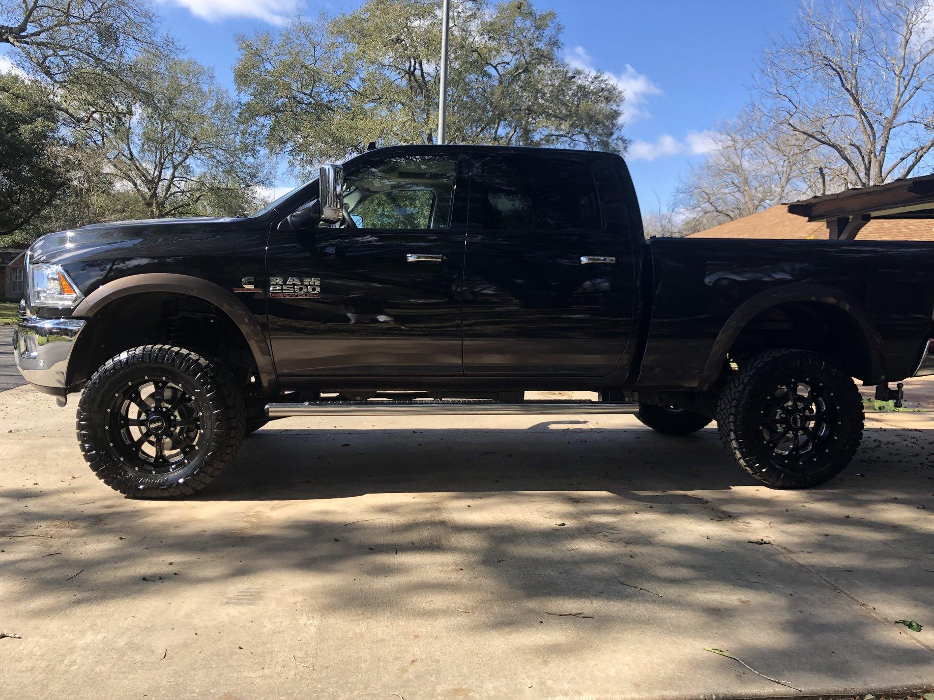

Should have never traded my 2018 ram 2500 Laramie with 28,000 miles for this pos! if I could kick myself in the nuts I would! first Jeep and proly last Jeep!
I'd be amazed if the PCM ultimately fixes this. For your sake I hope it does but that's normally the part that gets installed when they can't find anything else wrong.
It didn’t. In my earlier post this morning I noted the CEL is back.

The PCM with the same software in it won't do anything. The software would hopefully run the same no matter what PCM it is flashed on to. The only saving Grace would be if you drove it more aggressive on a clean slate before the adaptive tables took to some bad map values

Your new PCM should have been flashed with the newest software.
I'm the least aggressive driver you'll come across and I haven't had an issue. This is not an issue that will be solved by modifying driving habits. It the vehicle isn't actually misfiring then the monitor may be too sensitive which a software update could address. Unfortunately there's no newer software than what you have right now.
