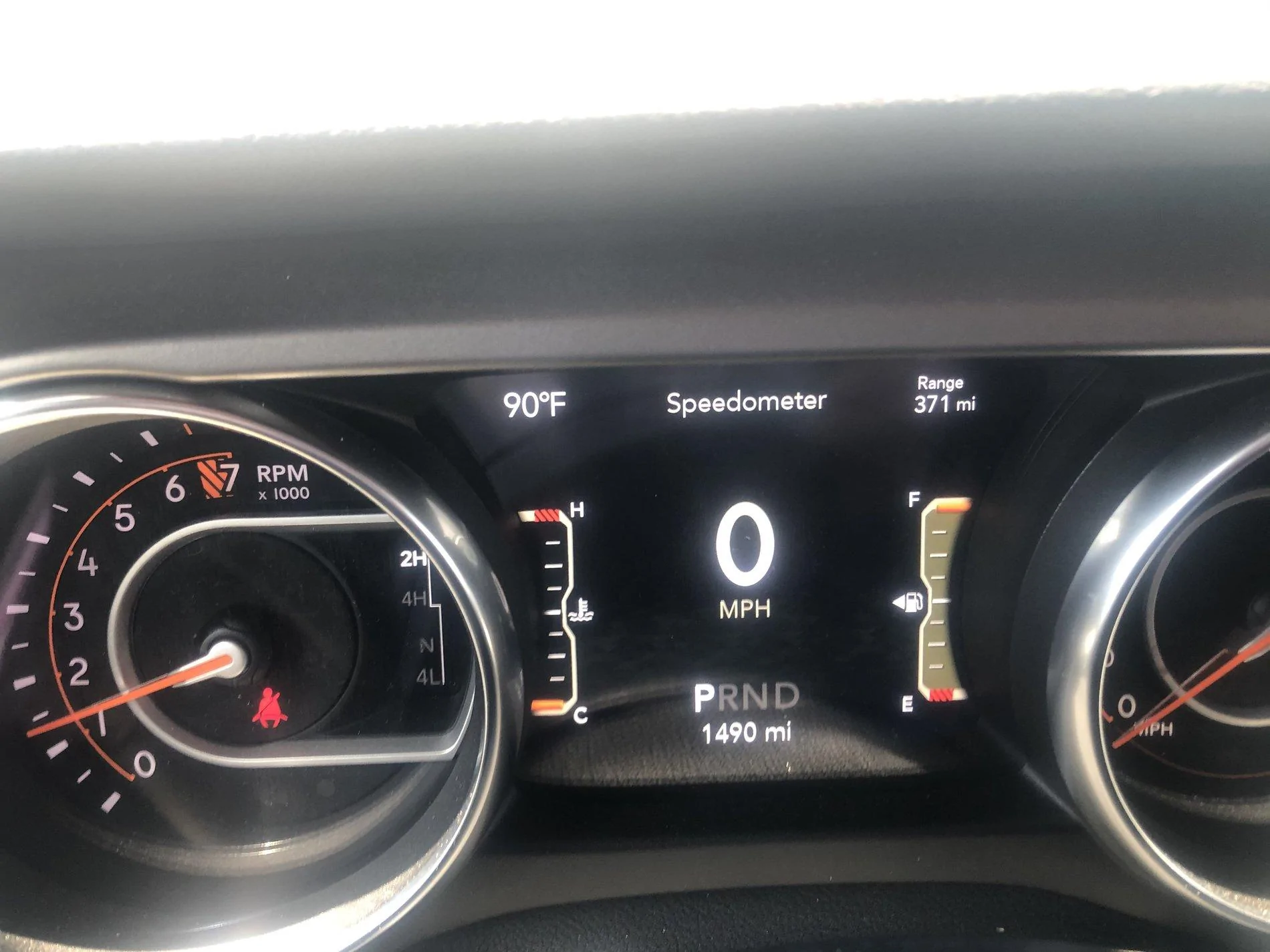

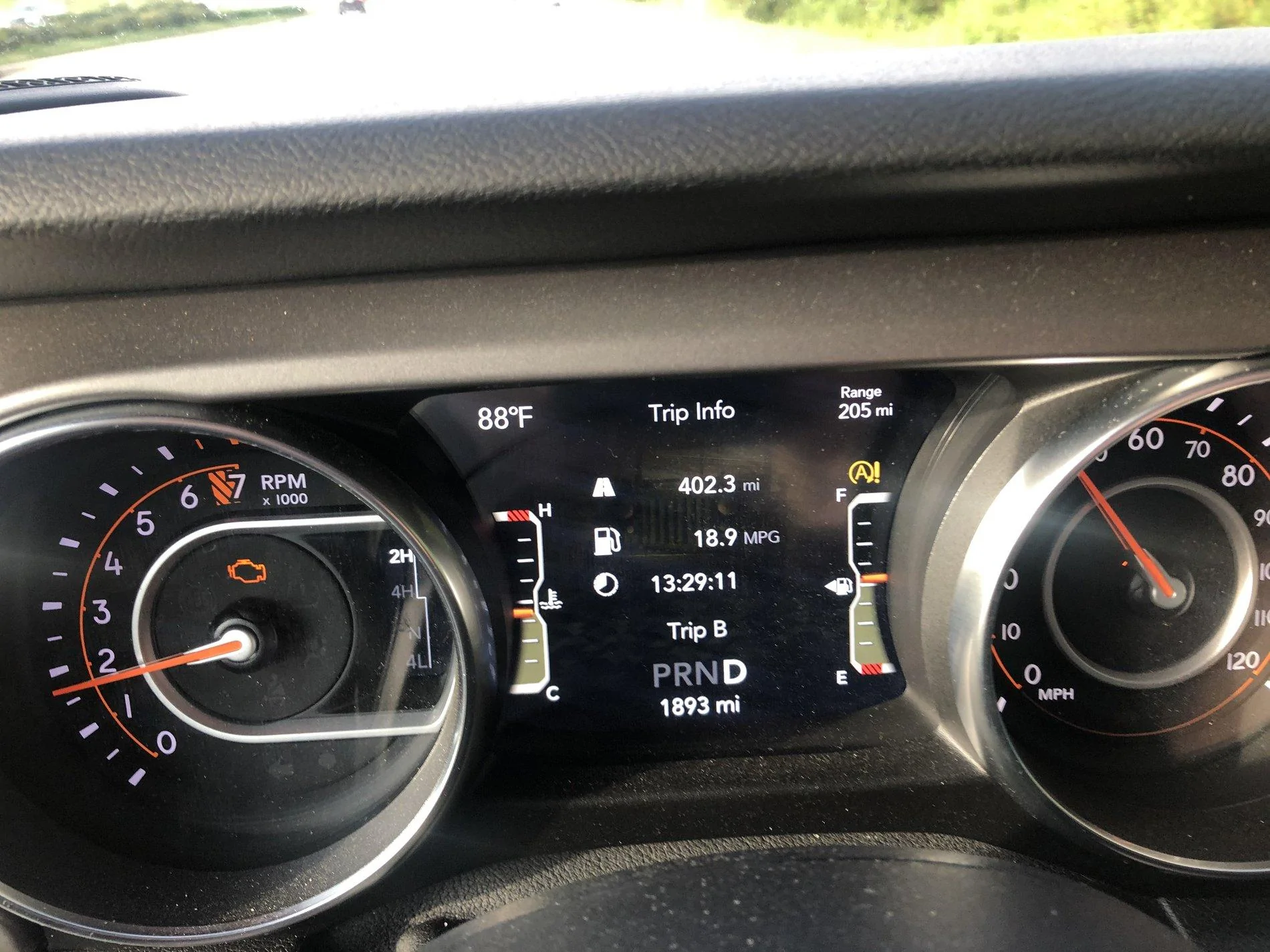

So as you can see here, we took that beach trip and 400 miles later-another CEL. The first image is from this past Wednesday when we picked up the Gladiator from the dealership. The second image is from 2 hours ago. I have already spoken to the general manager at the dealership where I purchased this vehicle. I told him this is incident #4 because I live in North Carolina I will most likely use the attorney I have already contacted and require FCA to replace this vehicle. This is why lemon laws exist. I took delivery on May 1st, 2020. The first CEL was May 28th, 2020 and now it’s June 29th, 2020 and we’ve been in the shop most of the month now 4 times with the same issue. For those who have asked-YES-you should consider a different vehicle unless you want these same dilemmas. The only thing that may hold me back is that my dealer has been great so far and he may find a solution but I don't trust FCA and you shouldn’t either. I don’t want FCA’s potential mid-July fix. I want my $40,000 vehicle to run for years and me not have to think about it. I also don’t want some overly perky freakin’ millennial with a degree in social media marketing to tell me “Oh we’re sorry you’re having trouble with your new Gladiator. Please let us know if you want to escalate your concern blah, blah, blah....”

So as you can see here, we took that beach trip and 400 miles later-another CEL. The first image is from this past Wednesday when we picked up the Gladiator from the dealership. The second image is from 2 hours ago. I have already spoken to the general manager at the dealership where I purchased this vehicle. I told him this is incident #4 because I live in North Carolina I will most likely use the attorney I have already contacted and require FCA to replace this vehicle. This is why lemon laws exist. I took delivery on June 1st, 2020 and now it’s June 29th, 2020 and we’ve been in the shop most of the month now 4 times with the same issue. For those who have asked-YES-you should consider a different vehicle unless you want these same dilemmas. The only thing that may hold me back is that my dealer has been great so far and he may find a solution but I don't trust FCA and you shouldn’t either. I don’t want FCA’s potential mid-July fix. I want my $40,000 vehicle to run for years and me not have to think about it. I also don’t want some overly perky freakin’ millennial with a degree in social media marketing to tell me “Oh we’re sorry you’re having trouble with your new Gladiator. Please let us know if you want to escalate your concern blah, blah, blah....”
Sorry to hear that, but sad to say not surprised. I spent a good amount of time at the dealership today (where I also took note of the build date of my JT - October 2019). The service manager seemed uninformed on the issue and basically chided me for using the internet as a resource, as though I was using WebMD to diagnose my arthritis as terminal bone cancer. They are committed to tearing into my engine to replace both cams, all the rockers on the left side, etc. etc. I was pretty emphatic this was not me vs. my dealership. I have nothing against them, and rather see them as the victims of a corporate foot drag. Folks, I’m not saying to not fix cars - you’re great at it - but this is not yours to fix.
I cannot emphasize enough how much I want to engage FCA on this. Most of those affected have build dates around Sept/Oct of 2019. This is a time-delimited supplier issue out of the engine plant in Mexico. This is not software, or as I and others have noted, the affected field would be larger. @JeepCares has promised to call me by 0818 tomorrow. Seems improbable now at 2102, that’s 9:02pm for those here not of a retired military ilk like myself.
There’s even a JT like mine on the dealer’s lot, plus a few options, which I’d be happy to try - it’s several thousand VIN numbers newer than mine, though I’d certainly check the manufacture date.
I think you’re right. It has to be something with the late 2019 manufacture date. Mine is September 2019. I’m not driving it after having the entire engine torn down. It’s already been 20 days and this is episode #4.
I’m with you @jwork435. T
Similar build date as mine. After 3 visits, they are now replacing the engine. Dealer stated FCA was buying back my Gladiator.
