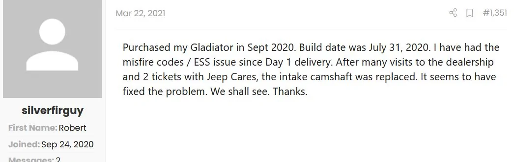

report date: 07jun2021
Build date: 10Oct19
Mileage when it first occurred: ~10,800
How many times has it occurred: twice, once in mid-May, most recent 31may21
What exact codes did it throw: PO 300 at dealer service bay
Is the issue on going? CEL 'self-healed' 03jun21, prior to going in for today's service appointment
If so, what has been done to try to solve the issue? new camshaft to be installed, per FAC warranty. Never did note any mis-firings, smells or loss-of-power. Just the CEL light.
Was the issue ever fully resolved? not yet . . .
-Bought this (otherwise Great!) truck, (pre-owned w/9M miles) in late March21.
-Had periodic (ultimately self-healing) AutoStop warnings 2-3 times.
-CEL came on 31may. went to dealer 01jun21.
-At the Dealer visit 01Jun the then-existing CEL threw a PO300 code;
-appointment made for follow-up 07jun21.
-CEL went off after gas fill on 03Jun.
-Took the truck to dealer appointment this morning, waited in customer lounge.
(thought this morning's check -was advised- might result in a simple software update, but noooooo.)
-After only 20minutes and without a CEL showing, the service rep informed me the dealership was corporate-authorized to 'replace the camshaft' (!).
-I do not know of any testing done today, but in twenty minutes how much could they do???
- was promised return on 'Thurs/Fri'. Parts on order from Atlanta. We'll see.
-had to cancel this week's fishing trip, dammit.
Question for the Board: My wife & I have a 2400-mile family road trip planned for the third week+ of June. My confidence in a reliable ride from my new-to-me truck has been dented, if not crushed. We have road service memberships. Should a newly-installed-by-an-authorized-dealer camshaft necessarily cause concerns with these long road trip travel plans???
paul
Jun 4, 2021
charleston sc
JT20
biologist
follow up to post #1365
Just returned from a 2700 mile RT, fully loaded with packing boxes.
Success! Nice ride I must say. My confidence has been restored.
After the '2-4-6'cam warrenty-covered replacement and a software update specified to calibrate the 35in tires (not done by the previous owner, grrr...) the trip went smooth and uneventful.
Used Interstates at posted speed most all the way. No CELs or AutoStop hiccups.
This may qualify as 'fixed'; I can only hope so.
Sure would like to see a compilation of this Survey data.
It was VERY helpful to have this thread as an informative reference.
Best wishes to y'all.

I studied this Board for 2 months. I saw no one say their misfire was fixed. If there was a known fix, FCA would have tried it on my truck.
Have they replaced the right intake camshaft yet?
Sorry if you've discussed it and I missed it.
I did not own the truck long enough for a cam shaft to be replaced. After rockers were replaced, FCA repurchased my truck in lieu of a Lemon Law claim.
