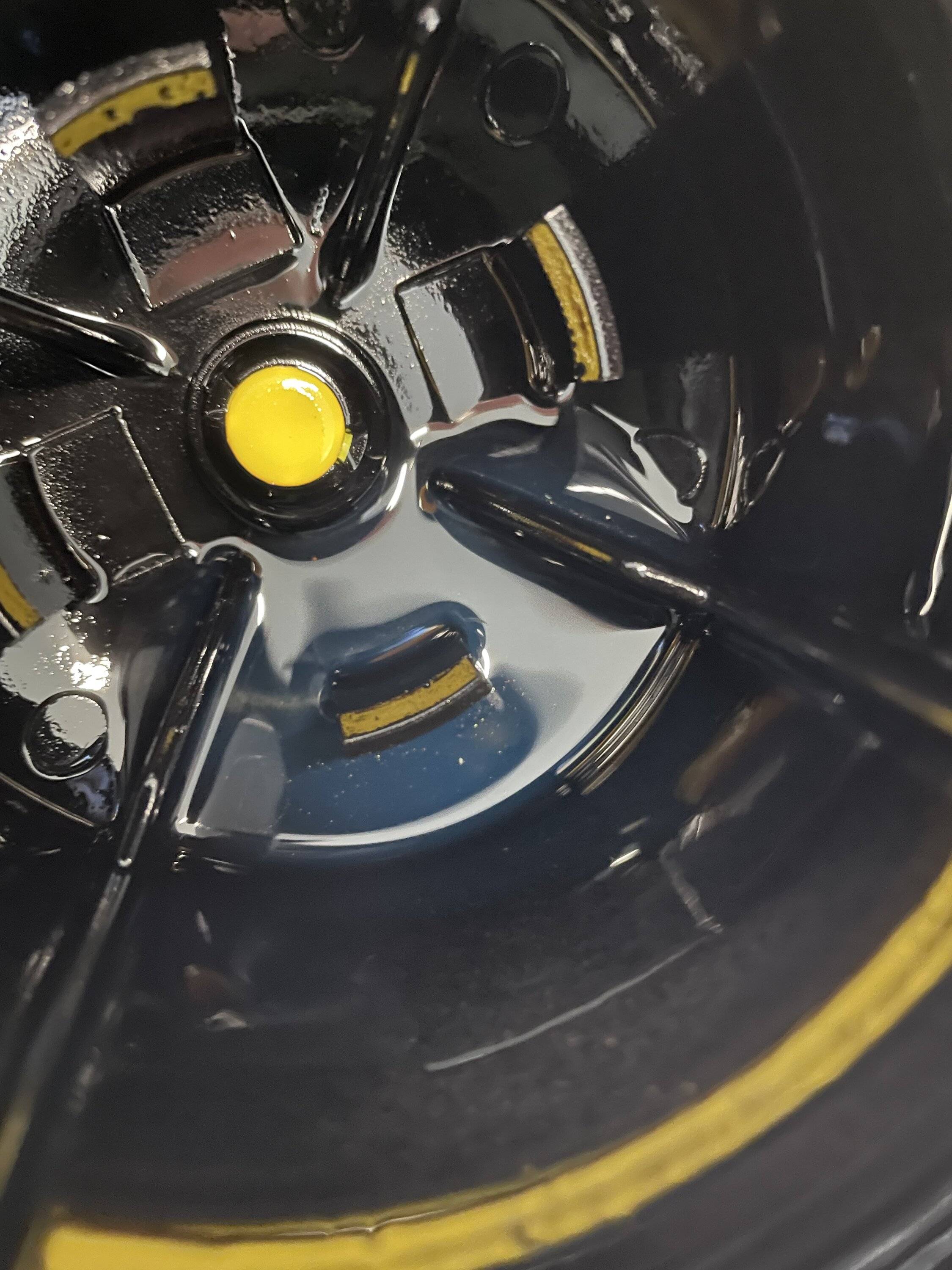

You would think checking the filter screens and then pulling some fuel samples and having them analyzed would be the easiest way to determine foreign debris within the system.
Changed the fuel filter on my 17' Ram eco yesterday. This is what contamination will look like. Good amount of aluminum present in housing. Tested with magnet as well. If nothing sticks to it than its aluminum from the injection pump, not rust. The usual garbage from the dealer "No Parts available". Keep running it until inoperable.
