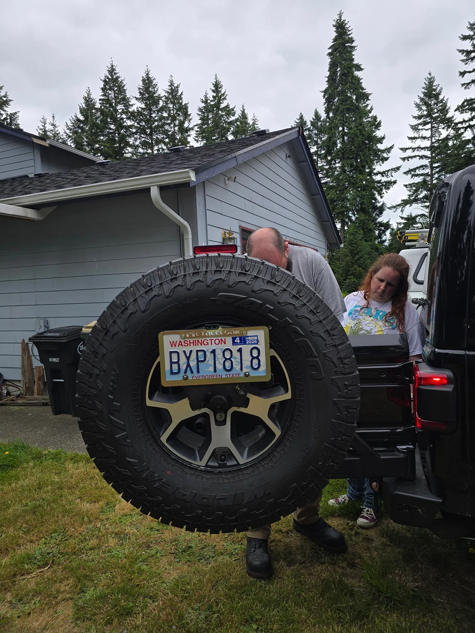

The Falken AT4W in 33, 34, or 35" can be had in C rating.
Just put a set on our Glad, Put a set on our JLU 6 months ago.
