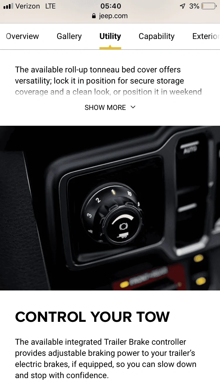

Okay Jeep,what’s up with the lack of a brake controller option?
bangolia
Bryan
Jan 8, 2019
834
1,056
Garner NC
2014 JKU
The Jeep gladiator page has been updated recently. It includes this now...
Jeep Gladiator Towing Capacity - Lets get serious here... D732CB35-65FA-4173-8564-8A1D552517CC
