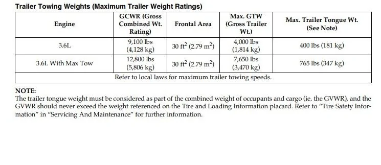

I find it interesting that the owners manual only shows two towing ratings. With Max Towing Package and without Max Towing Package. No designations for Sport, Overland, Rubicon. No designations for transmission. (Max Towing requires the 850RE of course). But you either have Max Towing, or you don't.
Without it, the maximum trailer rating is only 4,000 lbs.
With it, the GCWR increases a whopping 3,700 lbs. and maximum trailer weight increases 3,650 lbs.
It almost makes the Max Towing Package a must-have item. 4,000 lbs. trailer max and 9,100 lbs. GCWR are miserable specs. for a pickup truck.

That is very confusing = is that info specific to Sport & Sport S only?
If it's supposed to cover all, then the Overland definitely should not be towing that Airstream in their ads. Rubicon couldn't tow it either without going over spec-

The Rubicon has Max tow equipment. but you are right, should be a little more distinction here

I haven't seen anything that suggests the Rubicon has the added cooling of the Max Towing package, and it's payload is 65% lower, so I wouldn't assume a Rubicon has the same equipment as a Max Towing model.
But yeah that is my point... the chart I posted above is the only towing information in the manual. I thought that was odd. It's very vague.

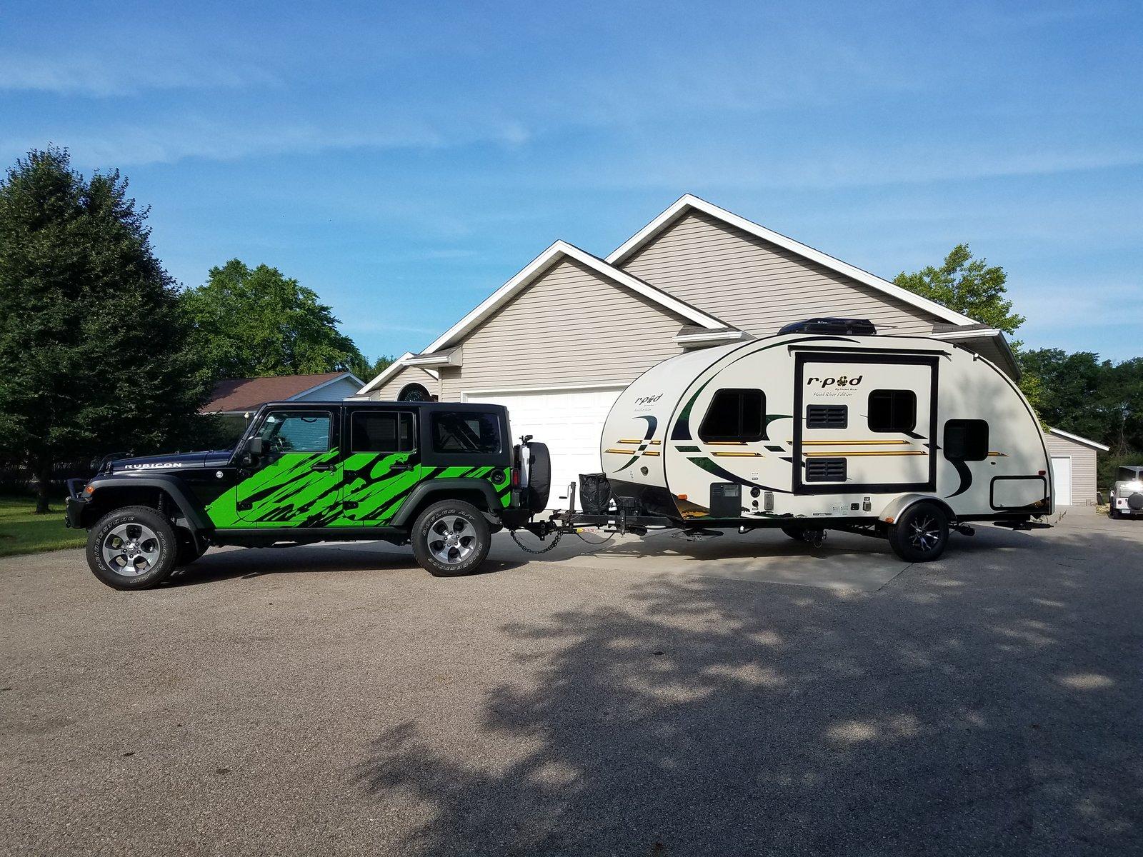

As much as I would like a single vehicle to replace my Ford Raptor pickup and Unlimited Rubicon - I am having my doubts that the Gladiator is the truck for the job. Sure, the towing specs for the Gladiator are right up and beyond what I had hoped for - the engine is just not up to the task, regardless of the three extra gears in the transmission...
My 2015 JKU Rubicon with W5A580 / NAG1 5 speed Automatic, 3.73 gears, Stock Mud Terrain BFGs (31.5”) or Highway Tread tires the same size — is used to tow my Forest River Rpod 182G (3500#).
I never tow above 65mph and usually 55-60. I tow 5,000-7,000 miles.
I will tell you right now that the stock 3.6L engine (285 hp) starts running out of wind over 3500 feet altitude. Over 7000’ its butt is kicked and simply won’t tow any faster than 60 mph on level ground - even with a mild tailwind - and is in 3rd gear and many times 2nd gear.
This is just not a good engine for towing anything that has any sort of girth or height due to increased dynamic loading - AKA “Wind Resistance”.
This year, I did install a SuperChips Trail Dash 2 in order to get around the totally insane factory transmission shift strategy and that does help - but there was no increase in power that I could tell.
You cannot GIVE me an EPA-Diesel, so until Jeep installs a Turbocharger on this engine or a higher HP normally aspirated engine, I am pretty sure I will sit this one out...

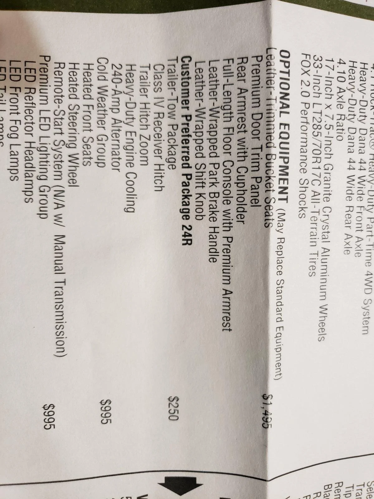

It does, on the window sticker of my Rubicon it says trailer tow package which includes class iv hitch, trailer zoom, 240amp alternator, and heavy duty engine cooling.

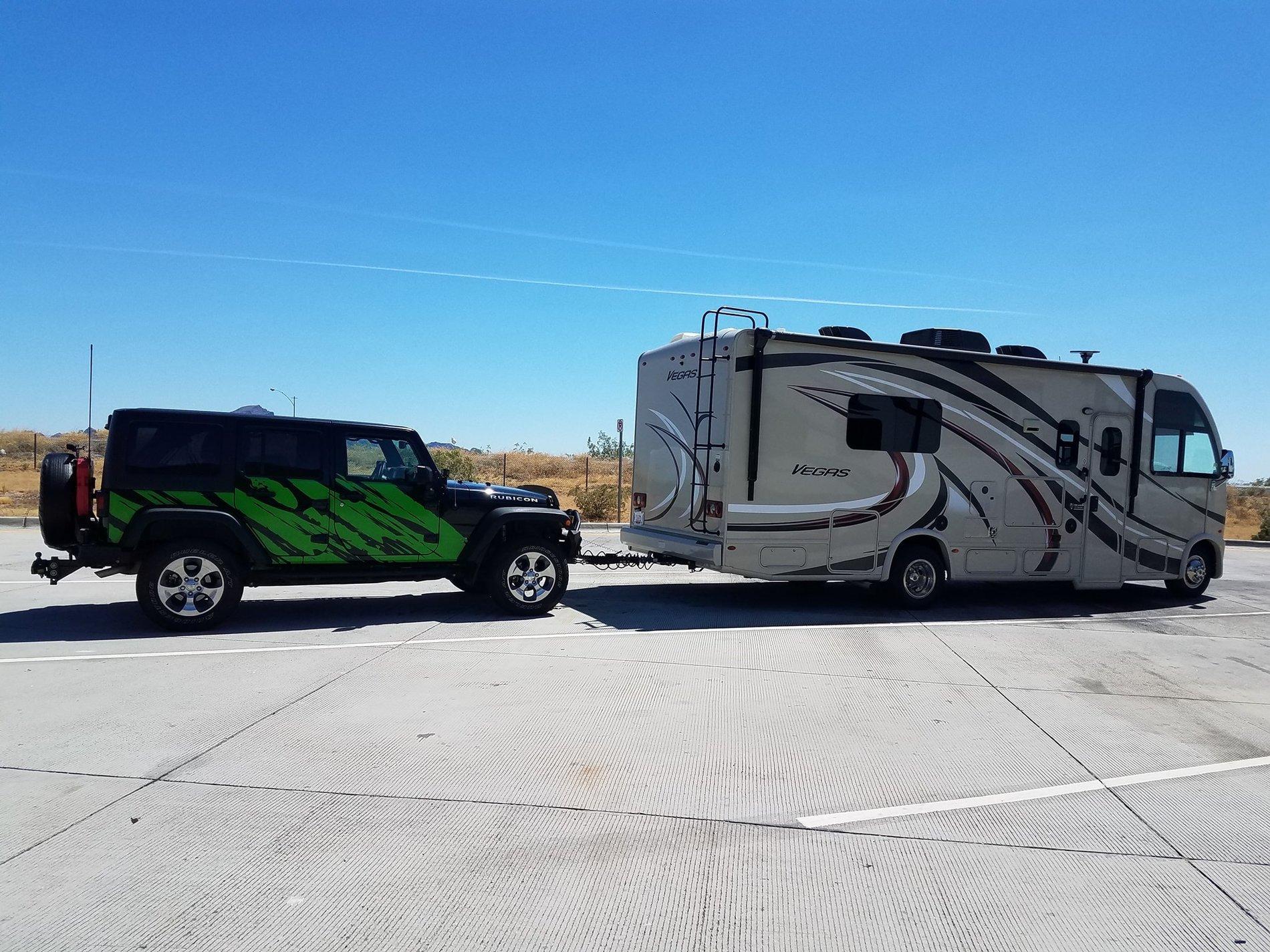

I, personally, have resolved my towing problem with the JKUR by buying a motorhome to tow the Jeep. But this solution is not long term for me. I do a lot of towing / travel and most trips it involves mountains and sustained high altitudes like I-80 through Wyoming. I would prefer a trailer and a stable tow vehicle that I can take off-road like my Jeep.
My concern is that I suspect FCA rated the Jeep JT at 7650# at sea level and on level ground - but didn’t bother to state the whole truth-
Example :
Maximum towing capacity 7,650#***
*** Sea level - Level roads - max speed 55 mph
Again - I’m glad it works for you with your JL.
I’m sitting this one out for a while...

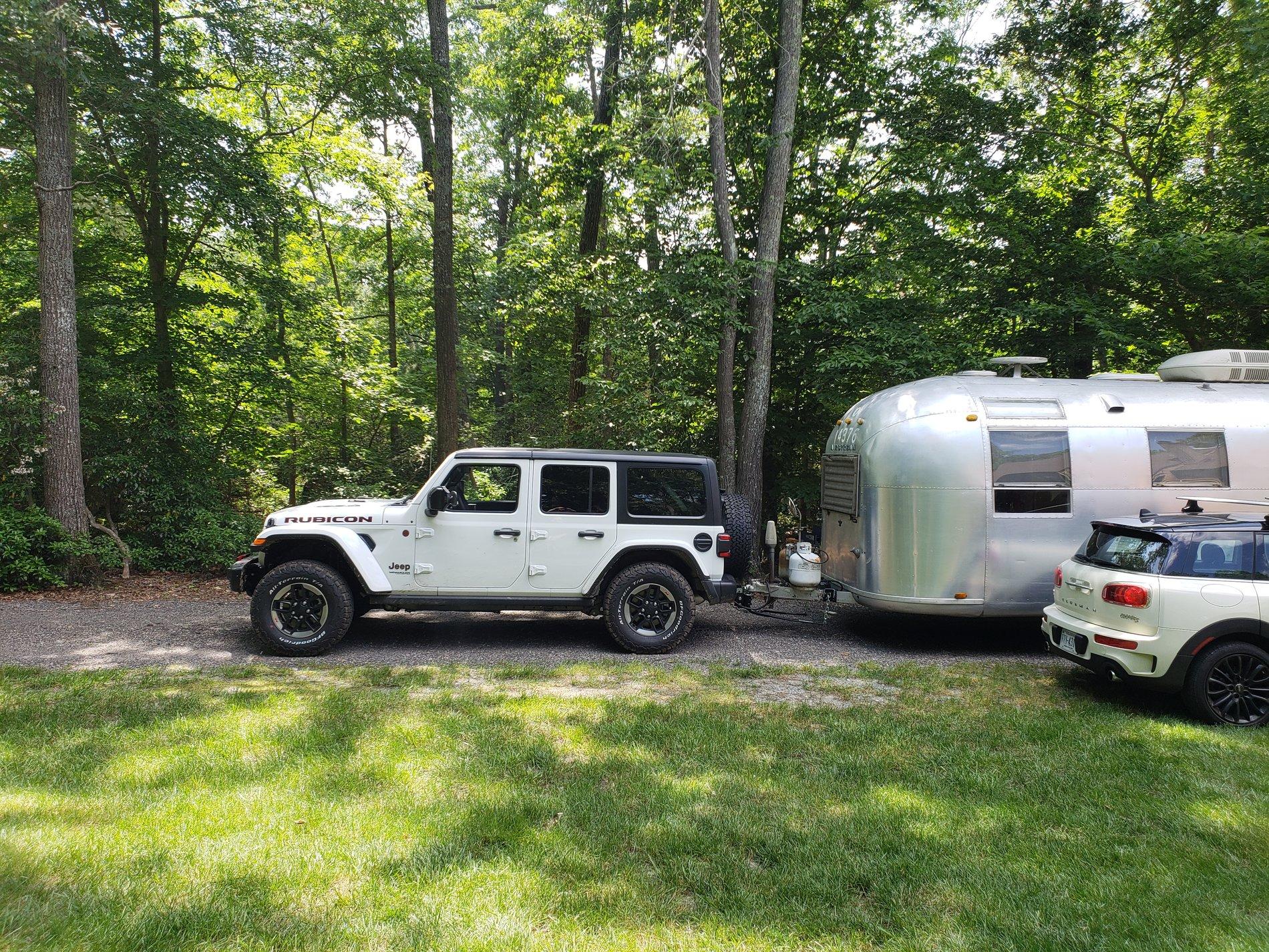

We'll see, I'm taking the airstream across the shenandoahs this weekend with the gladiator. Given the JL didn't struggle, I doubt the jt will, though it will be pulling a little more combined weight given the gladiator is a little heavier.
