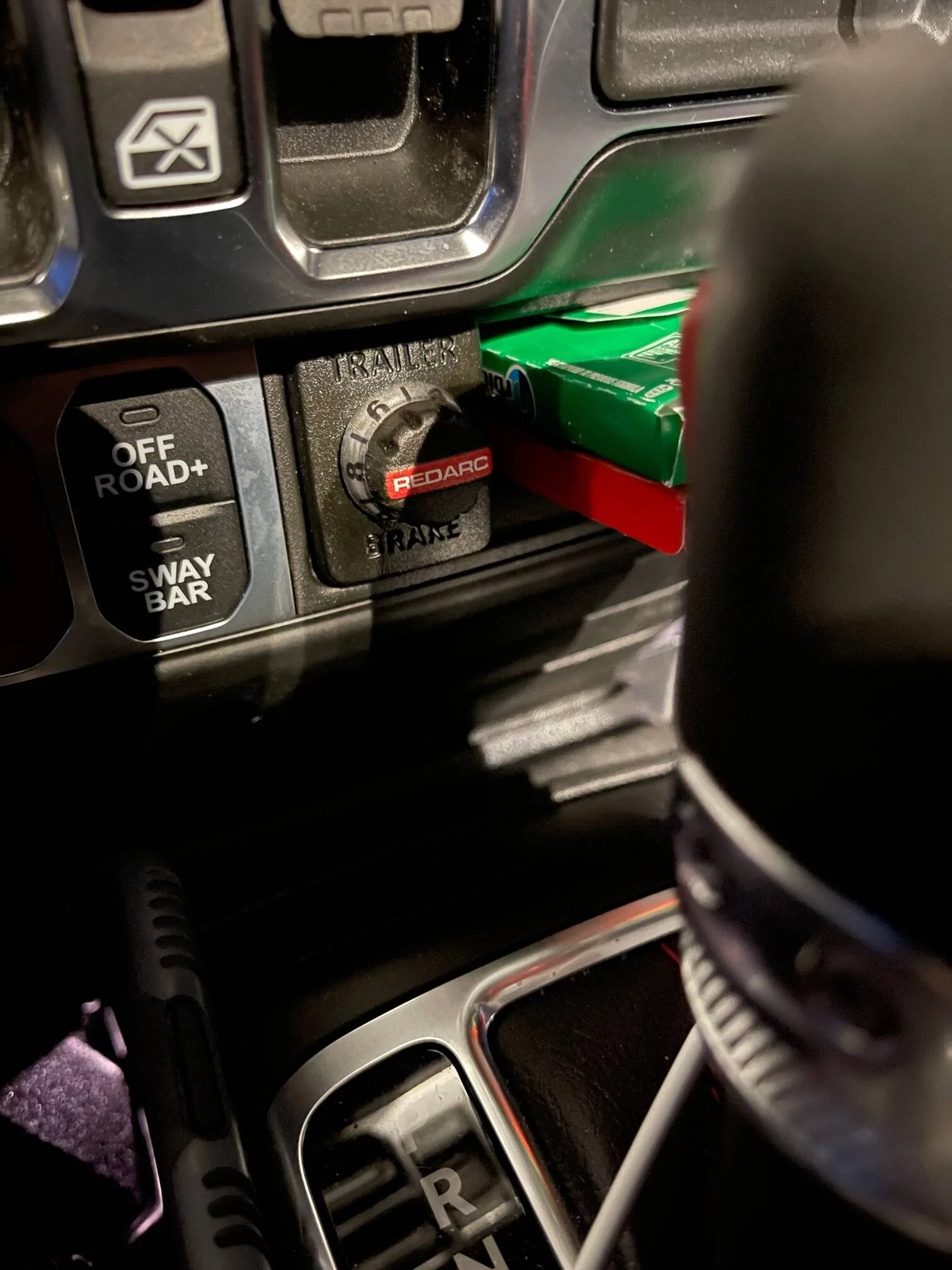

I did the Mopar one in the Wrangler and the RedArc in my Gladiator.
I'd do the RedArc again, because you don't loose the 12v socket and it was easy. I did have to drill a hole in my dash, but it would be easy to replace that small panel if I wanted.
I think it looks clean and is easy to reach to adjust or hit the panic button.
I love this look. Any tips or part numbers I need? I have a 22 gladiator rubicon.

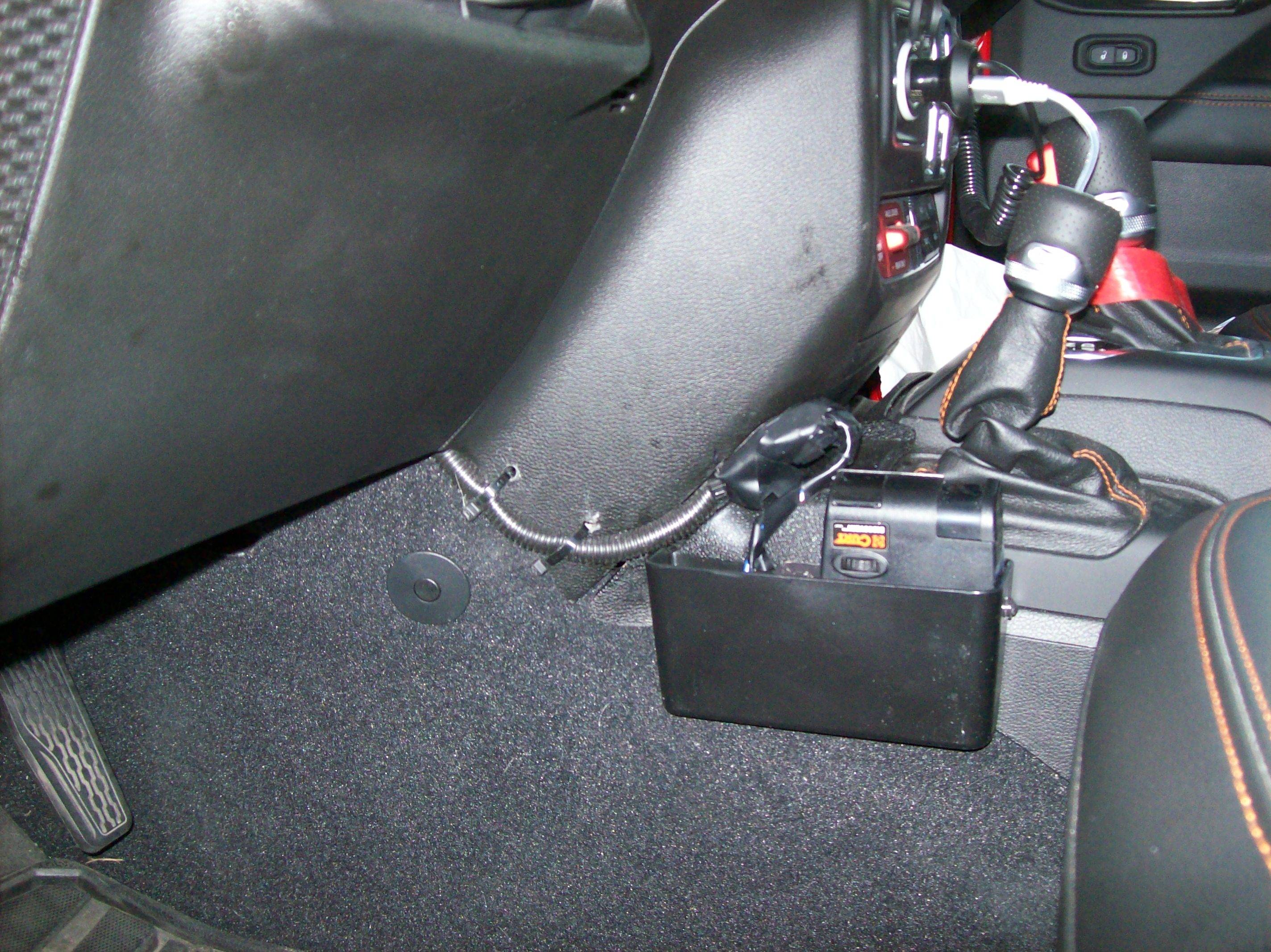

I am running the Curt 51527 harness and 51120 Discovery controller which I mounted in an aftermarket "saddlebags" organizer that fits snugly on the front of the console.

Not sure about that controller, but most aren't meant to be mounted sideways like that.
I didn't need anything extra, just the controller and their recommended harness.
Take your time pulling the center console apart so you don't drop any of the clips. There are a couple ribs on the back side of that panel I drilled that will need snipped to make a smooth mounting surface. You'll see what I mean when you get it apart.
Pretty easy overall. I'm not the only one to do it like this. Just take your time.
I do love this install verses the Mopar one that takes the place of the 12V plug.

The Curt manual shows three drawings, horizontal, vertical, and any angle with all being acceptable. It is electronic, so there is no pendulum inside to sense deceleration of the vehicle. Hence, mounting position is not important.
