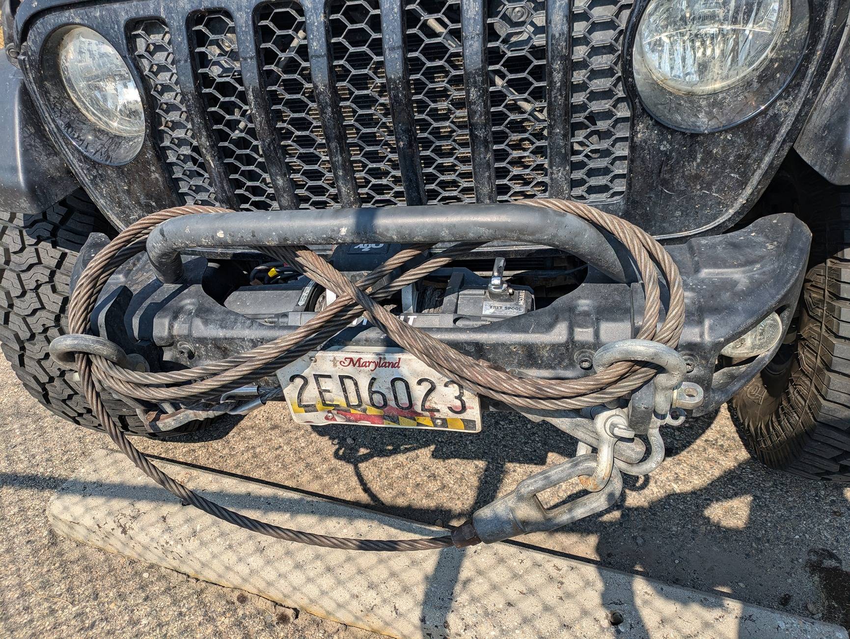

Here's everything I bring, by all means not a list of requirements but I can't say there's anything here I haven't ever used out in the wilds.
Let's start up front shall we?
Jeep Gladiator What are the "Must-Have's?" PXL_20240906_195934240
1x 12000lb Winch
1x 25' 10t WLL wire rope assembly
1x 7t WLL shackle
2x 6.5t WLL shackle
2x 3.75t WLL shackle

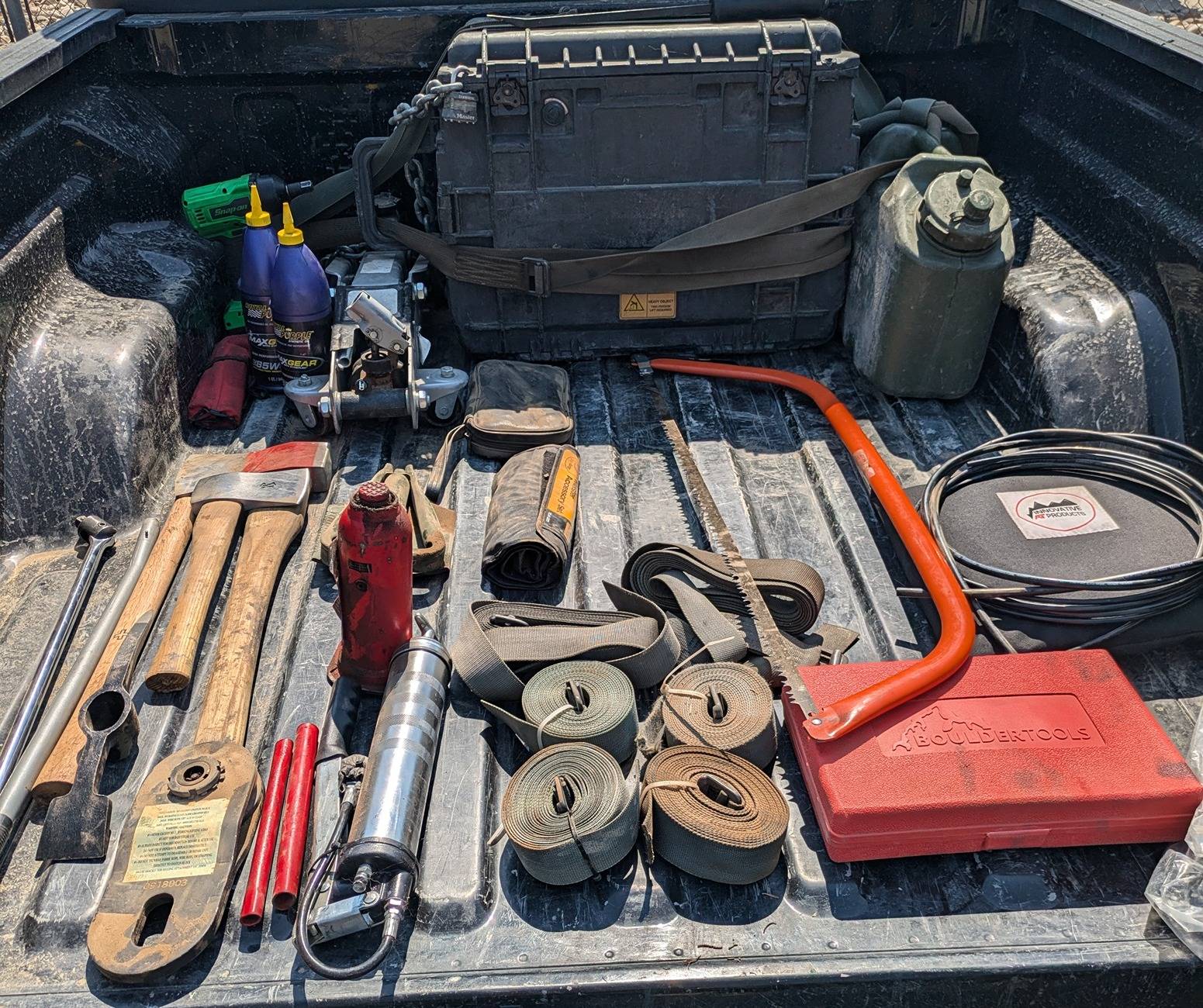

Moving to everything that gets stored under/behind the seats or lives in the bed:
Jeep Gladiator What are the "Must-Have's?" PXL_20240906_195907953.MP
1x 2.5 gallon water can
1x Mechanics toolkit
1x 3t dolly jack
1x 3/8 impact driver
2 Quarts of gear oil
1x multimeter
1x multimeter accessory kit
1x E-Tool
1x Axe
1x hatchet
1x Pickaxe
1x Half inch drive 30 inch breaker bar
1x 7t WLL Snatch block
1x 10t bottle jack
1x grease gun
8x 5t WLL aerial cargo straps
1x 30 inch bowsaw
1x Tire repair kit
1x tire inflation kit
Buncha spare airline for ARB stuff.

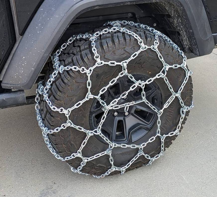

Seasonal:
Jeep Gladiator What are the "Must-Have's?" PXL_20240802_154936171~2
Tire chains
