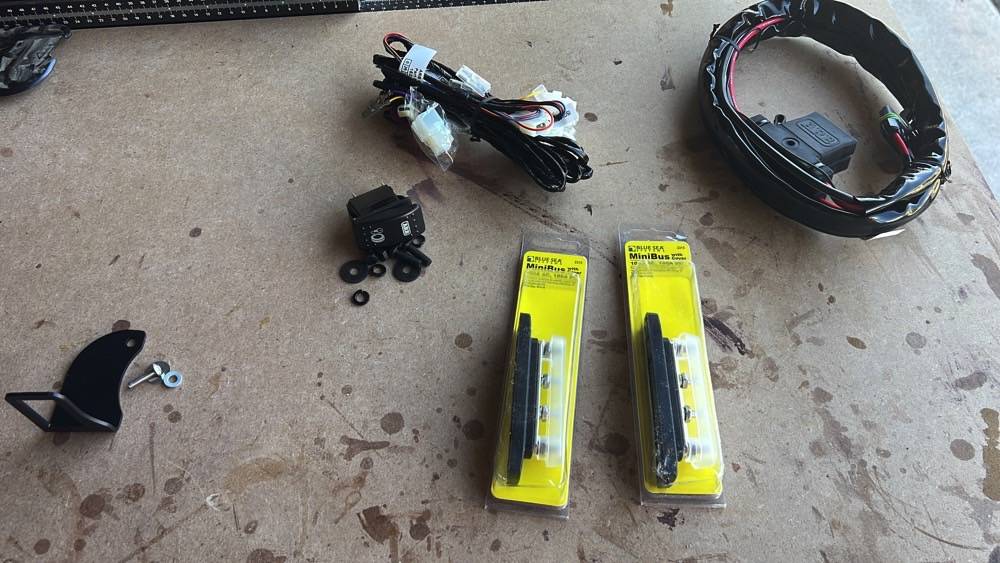

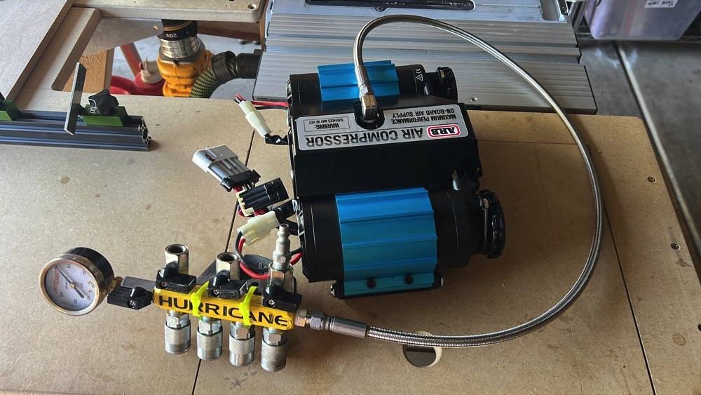

Well...for about 8 years I have carried one of the ARB Portable Twin Compressors in the back of my 2016 JKUR but some jackwagon decided to steal it from me. The insurance paid out the full value of it (State Farm is awesome, they gave me the full purchase price I paid in 2017) and so I decided it is time to hard mount a compressor like I did in my 2020 JTR.
So I gathered the necessary parts:
Jeep Gladiator What did you do WITH your Gladiator today? WranglerCompressor_01

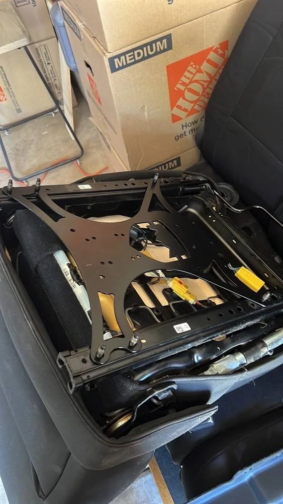

Removed the passenger seat and added the Teraflex mount (not bolted yet in this pic):

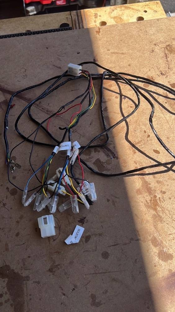

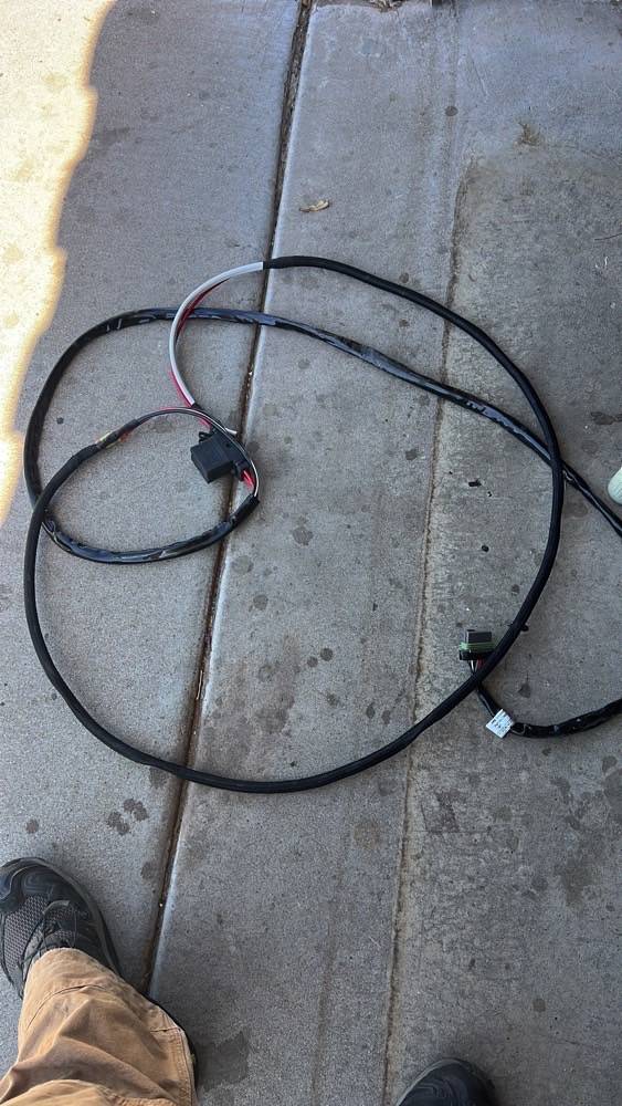

Removed this much cr@p from the provided ARB harness (for those that don't know, the ARB harness comes complete with everything you would need to run air lockers and I didn't need that wiring):
Jeep Gladiator What did you do WITH your Gladiator today? WranglerCompressor_04
Built the power harness to run up to the engine bay and battery:

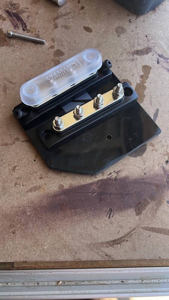

At this point I decided to clean up some of the underhood wiring for my rock lights, light bar, etc. so I made a plate to mount some bus bars to:

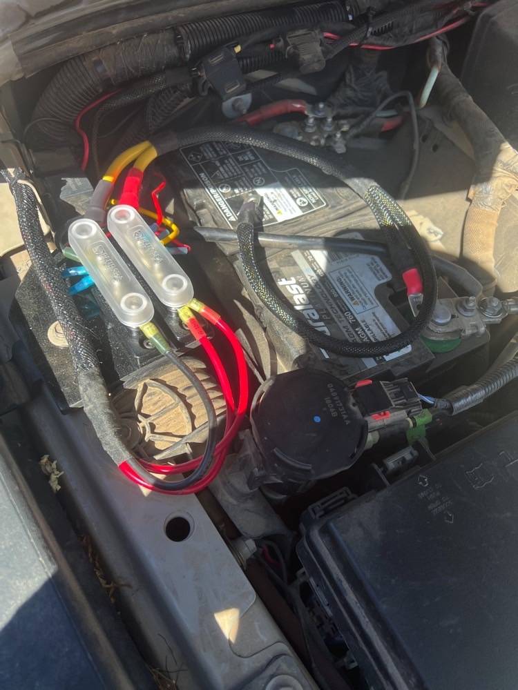

Mounted it in the engine bay and cleaned up the aforementioned wiring (haven't landed the main power from the bus bars to the battery terminals yet in this pic):

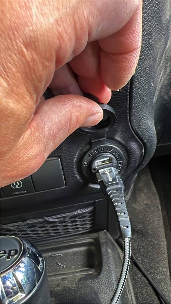

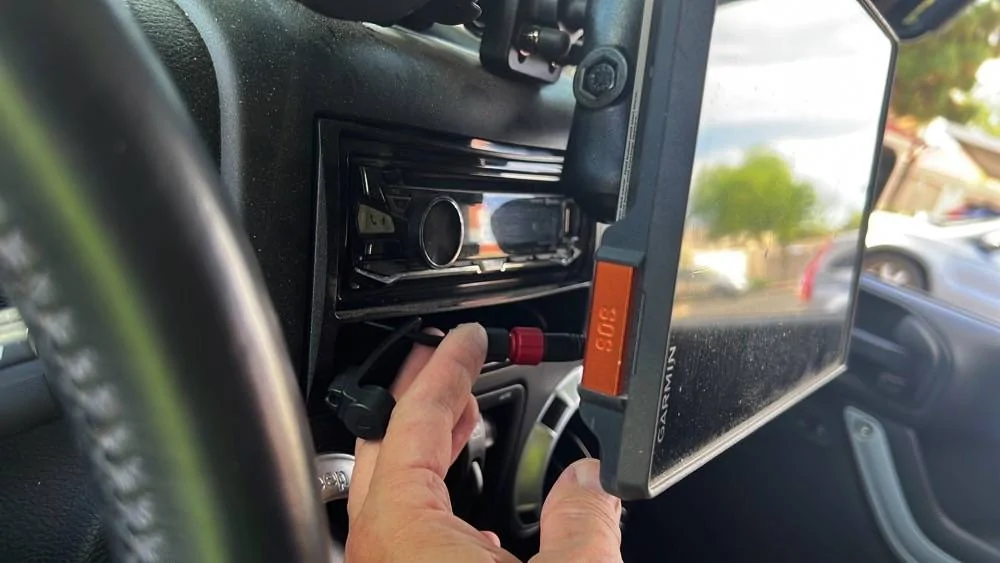

While I was at it, I also removed the "cigarette lighter" and replaced it with a dual USB port:
Jeep Gladiator What did you do WITH your Gladiator today? WranglerCompressor_08
And I also ran hard power through the inside of the dash for my Garmin Tread XL OVerland because it used to run off the "cigarette lighter":
Jeep Gladiator What did you do WITH your Gladiator today? WranglerCompressor_09

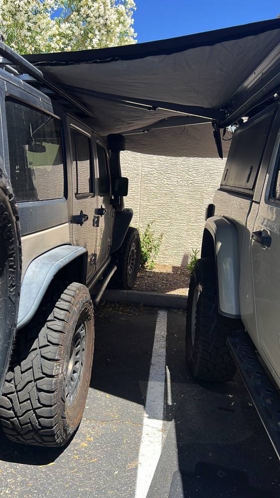

Now if you've gotten this far into the post, you're probably asking "Okay, so What did you do WITH your Gladiator today?"
Well I used it's awning so that I had a shady workspace to do all of the above work!!!
Jeep Gladiator What did you do WITH your Gladiator today? WranglerCompressor_10
LOL!!!

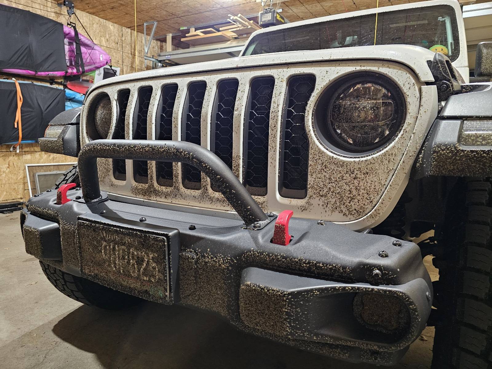

I see you and your bugs, and raise you more bugs... this was roughly a 20 mile stretch. Had to stop and wash windows twice, washer fluid and wipers wasn't doing it.
