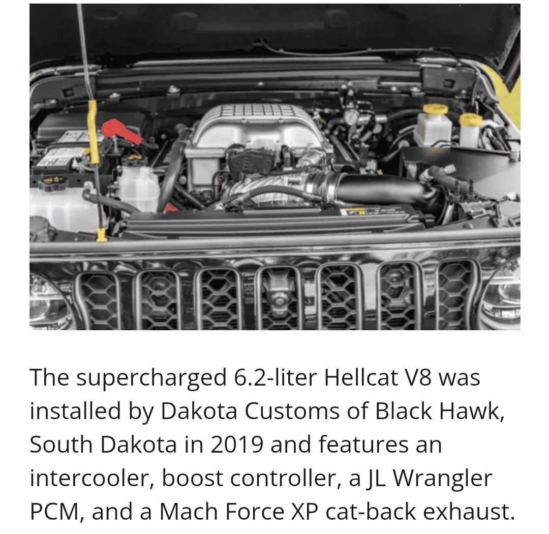

I bought a 2020 Hellcat Gladiator for, what anyone in their right mind would agree is a STUPID good deal. All the pieces are there, asthetically in amazing shape - 13k miles, a really nice truck, no regrets given the price paid. BUT, theres a reason that it was a stupid good deal... it runs like CR4P.
It doesn't start well, it kinda has a mind of its own on throttle, it has huge power delivery problems (under partial throttle acceleration > 3000rpm), the transmission shift points are really inconsistent and terrible for the street. It cruises the highway at 75mph GREAT, but thats not what I bought it for.
The (nationally recognized) shop that did the conversion briefly answered a first email but has failed to respond to follow up emails and several calls. I am still in touch with the seller, he's great, no issues there. He wasn't really up front about how poorly this is running but it was cheap and its not his car anymore - no biggie.
I took the Gladiator to a shop by me, well known for dyno tuning Hellcats, LTA/LT4s... they said they had never seen anything like this. There is no emissions equipment on the car (no cats - I think they were resonators, no oxygen sensors.... etc), the tune on the JT ECU is locked and the fuel system is sort of 'tricked'. The ECU thinks its a 5.7L (according to the tuners) and/or at times a 3.6L; at no time does it think its a supercharged 6.2L.

From the auction description, this was a very early transplant for the JT series.
Probably not the best idea to be near the front of that line.
That said, it's worth getting right and finishing right.
Jeep Gladiator What to do with my Hellcat Gladiator Screenshot_20220924-192142

I think I could probably get this running correctly, but I need to do a through exam. My guess is the electronic bypass valve is not connected along with some of the oxygen sensors. The trackhawk, Hellcat, TRX, all use the same GPEC2 as the JT and JL, just they are connected to more pins on the ECM. I would use the stock ECM with the transmission as the integration is pretty decent once it is working.

Yeah... there was a "custom tune" in this one to 750hp instead of 707... perhaps it is just as easy as putting a new ECM, from the original builder, with "stock" Hellcat configuration and a new exhaust? I would love to think so but... (see my response to Dave, below).
If you don't want to deal with it anymore, be happy to trade you my truck plus cash. It is a supercharged 3.6L, but it runs very well and has had all the demons excised.
Dave, I have been reading a lot on engine/programming issues... you appear to be one of the foremost experts here. Thanks for taking the time to think about my issue(s) and respond. I am not quite ready to throw in the towel yet but I appreciate your offer.
FYI- there were NO oxygen sensors in the exhaust on this truck when I picked it up... AMW told me that the O2 sensors, intercooler and electronic bypass, along with some other fuel related stuff, are the reasons why this doesn't run right... they haven't done an in person diagnosis but suggested they had seen this before.
