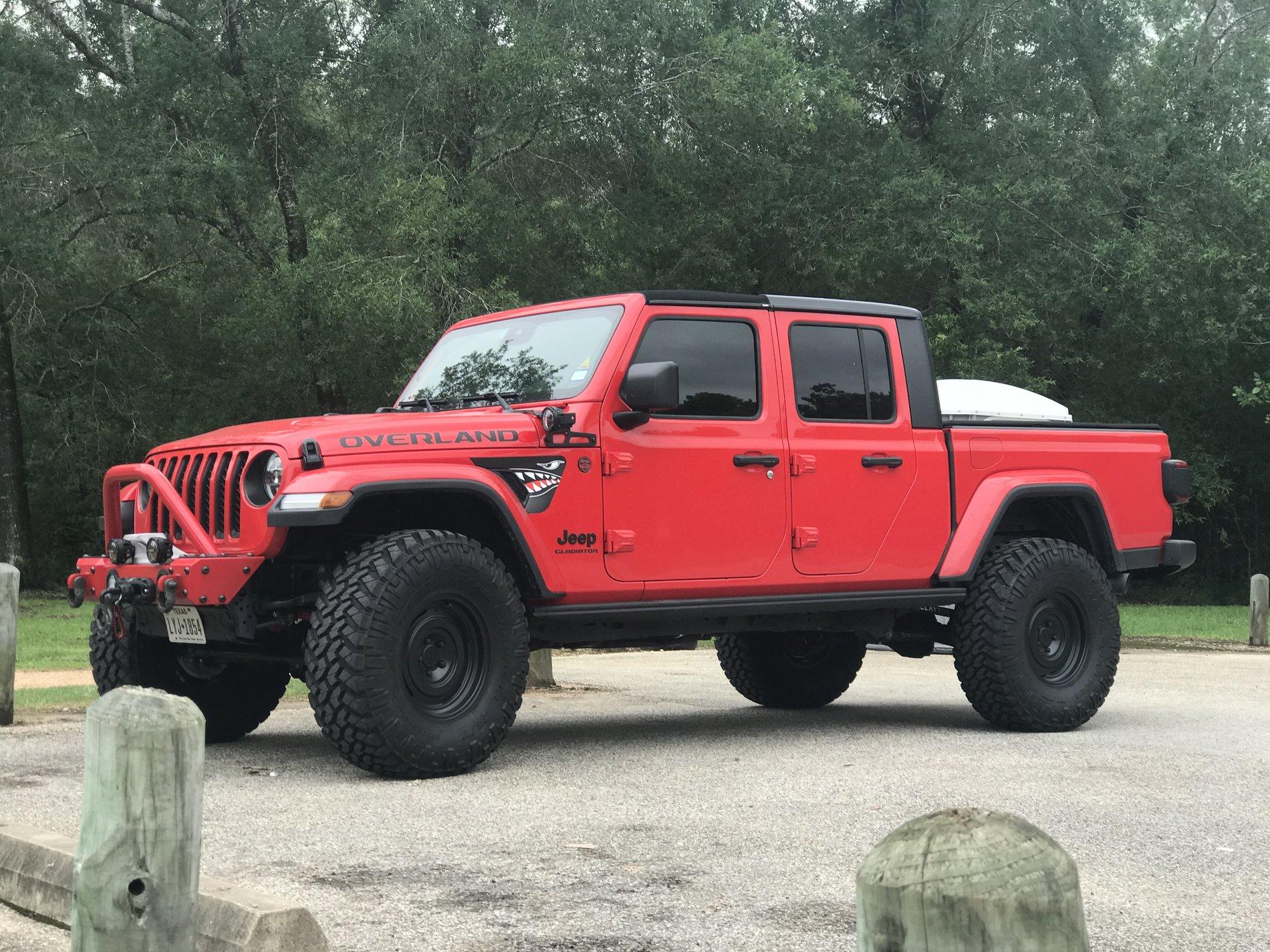

I just evolved my lift from a level kit to a Franken lift. Lol mostly Rockkrawler 3” front and rear springs & rear RK track bar bracket & adjustable track bar , JKS front lower control arms, RK rear lower control arms & Clayton rear upper control arms, evo bump stops, RK rear sway links, JKS front discos, EVO rear brake lines, Yetti front track bar , synergy Drag-link , synergy track bar brace, RPM aluminum tie-rod, Tom Woods rear driveshaft, King shocks. A unbelievable ride . Way better than stock. So there is a lot of good lifts out there that will fit the bill. I had Metalcloak on my JK and it was great but made for a lot of extra weight & rode firm. I have a lot of guys around here going RK so I went that direction. So this lift has the built in rake and when i hooked up my 5000# camper it did not sag it sits level before i even put on weight distribution rods on.
Jeep Gladiator Which Lift Kit to Pick From 1A811F52-81BD-47B0-9945-227B82BDE4FF

Looks pretty dope!!! I'm sure a lot $$$ as well! I need to find a way to piece one together but in steps. I would like to start at a 3.5 in lift, would consider 2.5. I need to start bare minimum tho. I definitely want to go with shock and springs and front adjustable track bar. Then eventually get adjustable front lower adjustable control arms then uppers. I actually considered going RC and add the lower control arms (non RC). Any thoughts on that? Or any other recommendations that would be affordable to start with?

Well i built as i went along yes that is fine to do. I had RK front springs & some 1 1/2” lift fox shocks with extensions. And had Rubicon rear shocks & springs with 3/4” spacer. Also had the front adjustable track bar. Then used JKS lower control arms. It rode fine no issues. Then i just kept adding as i went.
