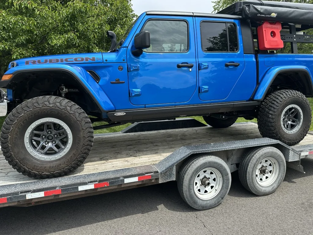

I tried adding a supercharger, but after bolting on two separate Vortech units, I am still hearing the strange noise in the attached video. All I really wanted was to get the truck to cruise comfortably long distances. I live in Kentucky, but explore with it in Colorado, New Mexico, Utah, Wyoming, and similar western destinations. Trying to battle the winds of Kansas and Nebraska is just mind-numbing. That Pentastar is just not up to the task. Oddly, when off-road in low range, I find the little V6 to be ideal everywhere below 12,000 feet. I was struggling a bit at 13,000 once.
After talking with AMW and RubiTrux, and considering doing it myself with help from Jeep Speed Shop, I settled on a brand-new option. My preferred shop, High Lift Off Road in Cincinnati, has completed nearly 100 AMW swaps and does specialized work for Jeep through Stellantis. After waiting too long, too many times for parts, they designed their own Hemi swap. It is close to the AMW swap but has some neat differences. It costs a bunch less, too.
I will detail the process on this thread and add a reader's digest version on my build thread, which has over a thousand posts already.
The JT was trailered away today for the short 1-hr trip to the shop. I would not drive it because I just do not trust the integrity of that supercharger. I only drove the Jeep a bit more than 3 miles because of the sound it makes. When they pull the motor out, I will remove the SC, then sell the engine, which has something less than 20K on it.
