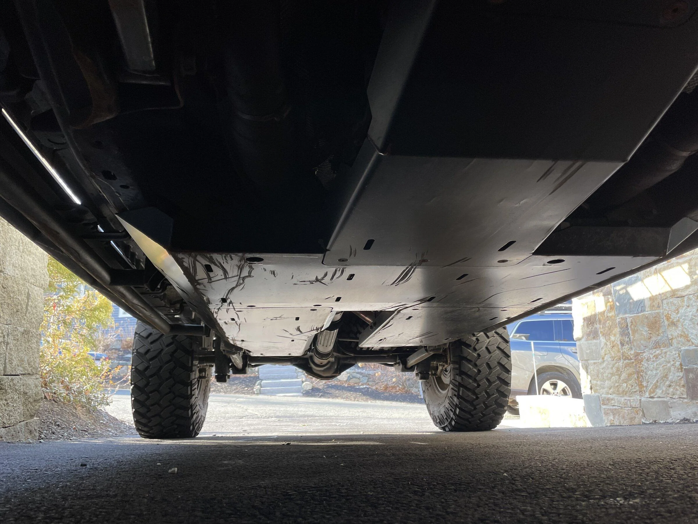

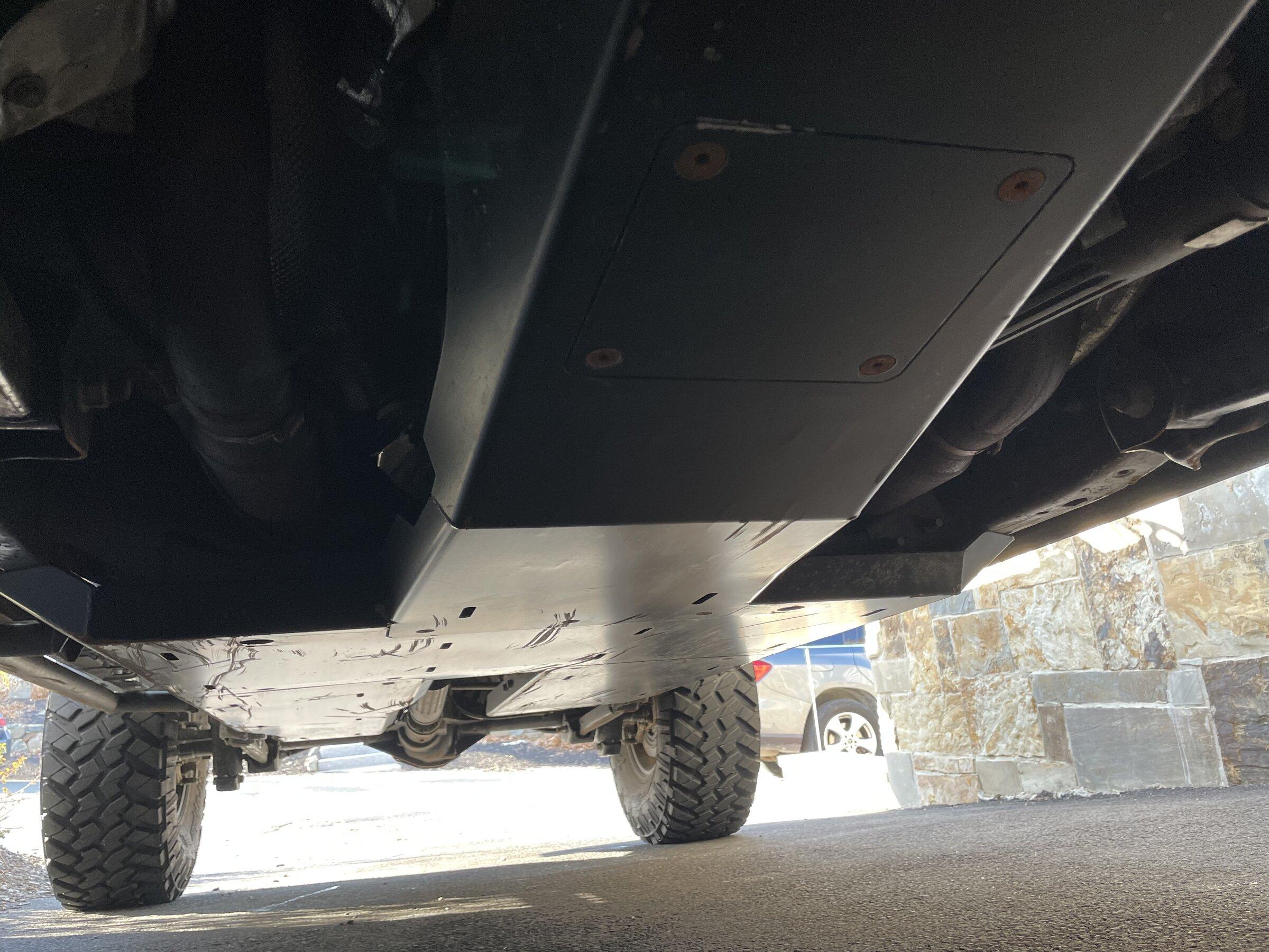

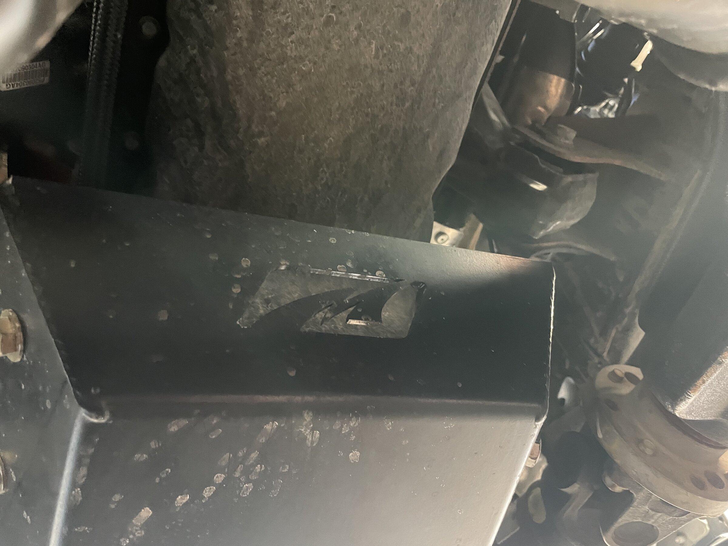

I put the full motobilt steel pan under but was also considering artec after I scratched the oil pan.'Lt what you asked but my point don't be afraid of the full belly pan :)

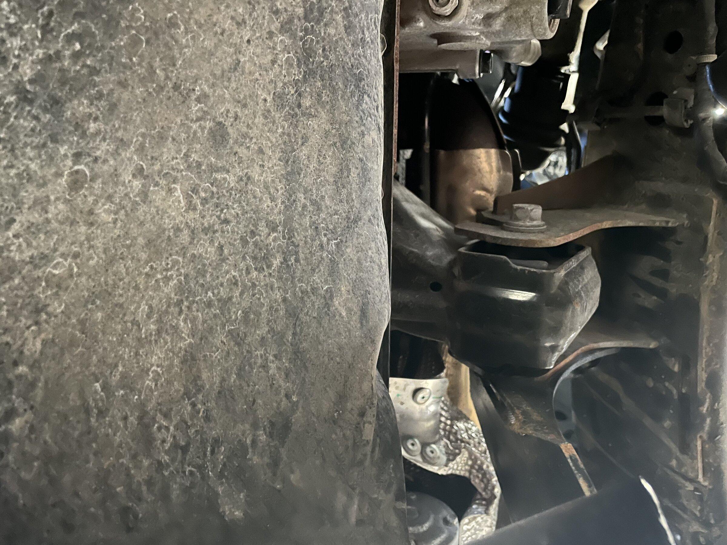

Well at the $2000 mark for the full skid, I want to at least get the engine and transmission protected. Then maybe move on with the other parts.
So you are saying that the engine skid was able to mount up? What all was done to make it work and what was done on the motor mount straps. I have been looking at it but without pieces in hand sometimes makes it even harder to "see" if they would work.
Let me get under the truck and try to do a video. It's also completely bolt on and off.

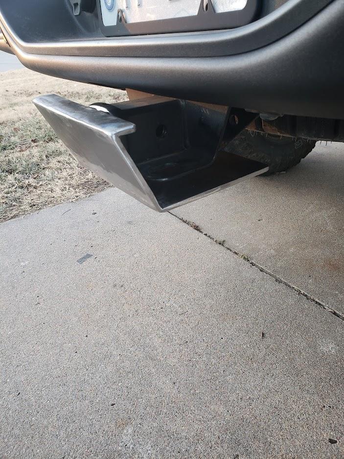

Made this today for the hitch. Couldn't see spending up to $200 for one when I had the materials to make my own.
Jeep Gladiator 5.7 Hemi install hitch skid

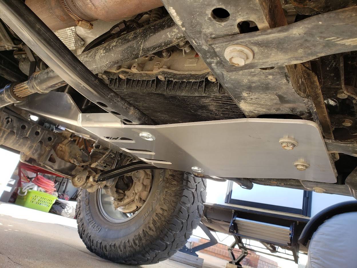

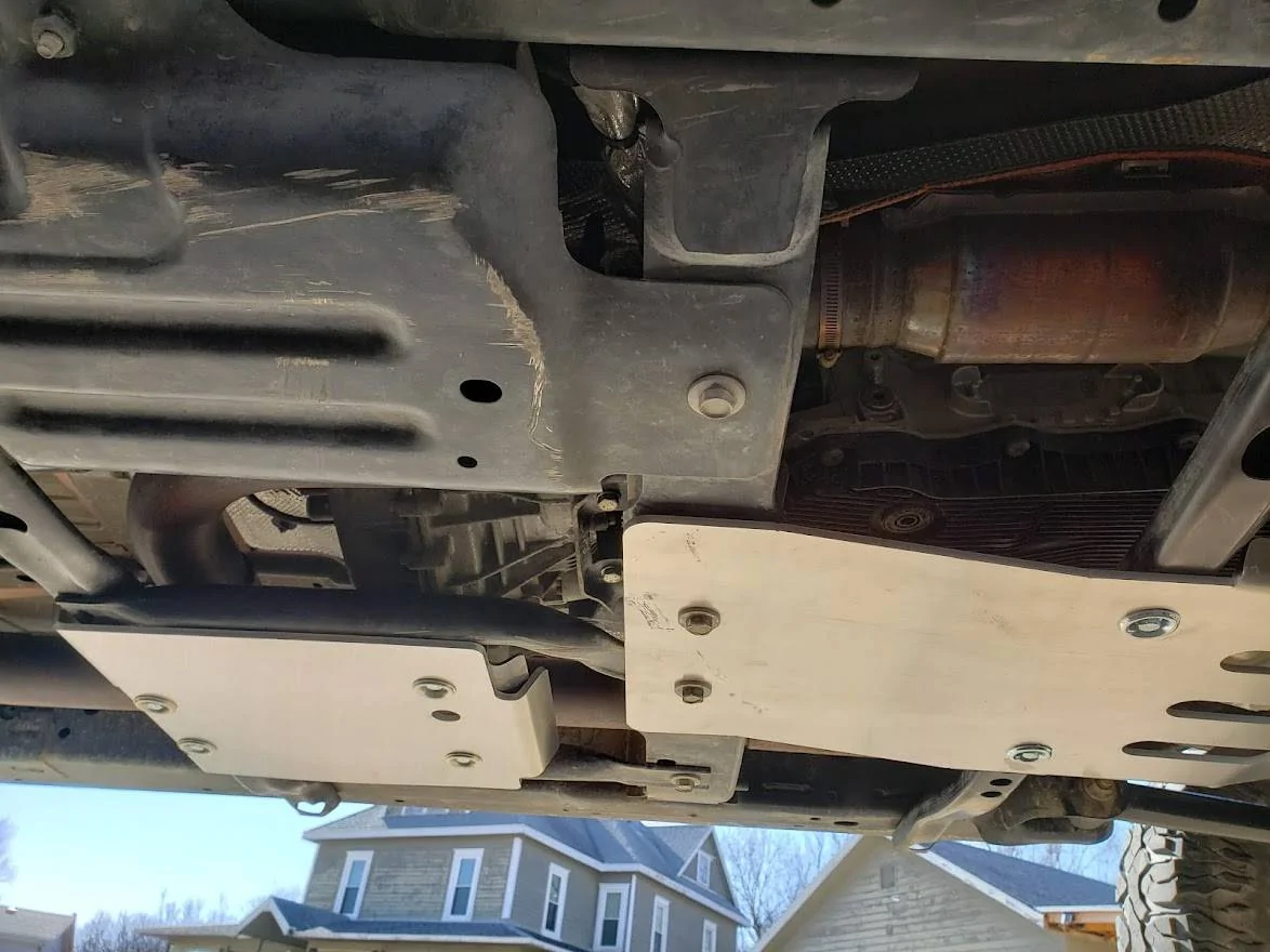

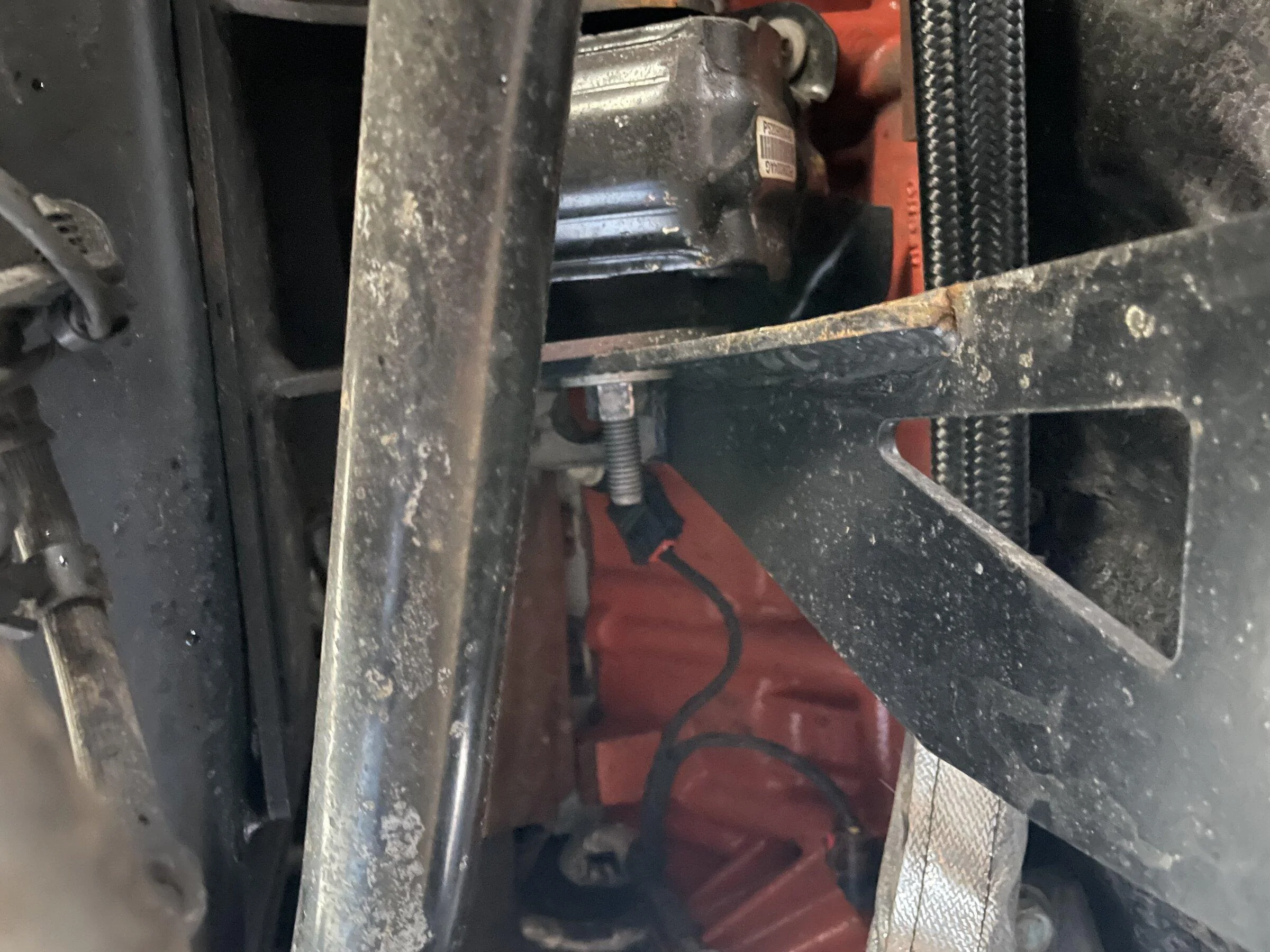

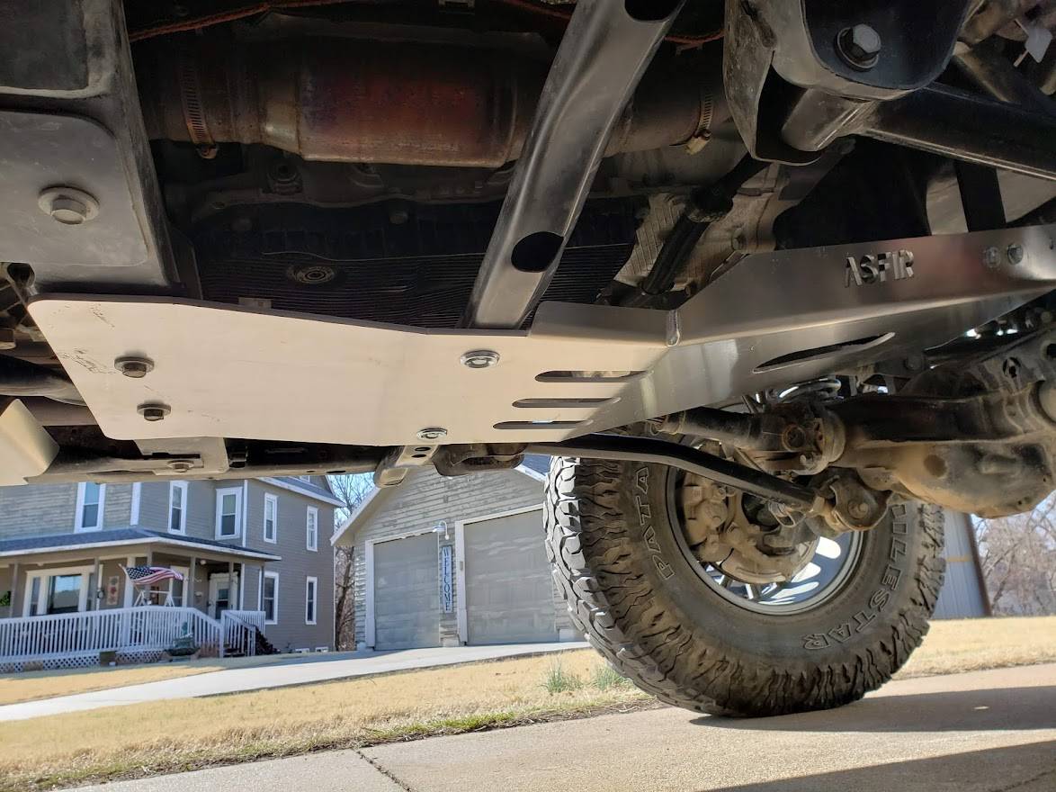

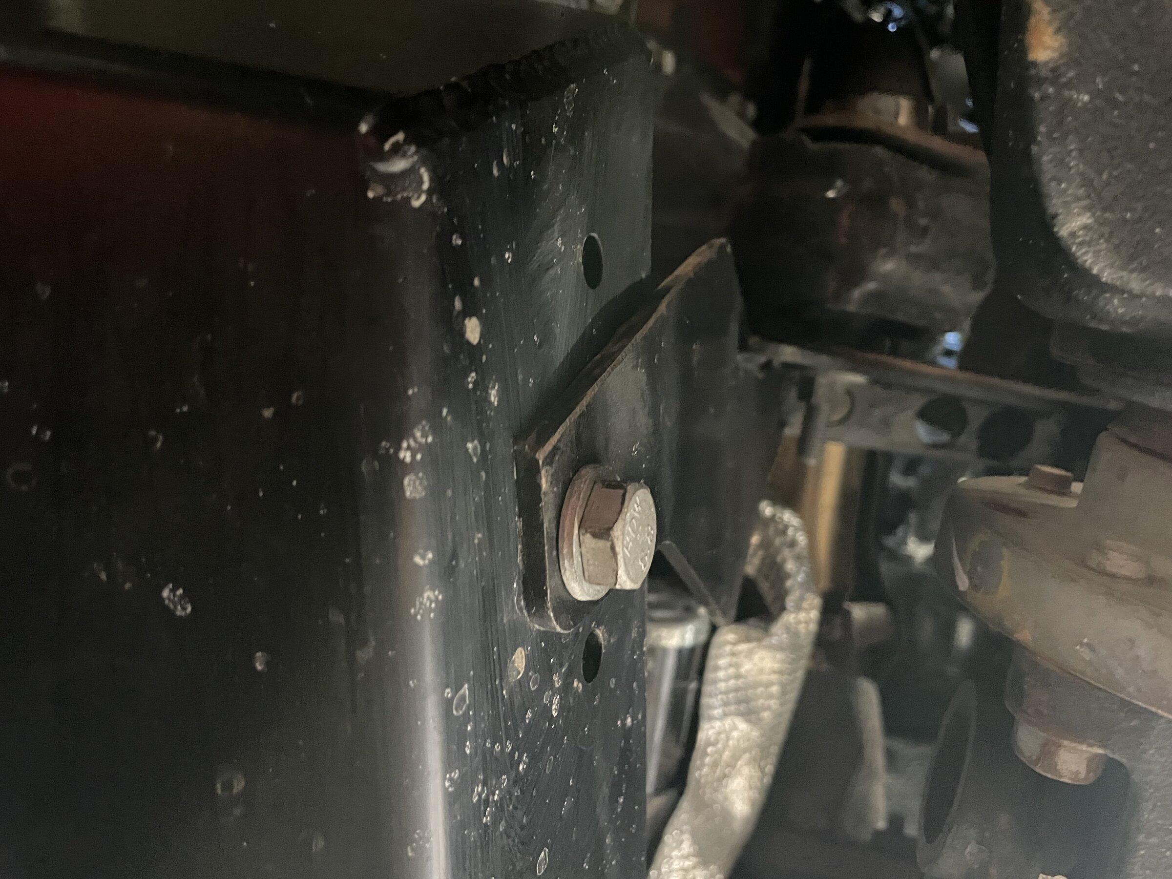

Well after a year I realized I never responded back to @shrinkhead. I ended up getting the ASFIR engine, transmission and transfer case skid, modifying the mounts and opening up the oil drain plug area and it fits perfectly. Thanks for your pictures, they helped a lot.
