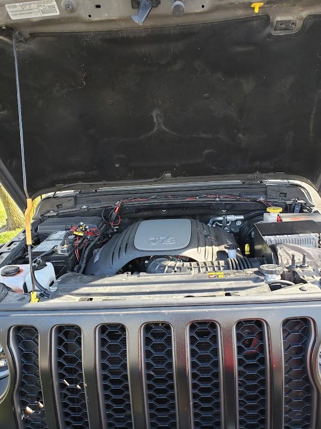

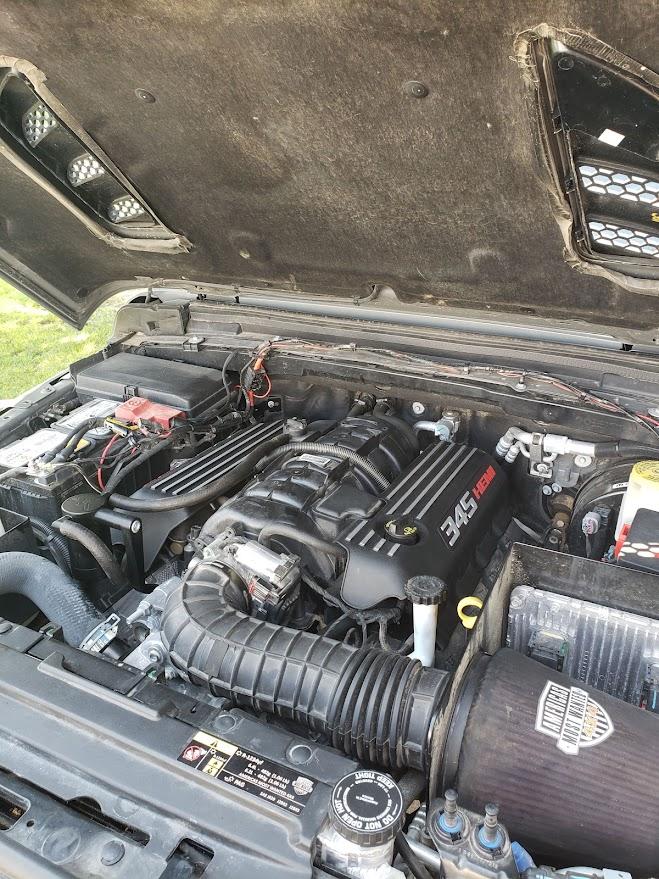

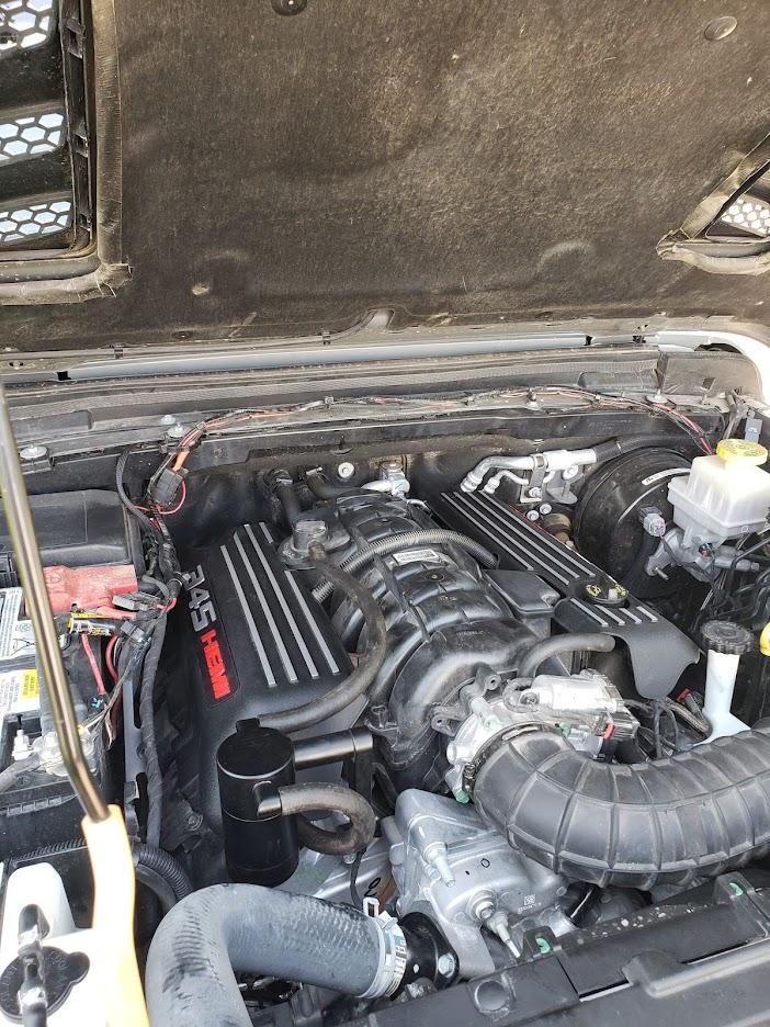

Just some cosmetic upgrades to the engine bay. I never did like the engine cover that they put on the 5.7 unlike what they put on the 6.4's. So I got me some 3D printed emblems and painted them and improved the looks of the engine bay. Plus added a oil catch can, not sure if needed or not but had one laying around so thought what the heck.
Very impressive. I certainly respect anyone with the mechanical prowess to do something like this.
I get excited that I can change my own oil......... :LOL:
Any HP gains. Sure looks faster now!
