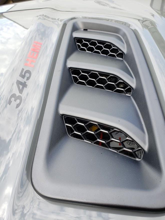

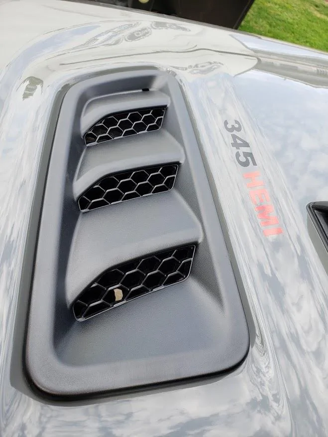

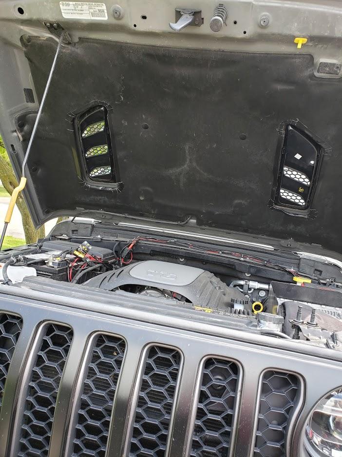

Still loving the way the JT drives with the 5.7. No real issues either and still waiting to pull my camper. It seems that it is either storming or in the 100's temp wise around here. Will be heading to Colorado in August so that may be the test.
I did end up opening up my hood vents and made them functional. No numbers to show if it has made a difference or not in any temps but it makes me feel better!
