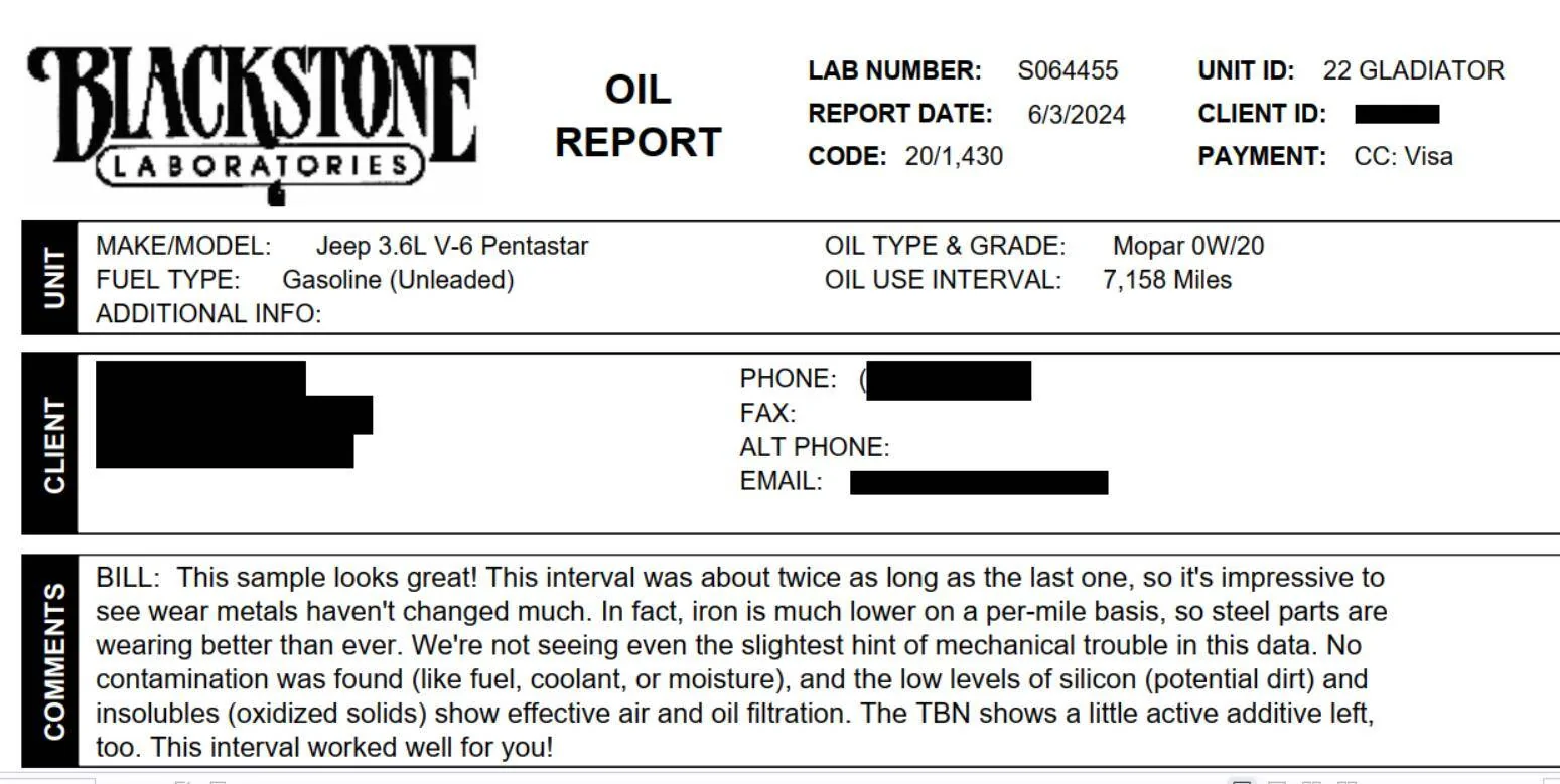

I just can't bring myself to run the oil much over 5k. I just changed it again, with 5,200+/- on it while the oil life indicator was at 41%. Anybody else stuck in this mindset? The whole "it's cheap insurance" thing is something I've subscribed to with all of my vehicles. But in this era of rampant inflation, I"m considering extending service intervals on everything but I seem to have a mental block on this, especially with this particular Jeep.
I have zero issues going 7,000 if I have not hit "extreme service" like heavy hot towing, that sort of thing.
There are people that do go the 10,000 miles - and don't have any problems at all.
It's YOUR call, of course, but I also look at it this way - my owners manual collection dates back into the 1940s and those in the 1970s were recommending 7500 miles with that old school oil, carbureted engines with crappy chokes, rich idle mixtures and so on - if a 1973 V8 with the oil from back then with an engine that wasn't nearly as well engineered and as clean running as these are can do that, why can't these on modern oil with extremely well-controlled fuel mixtures, no running on a choke making gas run into and collect in the intake manifold....
These run extremely well controlled mixtures, there's very little fuel contamination in the crankcase, they run them warm enough to burn out condensation and the moisture of combustion that does get by the rings. My oil test results prove I'm doing just fine - 7,158 miles on that change. The oil life indicator, which is extremely accurate in collecting the information as far as idle times, hot running, towing and so on, said I was about 20% left. The results in this snippet also suggest as much.
It really and truly IS science.
