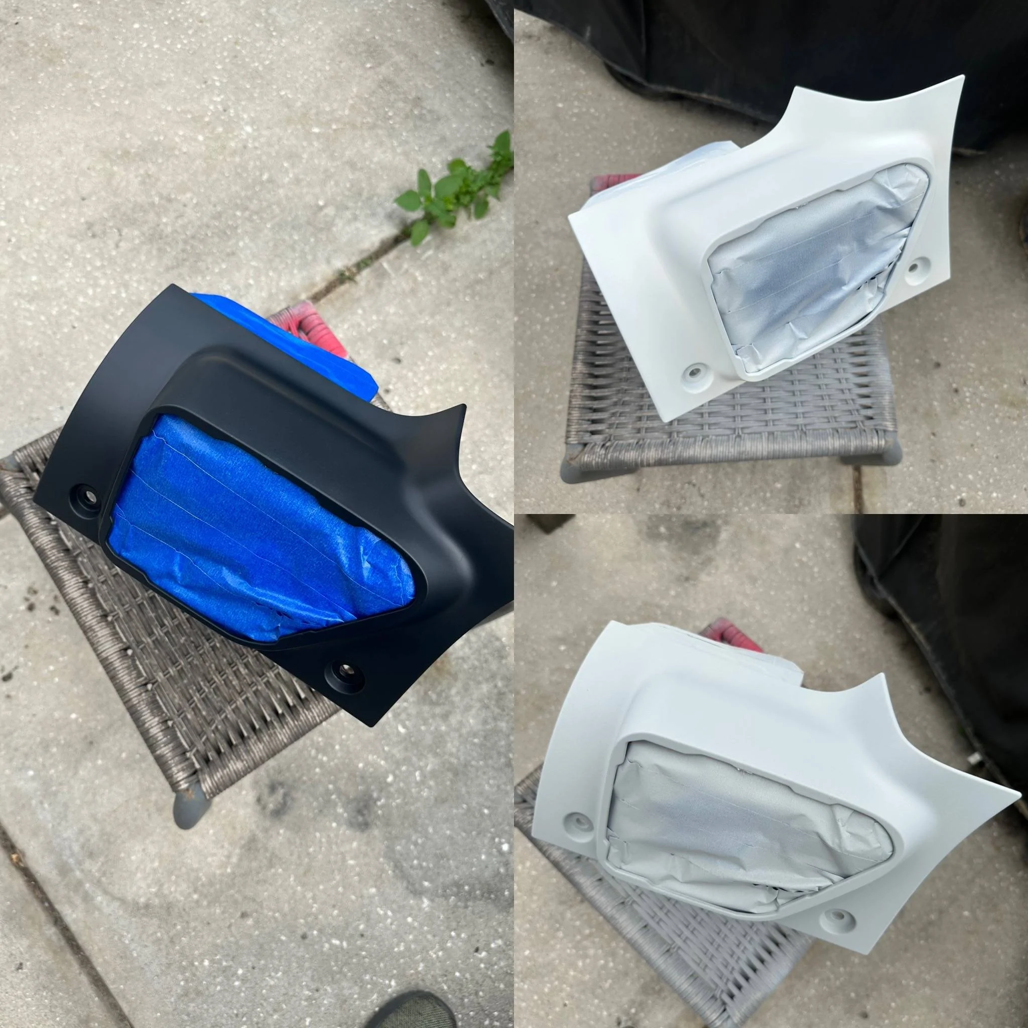

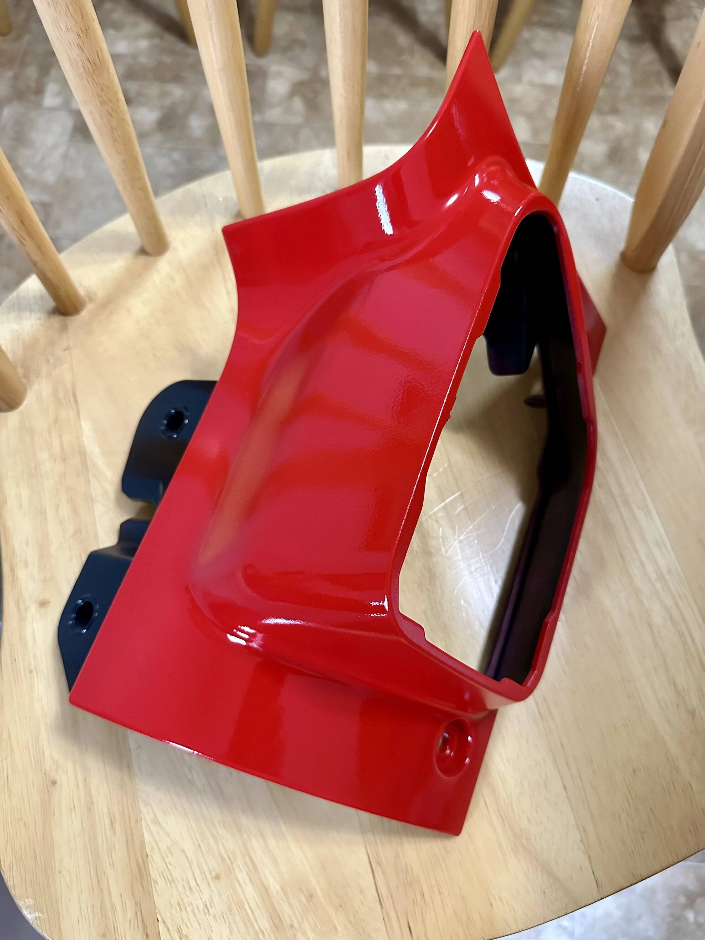

Cowl after I colored matched it and installed the conversion kit. The paint I actually found on Amazon because the firecracker red would not be in stock for another 2 months when I went to order some. The color is extremely close but if you are a painter (I am not a painter) you can notice a very slight difference. From what I was told, it has a slightly more orange tint to it(The one who noticed it paints cars for a living but no one else noticed). Over all, it's a really good match I think. This was also primed on my back porch and then painted in my garage (very professional I know lol). I did get some orange peel but to be honest I am fine with it.
Jeep Gladiator ARB dual compressor rear seat install with 4XE air conversion cowl. B46FEE34-5ABB-48F1-AC4D-39480F2ECBE7
Jeep Gladiator ARB dual compressor rear seat install with 4XE air conversion cowl. IMG_0068
Jeep Gladiator ARB dual compressor rear seat install with 4XE air conversion cowl. IMG_0071

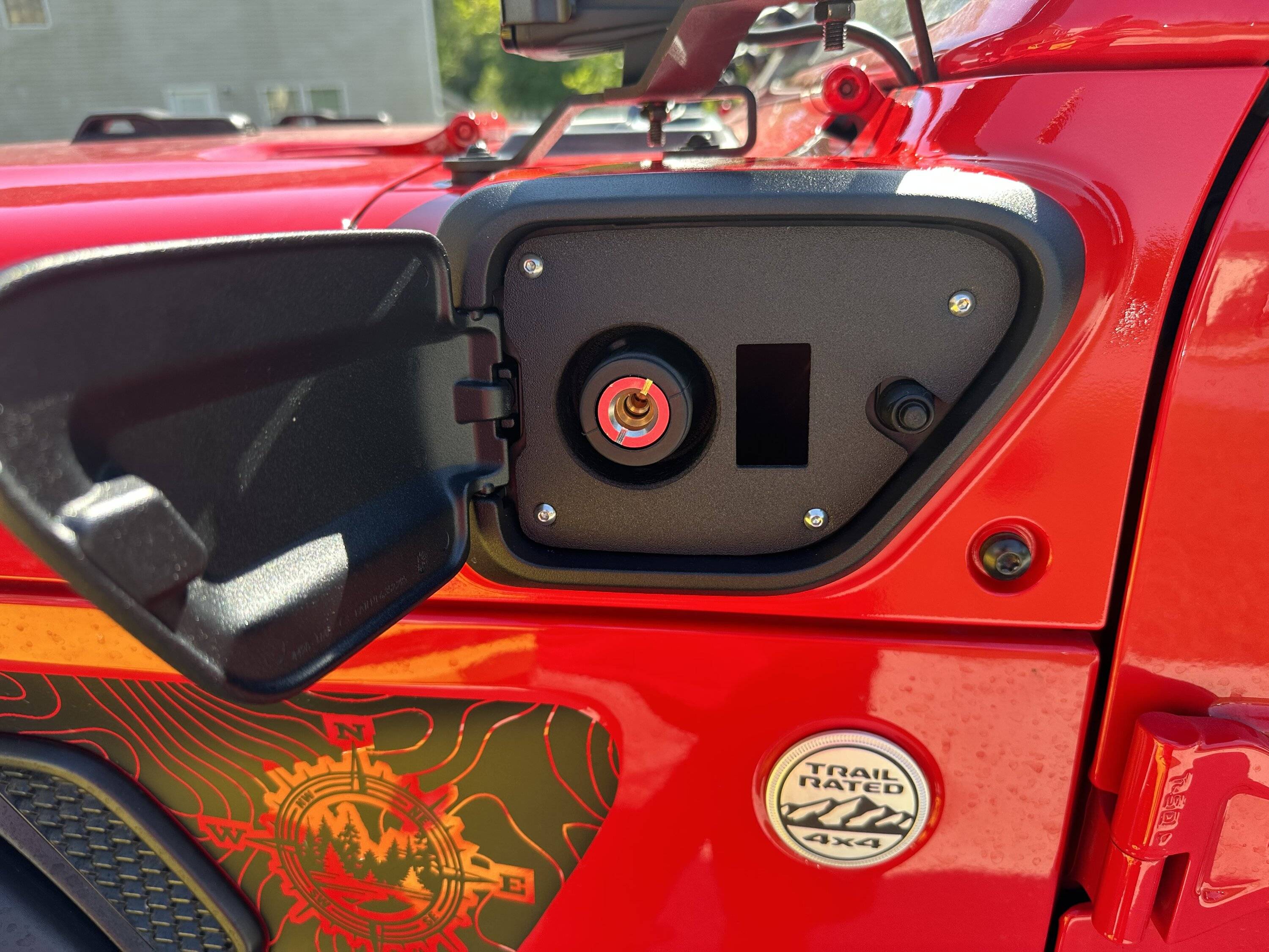

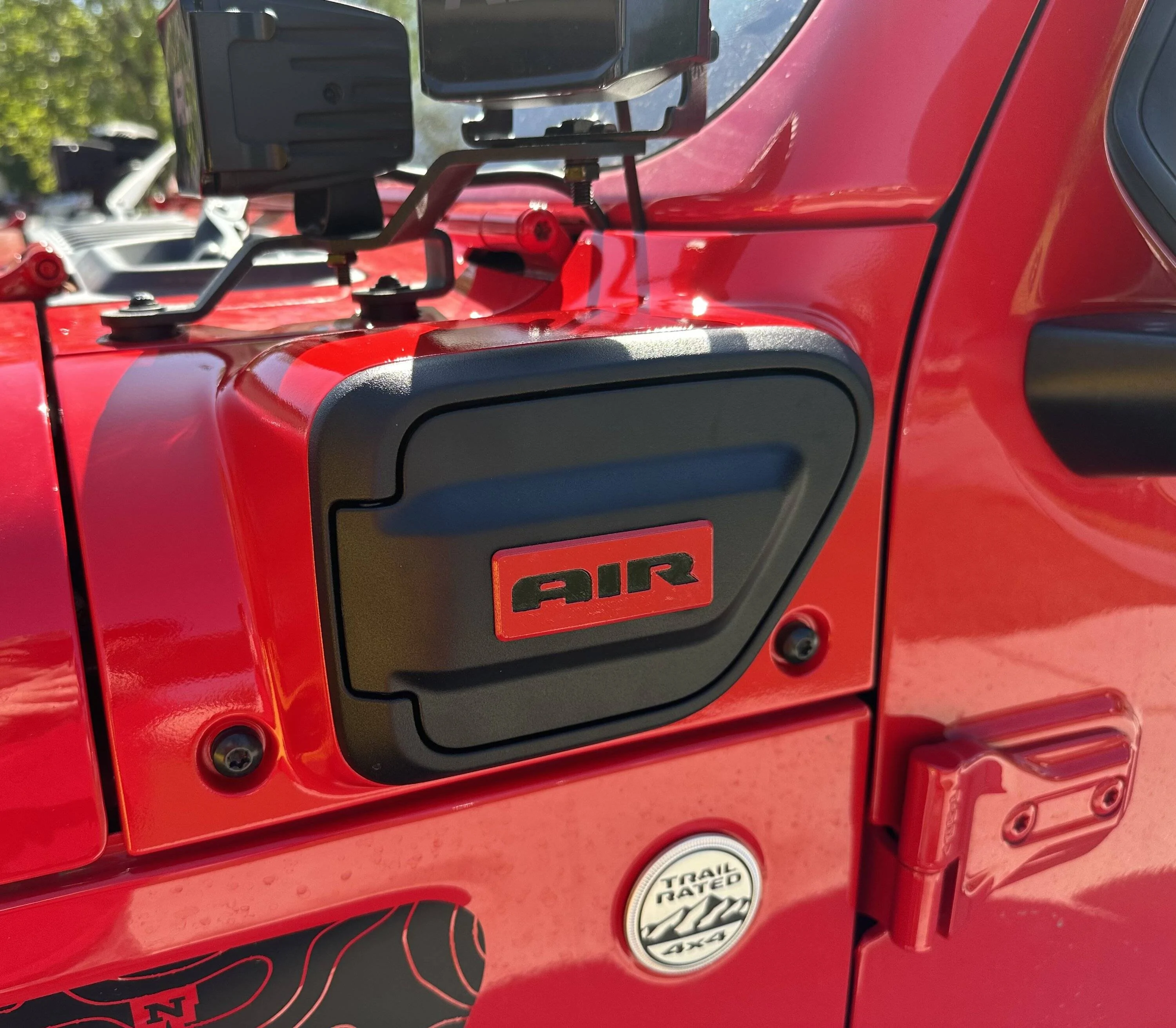

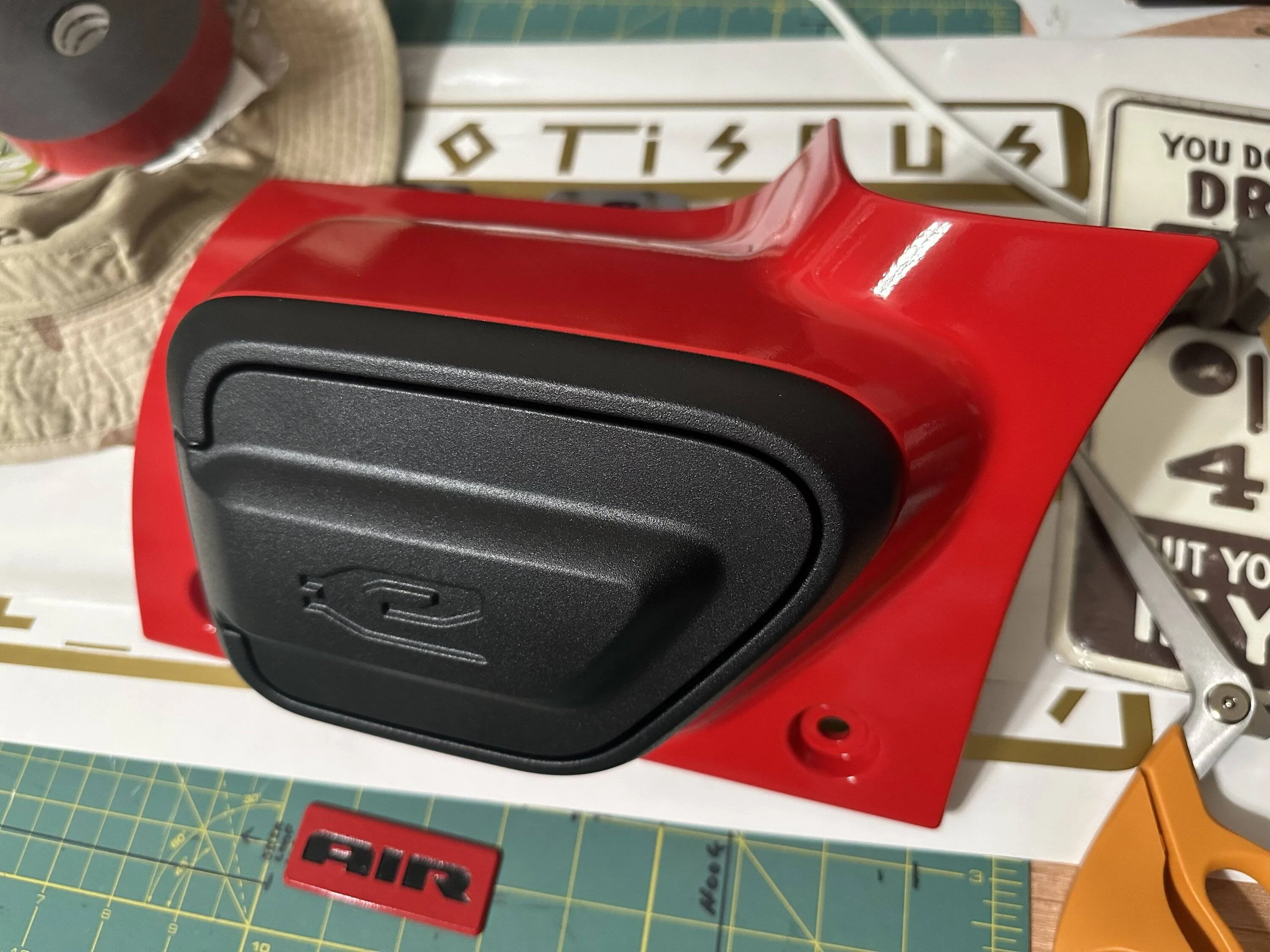

Cowl conversion installed. Switch has not been installed (I will probably use one of the AUX switches instead.) I know, why install it if you do not have everything? I could not wait to see how it looked to be honest. Super easy to install and comes with all the necessary parts. You do have to cut the inner rubber/plastic circle out of the 4XE section before you install the kit (which I do not have a picture of unfortunately).
Jeep Gladiator ARB dual compressor rear seat install with 4XE air conversion cowl. IMG_0080
Jeep Gladiator ARB dual compressor rear seat install with 4XE air conversion cowl. IMG_0081

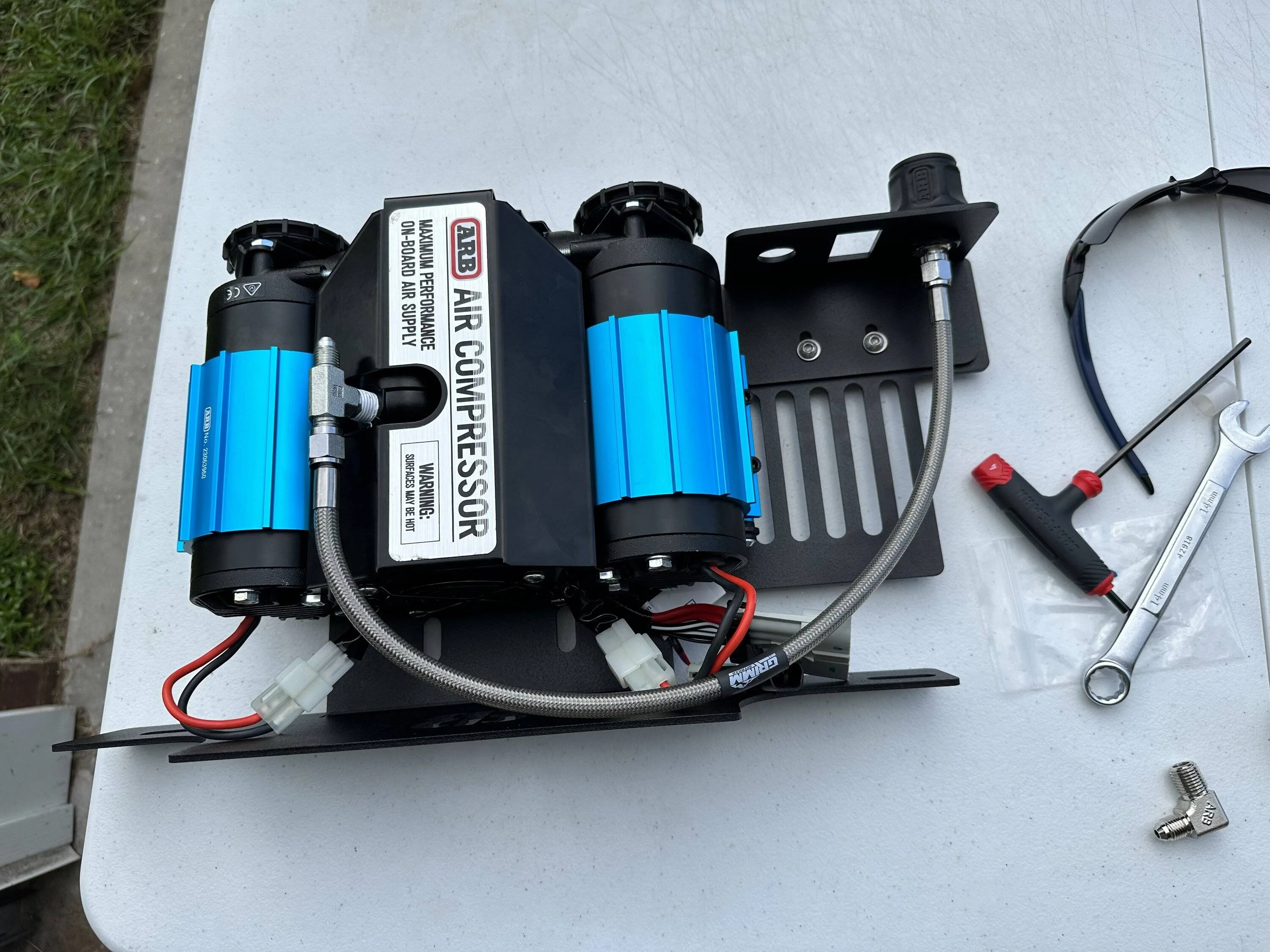

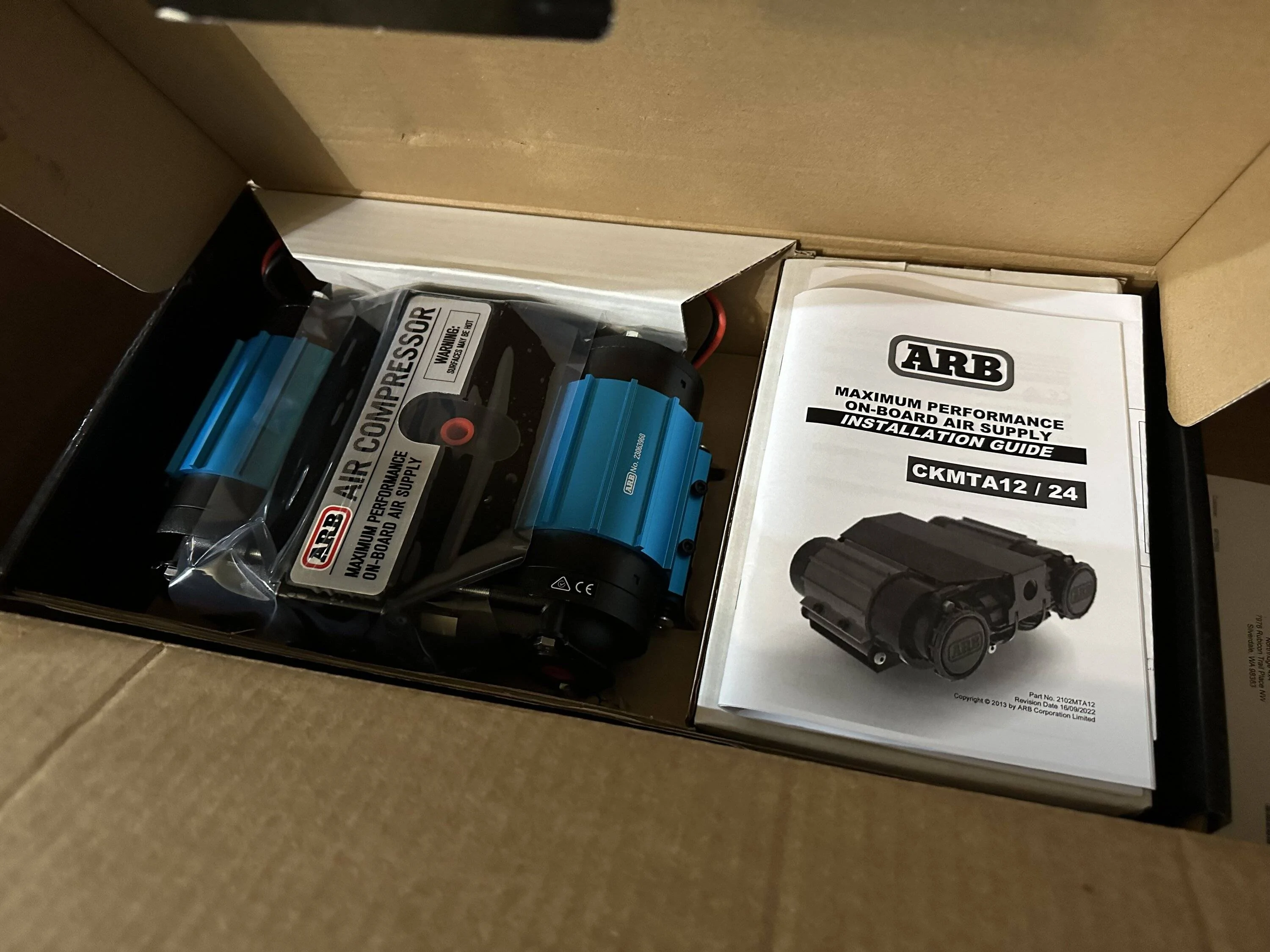

ARB dual compressor (not that exciting of a picture I know)
Jeep Gladiator ARB dual compressor rear seat install with 4XE air conversion cowl. IMG_0494

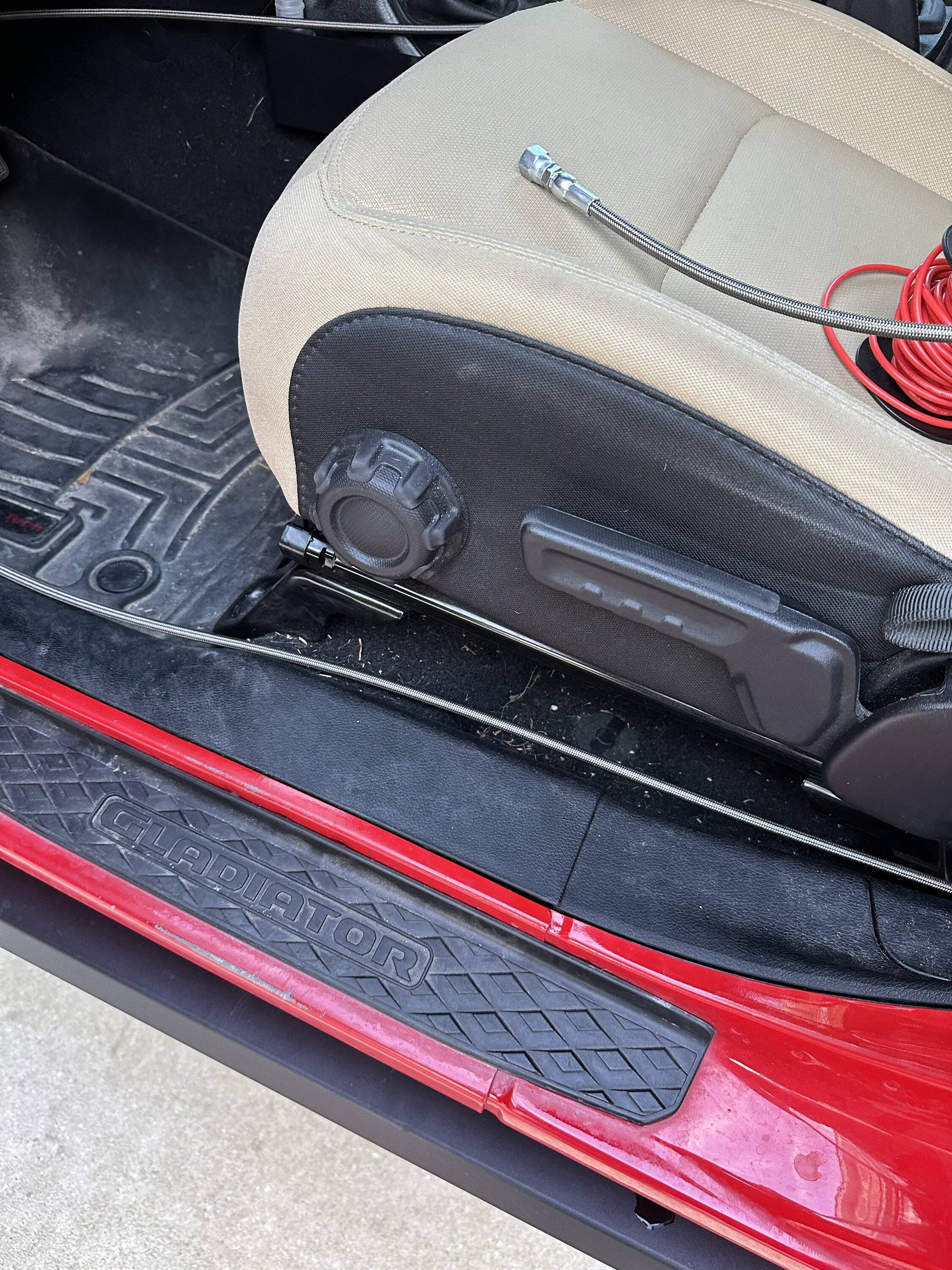

Custom braided hose I had made.
Jeep Gladiator ARB dual compressor rear seat install with 4XE air conversion cowl. IMG_0504

Quick update, I have the ARB pump on the @813 Fabrication & Design rear seat mount now. I like the design and again, it's great dealing with 813. Quick shipping, quality products, and he responds quickly here on the site. I will be trying some interesting things on this build.
Slowly but surely this will get completed.

Really nice install of the air outlet, nice touch with the “air” label. You will be fine using the aux. switches to turn it on and off, less work and less points of failure. The location in the cab is one of the best places in my mind to install and Jeremy’s stuff is well thought out and built, the less heat and elements is a big thing it’s not just a little hot under the hood or fender. I installed single ARB in the bed on the trail rail under an RSI cap but as I surf fish a lot ,I see corrosion a bit on compressor already, but that is from the salt mist in air. Again nice work!….Jack
