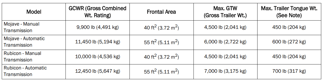

Mojave is always 6,000 tho, with or without tow package. At least the Auto...
Interesting, I would not have guess that. Wonder why?
40,516
54,062
Yes, Rubicon and Mojave are the only two that way.
As far as why - here we go again!
Towing is more than the list of parts, it's the result of a list of parts applied to a specific vehicle in a specific way - frame, hood (heat rejection) gear ratios, axle widths, vehicle weight, tires (remember, the rating is with stock and height anything else goes down) bumpers (doesn't Rubicon have steel bumper regardless?) and more.
Heat rejection was one of the biggest factors in engineering in the original tow numbers so maybe they've found something different with the Mojave (and Rubicon).
Maybe Mojave is lower than Rubicon due to increased height, maybe it's tires, we're all guessing, speculating.
But suffice it to say - all other versions of Gladiator vary with tow package or no tow package, Mojave and Rubicon have the same tow rating in any case - however, don't try to tow that with a ball on the bumper.
I'd bet the book addresses that if anyone even bothers any more.

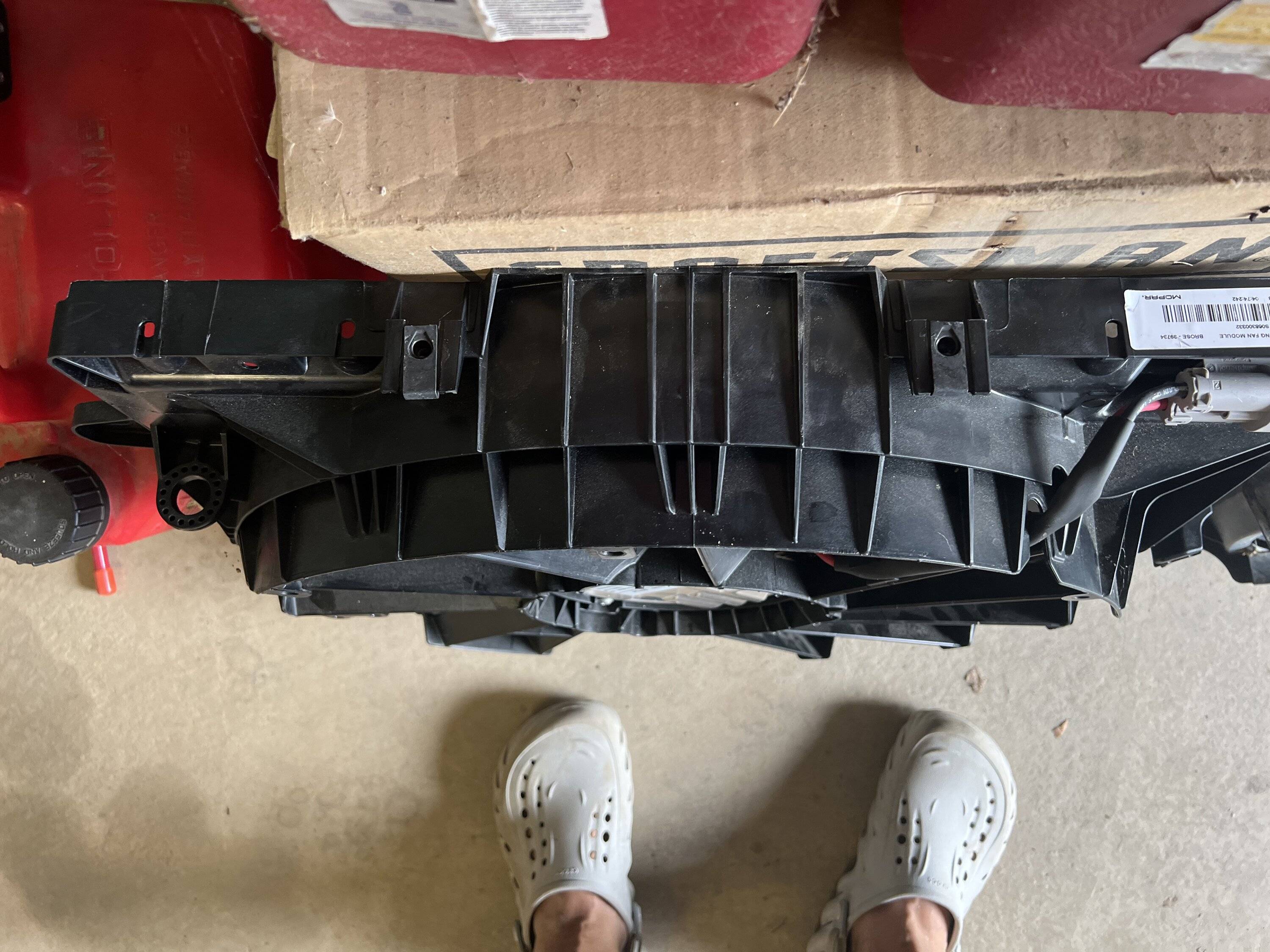

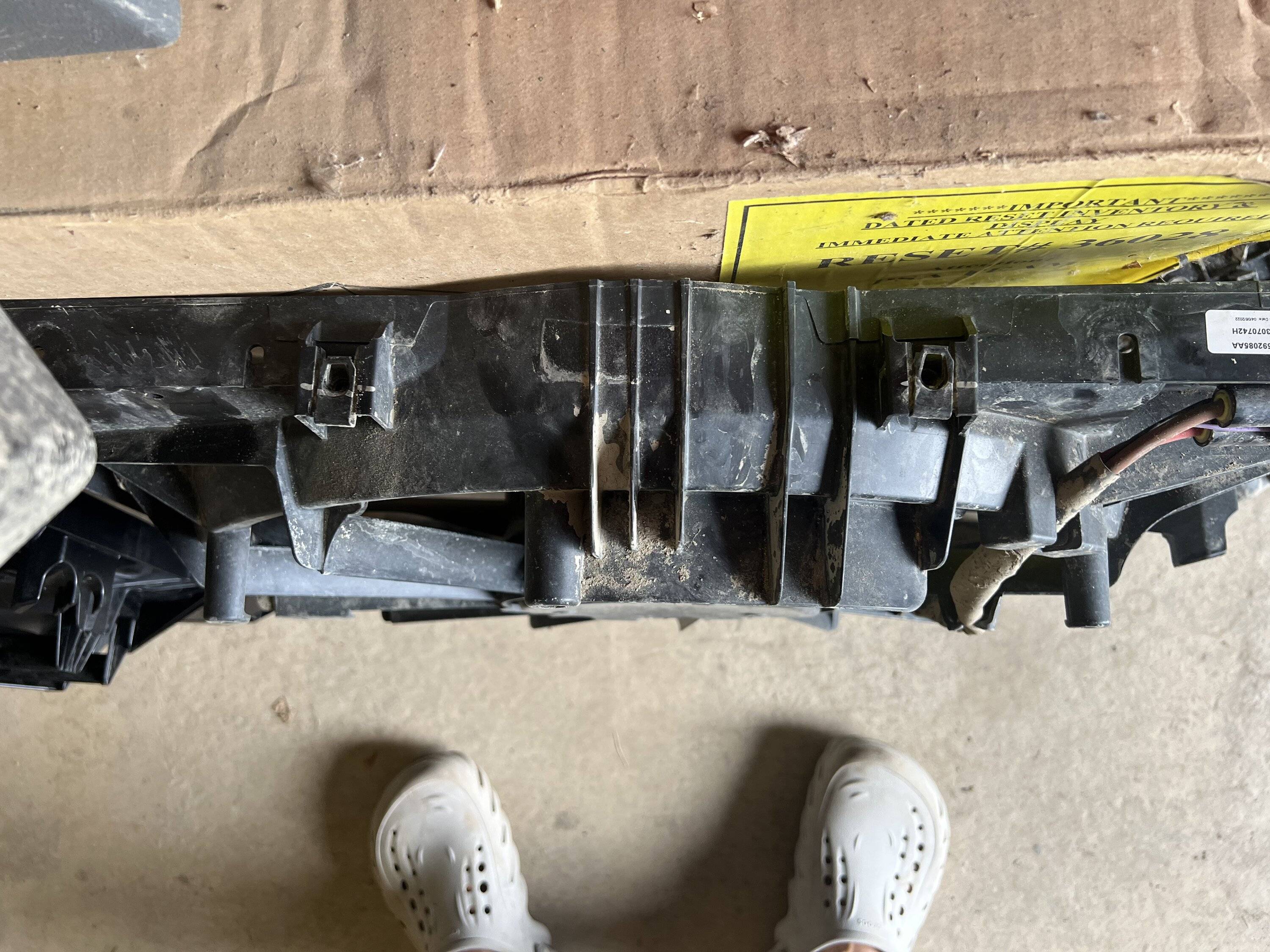

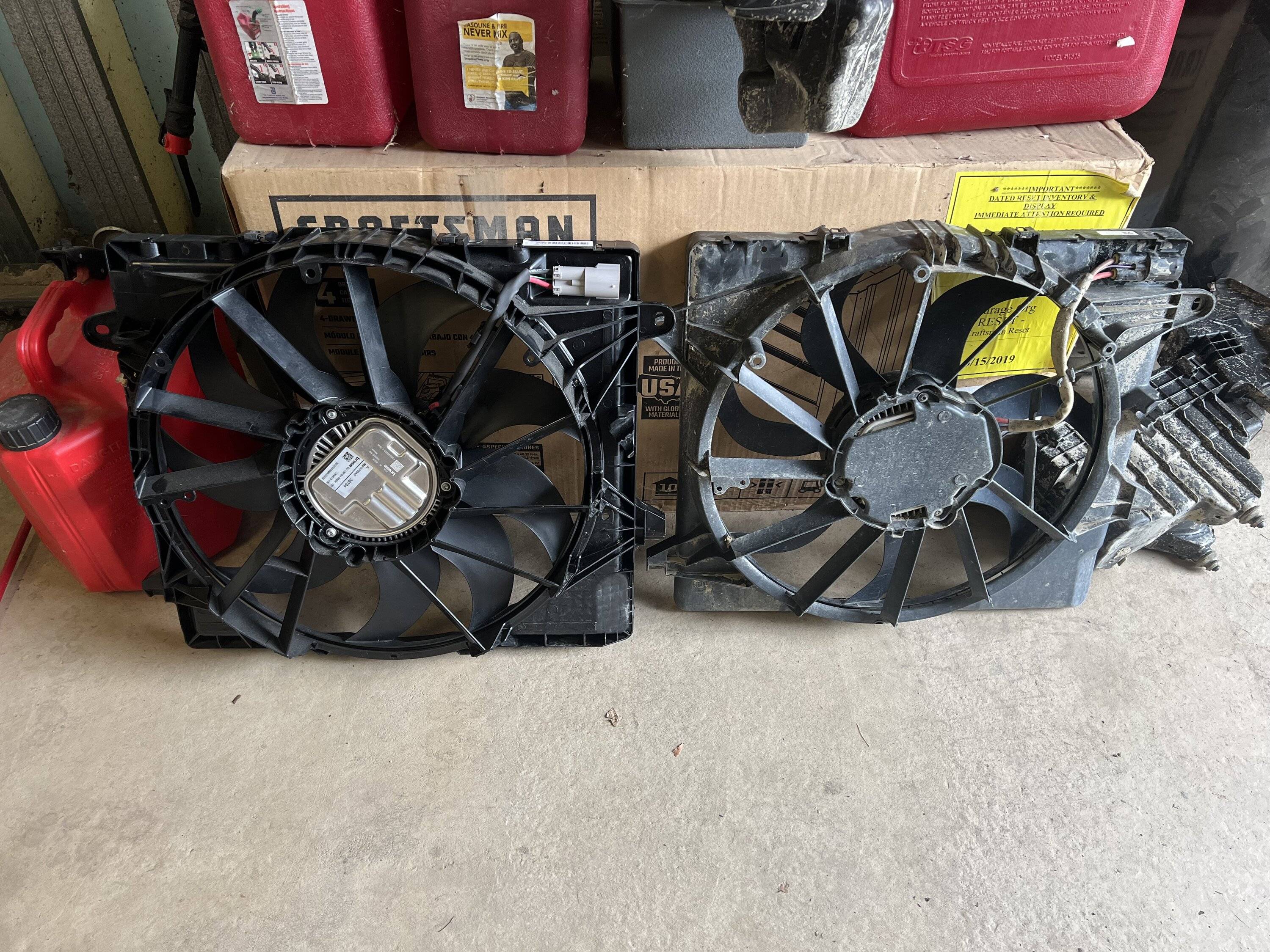

Update: just installed the 850 watt fan. It’s a very easy upgrade to do. It’s a lot beefier than the 600 watt. Here are some pictures of it side by side.
Jeep Gladiator Add 850w heavy duty cooling fan to 3.6L Gladiator that didn't come with it. ( no Tow Package or Max Tow ) IMG_4930
Jeep Gladiator Add 850w heavy duty cooling fan to 3.6L Gladiator that didn't come with it. ( no Tow Package or Max Tow ) IMG_4932
Jeep Gladiator Add 850w heavy duty cooling fan to 3.6L Gladiator that didn't come with it. ( no Tow Package or Max Tow ) IMG_4931

That plastic covering the old fan motor must be new I didn't have that

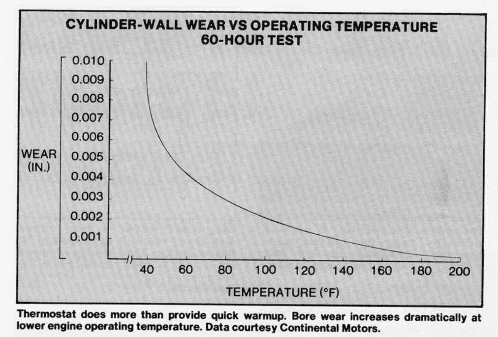

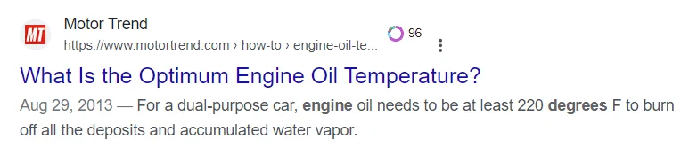

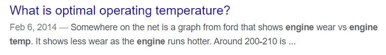

Just don't run too cold. You want to see temps over 200. You never get the combustion gases and moisture out of the oil keeping it too cool. And you wear engines out faster below 200 degrees.
Higher temperatures also promote the flow of oil to the compression ring where most wear (and also power losses) occur.
(I have some science papers on this stuff)
It has been shown that minimum friction (ring to cylinder liner/wall) occurs for liner temperatures in the range 140–150 °C

Fact is - these just don't over-heat unless there's a problem. They just don't.
220 is fine for coolant. Oil that stays too cool, or doesn't get warm enough for LONG enough ends up with pitted and etched bearings. You obviously don't want it to peak too high, but unless you get it up to temp - and then keep it there for a period of time, it's problems. It's not enough to let it hit 200 for example, for a few minutes then drop the temp. it's got to be up there for a period of time.
Again, these just don't have heat issue unless you have a problem.
I've in the past posted the thermostat specs for multiple stats - and although you may see a 190 or 195 rating, that's where they just begin to open - thousandths of an inch. they don't fully open until around 220. So that means the auto makers aren't concerned and want to keep the engine temperature up.
