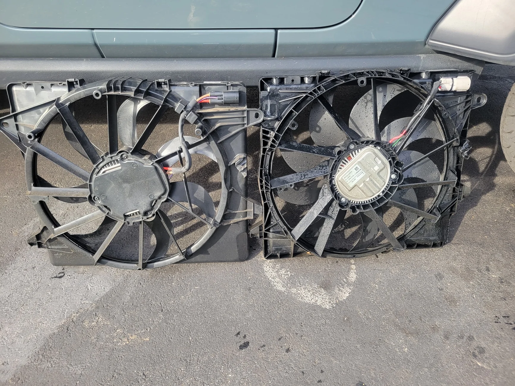

Well, I just double checked my base sport with no tow package or aux switches. Came standard with the H7 battery, 240A alternator, higher amp fuse array but with the 600W cooling fan which fits the build sheet listing for "Standard Duty Cooling"
Since I had my prior 2022 Rubicon JT 850W cooling fan left over when I put the 940W fan in it back then, I swapped out my current 600W cooling fan for this 850W cooling fan.

Yeah, the fan size and efficiency does matter. Hop over to the AMC side of things were people are experimenting with electric fans for performance driving..... it matters.
A larger fan will cool better at lower speeds, it won't need to kick into the highest speed to cool as well as a lesser fan will at its highest speed.
Power to pull the air through.
