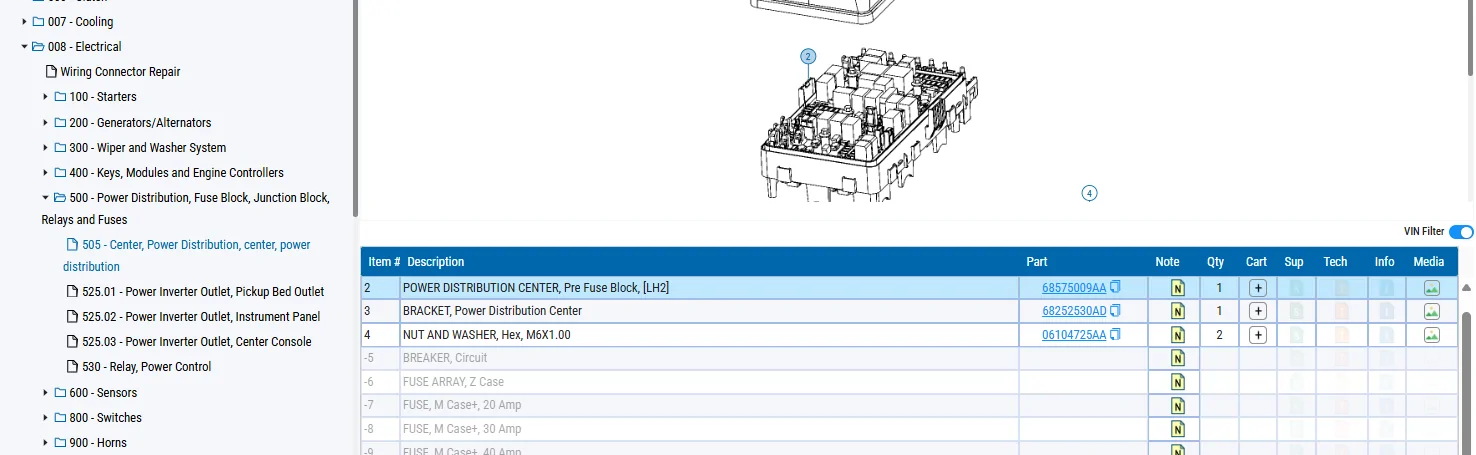

Hopefully this isn't a dead thread. I was curious about adding this because I have the 240v alternator. I reached out to the parts guy at my local dealership and he pulled my VIN and told me I already have the 850w fan and basically told me that any truck with the 4.10 gearing has the 850w fan. So do all Rubicons have the 850w fan?
He also told me that the Z case fuse array ( 68368854AA ) is incompatible with my Jeep. Did the 2024s change the fuse box array setup? Here is the image he sent me to show there's no fuse array on my 2024.

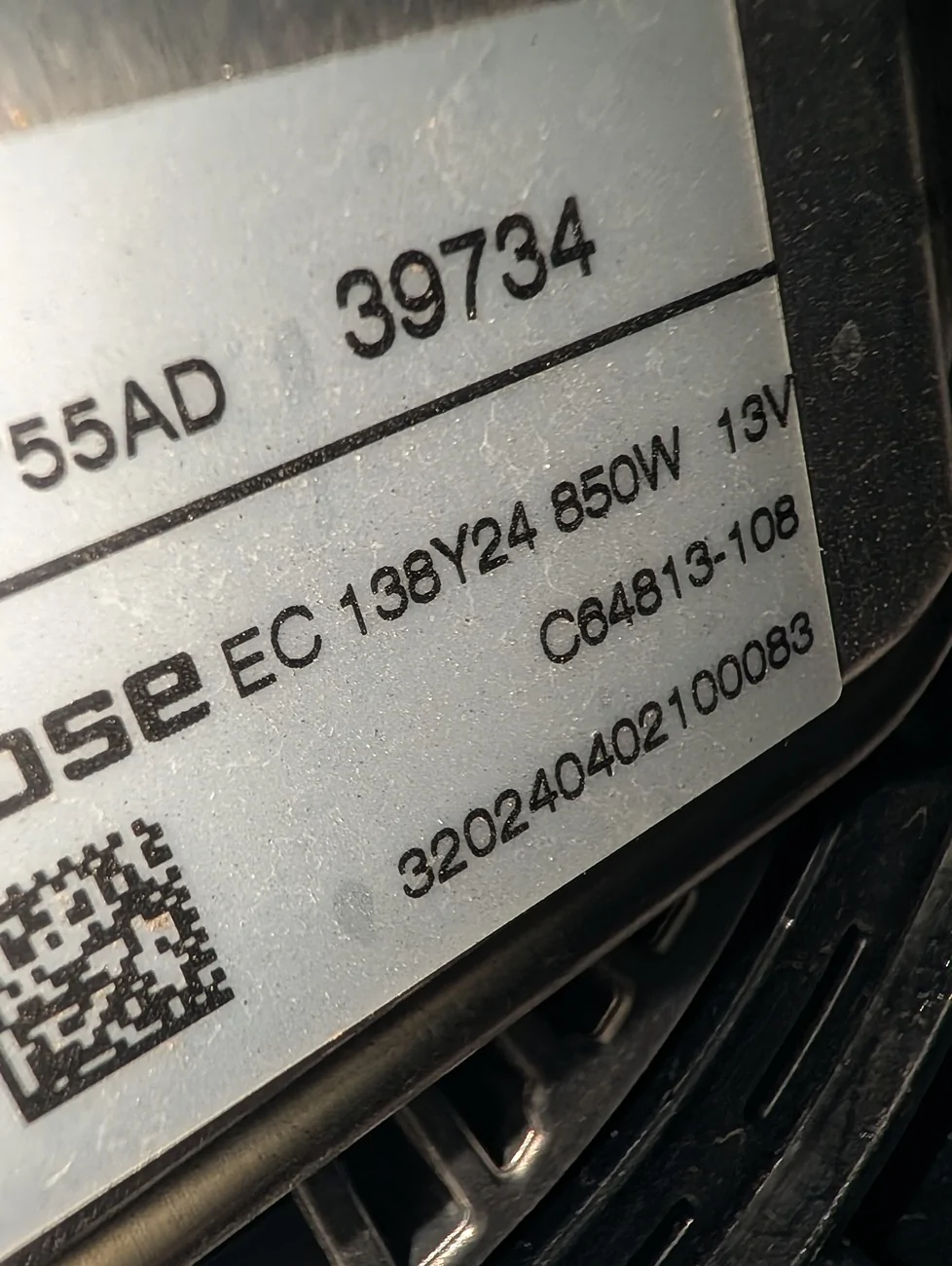

4.10s are irrelvant to the 850. Do you have the factory tow package? If so, you have the 850.
I do not. I have a 2024 manual transmission Rubicon. No tow package. But the parts manager at the dealership is insistent that I have the 850w fan. I'm probably just going to pull it out and check.
The VIN can tell you

Not bad having a look anyway, the vin is not always 100%, albeit I haven't heard of many cases of Gladiators with wrong vin buildsheets.
What does your build sheet say? Should be a line for "Heavy Duty Cooling".
If you do not have it, you can find it at the link below for 2024 and prior model years. Just add your VIN with no spaces on the end of the URL.
https://www.jeep.com/webselfservice/BuildSheetServlet?vin=
I know my 2025 base Sport with no tow package has the 240A alternator and the upgraded fuse array but my build sheet lists it as "Standard Duty Cooling". I suspect I still though have the 600W cooling fan. I will probably verify that today sometime if I can get to it.
