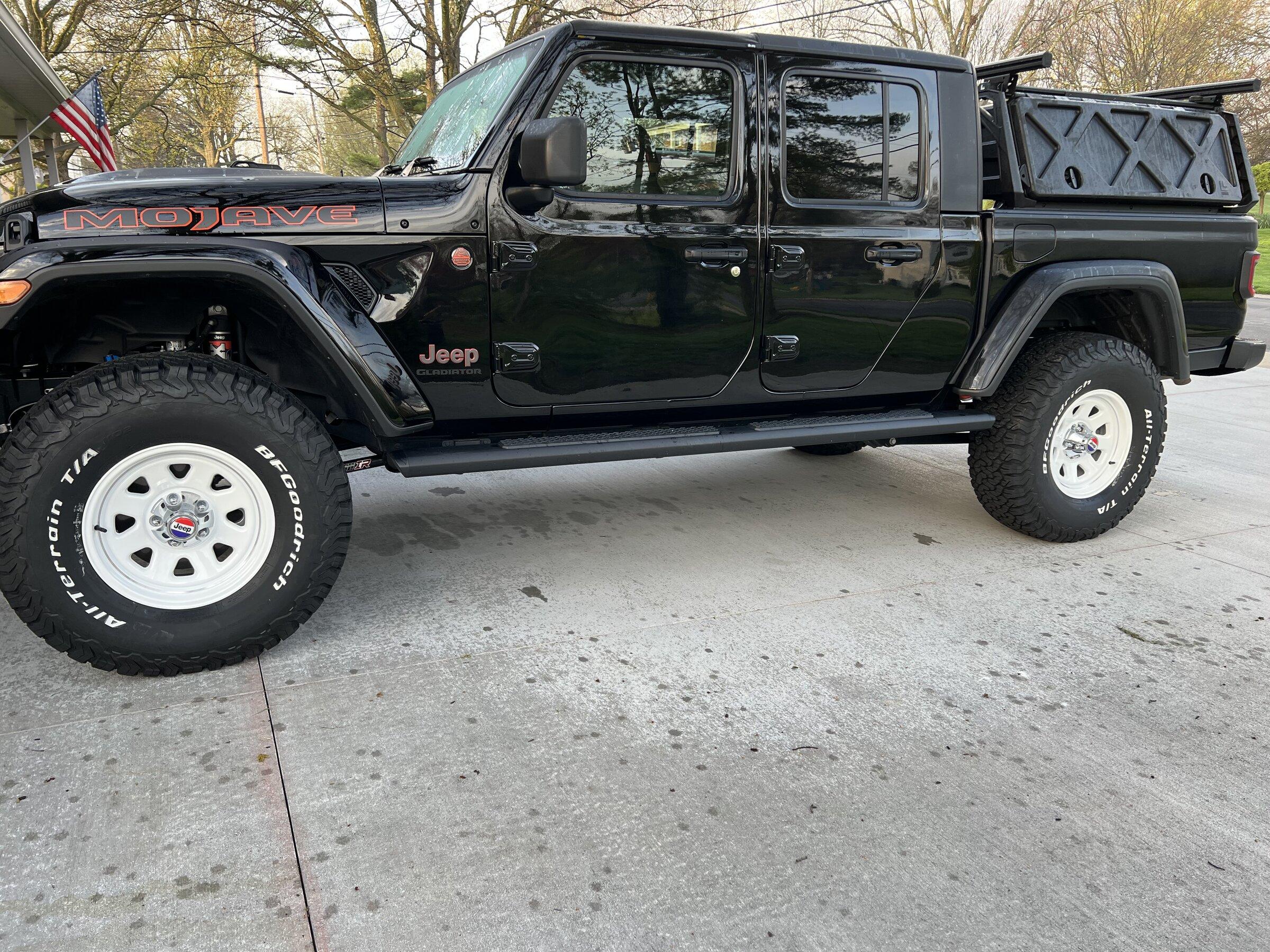

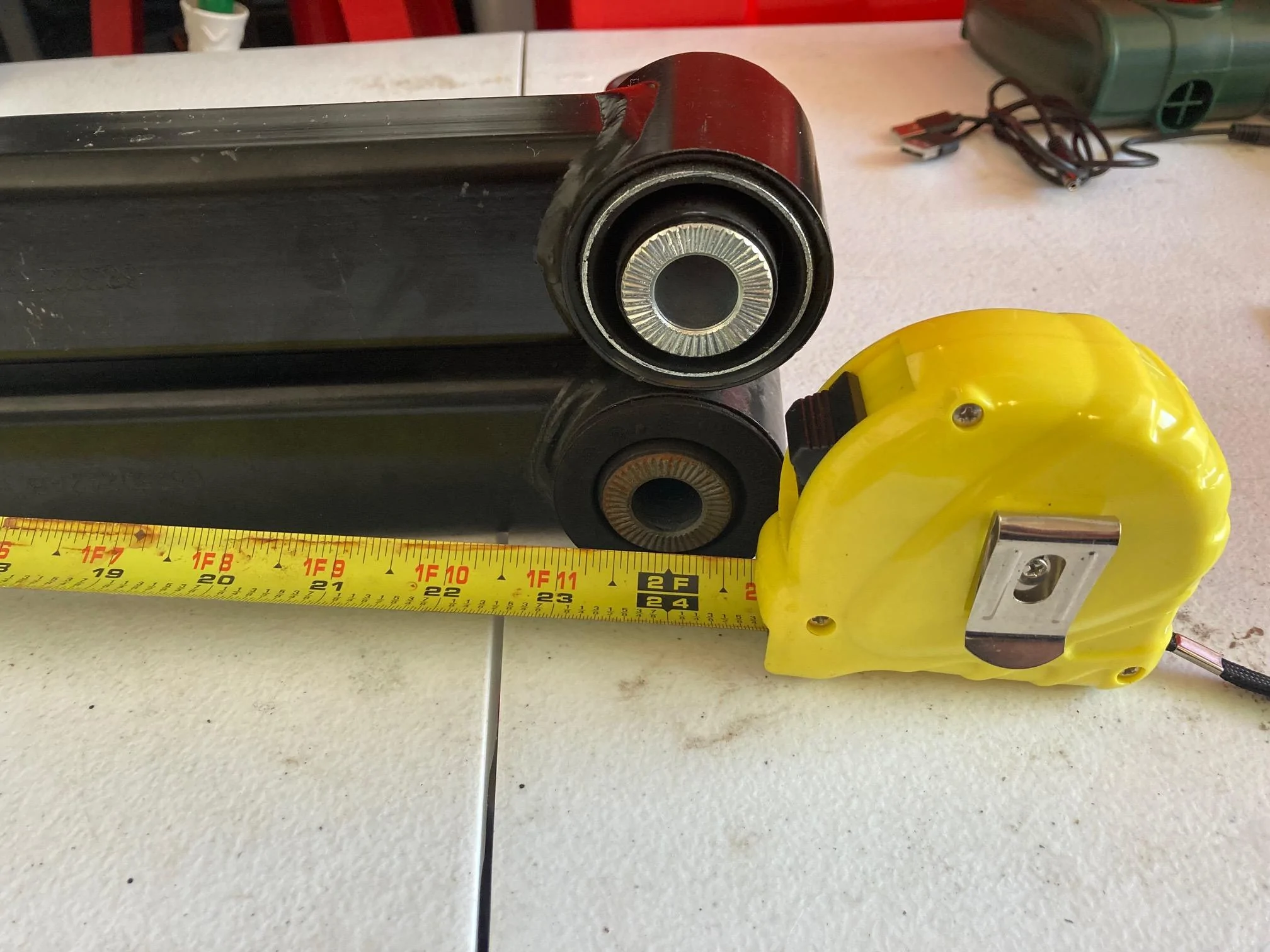

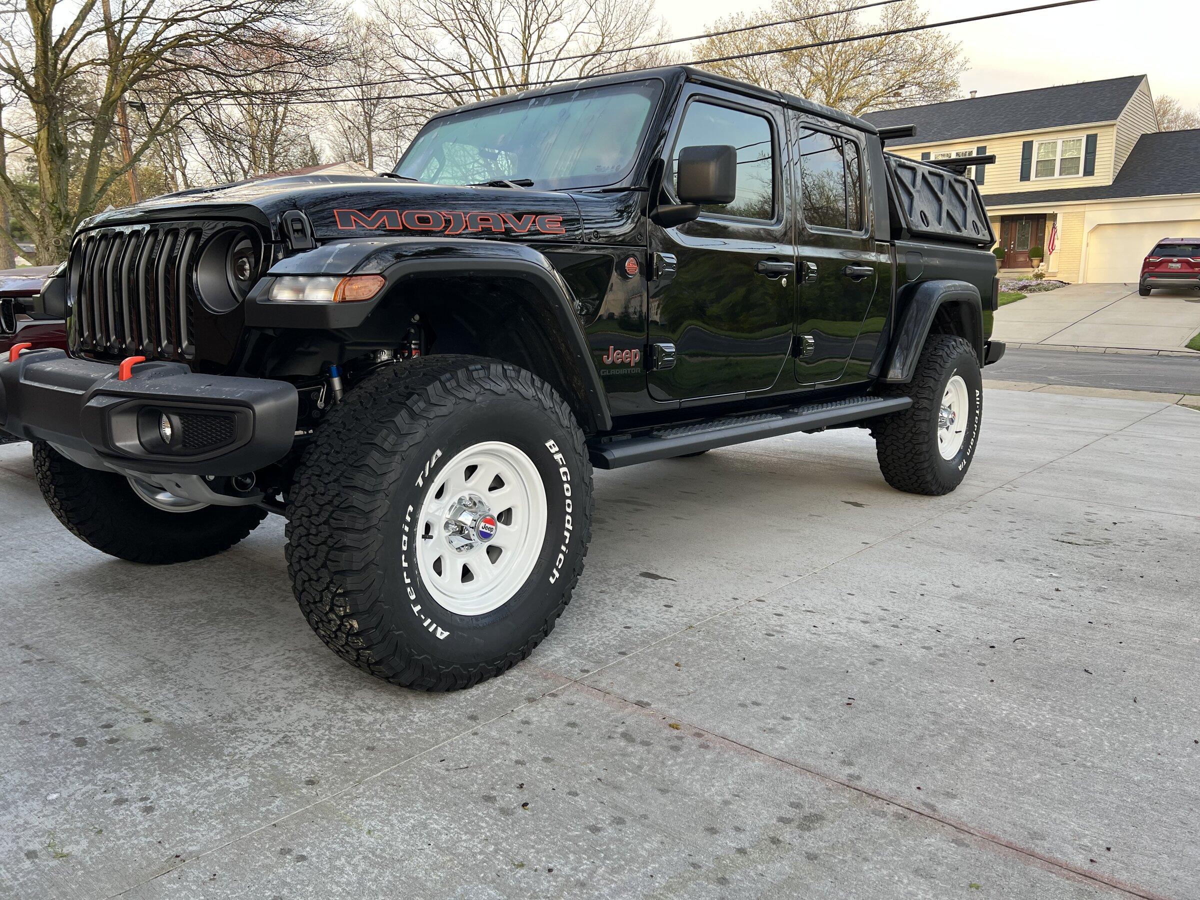

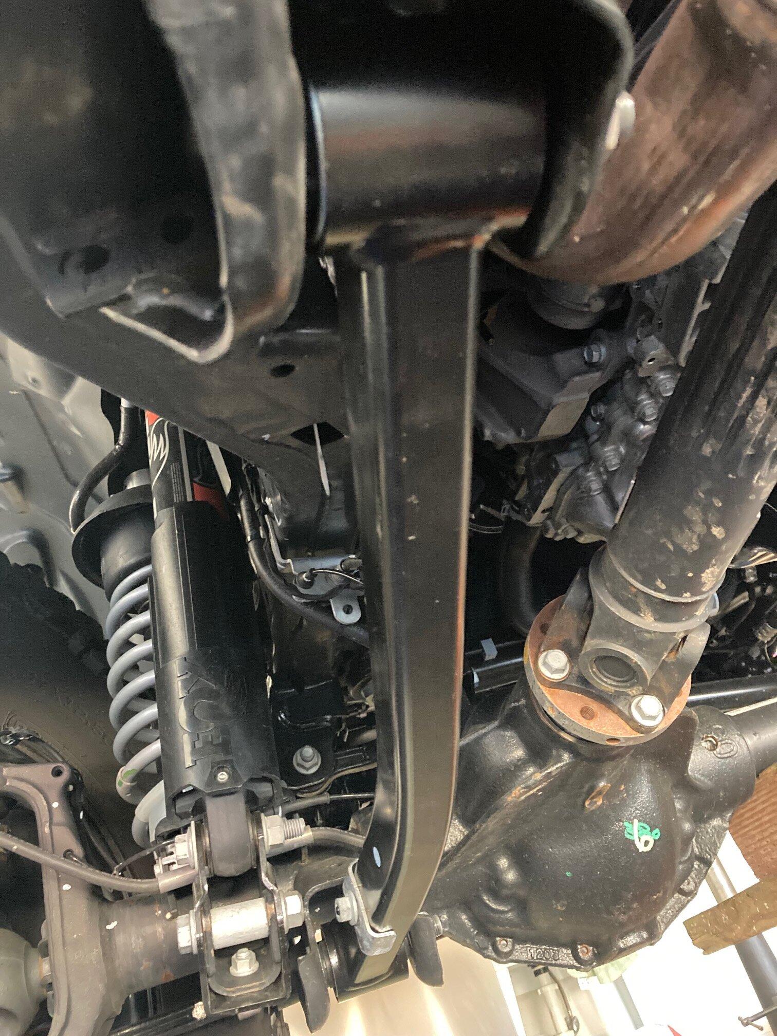

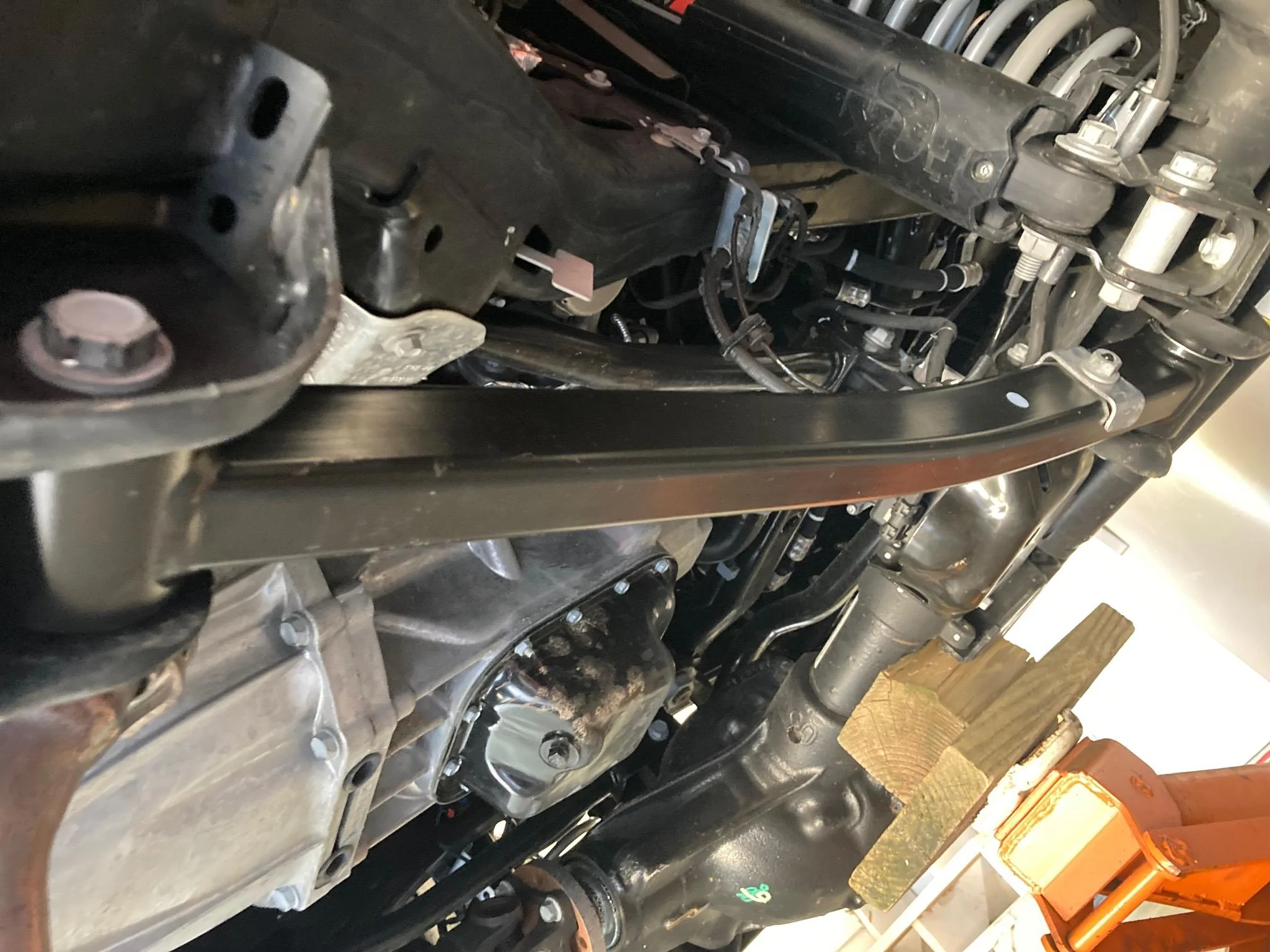

I confuse. Haha - if you are just doing the AEV spacer lift, do you or do you not need the geo brackets? Seems to be no consensus.

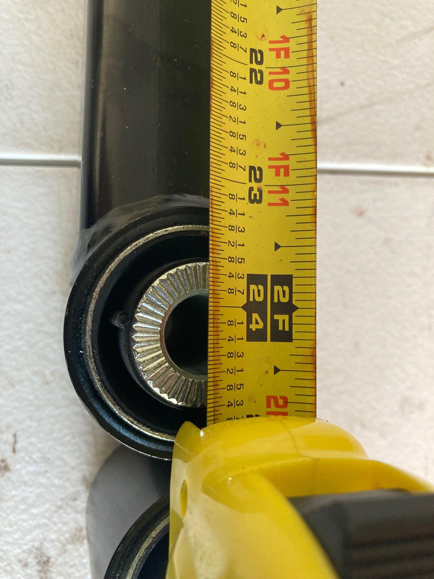

A friend and I did the install in Feb along with the wheels/tires. I drove it that way to see how it felt during various conditions before I decided which option(s) if any, I wanted to do.
I decided to install the front Mopar LCA's and they made a significant difference in the way it drives as I suspected they would. This is on my '21 Mojave.
Please take into account I built custom high end Jeeps for a number of decades.
Installing both of the front Mopar LCA's took a total of ~25 minutes to do including torquing them to spec. There are no length adjustments whatsoever & are very inexpensive at ~$62 + shipping. That 1/4" gain in length works excellent to correct castor.

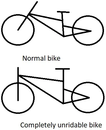

If you're not familiar with caster or why it's important, think of a bicycle. You know how of you push a bike down a hill it will stay upright (excluding any bumps)? That's because bicycle wheels are mounted with caster. The effect of turning the handlebars actually lifts the bike up in the air, which means the weight of the bike and rider naturally force the wheel to straighten out.
Jeep Gladiator AEV 2" spacer lift for Mojave Gladiator bik
Cars operate the same way. Every stock car has a caster angle on the front wheels, and the amount of that caster angle influences how quickly the steering wheel wants to return to dead center when you left go after a turn. You don't turn your wheel back to neutral, you just let go. Caster is what makes that possible.
Too much caster, and turning in becomes a chore. Too little caster, and the wheel don't naturally want to stay as straight.
So when you lift with spacers, you're removing some of the caster. This makes the weight the car uses to keep the front wheels facing forward less effective, and as a result, you'll notice a lot more wander.
I would not do the AEV spacer lift without the geo bracket unless you really enjoy doing a lot of steering to keep yrou truck straight. Had that experience on my 74 gran torino (steering rack looseness, not a caster issue) and i've learned I hate a wandering wheel.

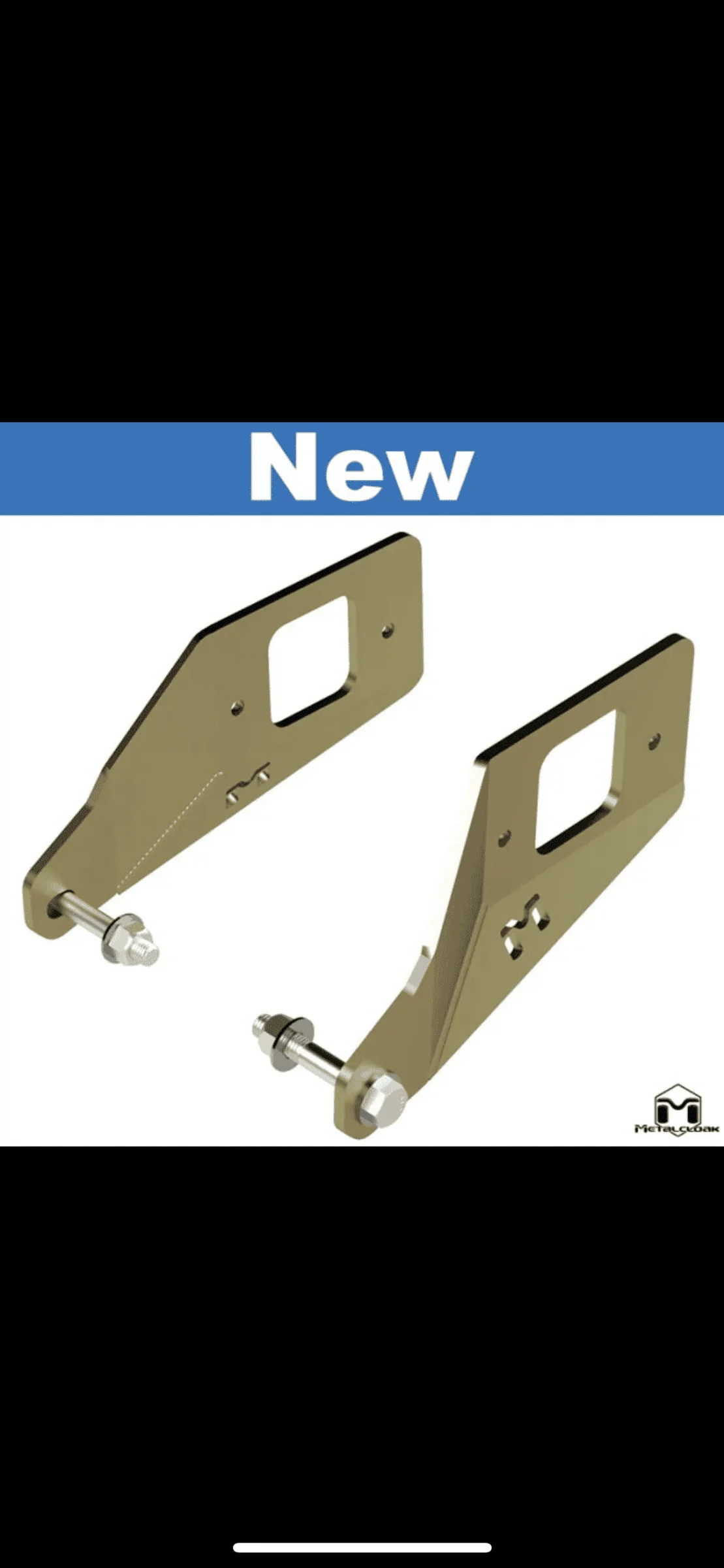

Install a set of Metalcloak reinforcement brackets as preventative maintenance.
The used lift I put on had the previous owner’s stock sway link nut stuck on after it had ripped out of the stock bracket.
https://metalcloak.com/jt-gladiator-rear-sway-bar-reinforcement-bracket.html
