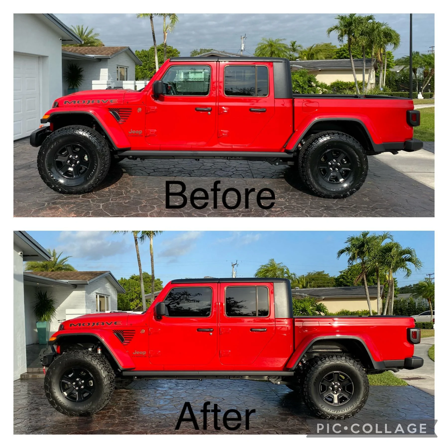

Got my lift Installed this week, haven’t bought the geo brackets yet or lower control arms as I got a little tight after making my first payment haha ? still debating on which route to go with but I know I need to save up and fast as the ride feels less planted now that it went up in height.
I’m leaning towards the geometry brackets as I want to keep it as simple as possible.
My future wheeling adventure plans would be light trails not really interested in rock crawling.
Any pointers?
