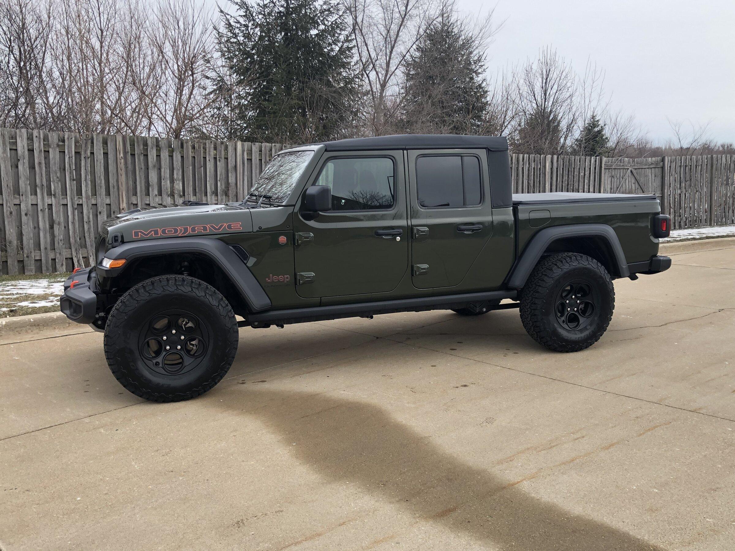

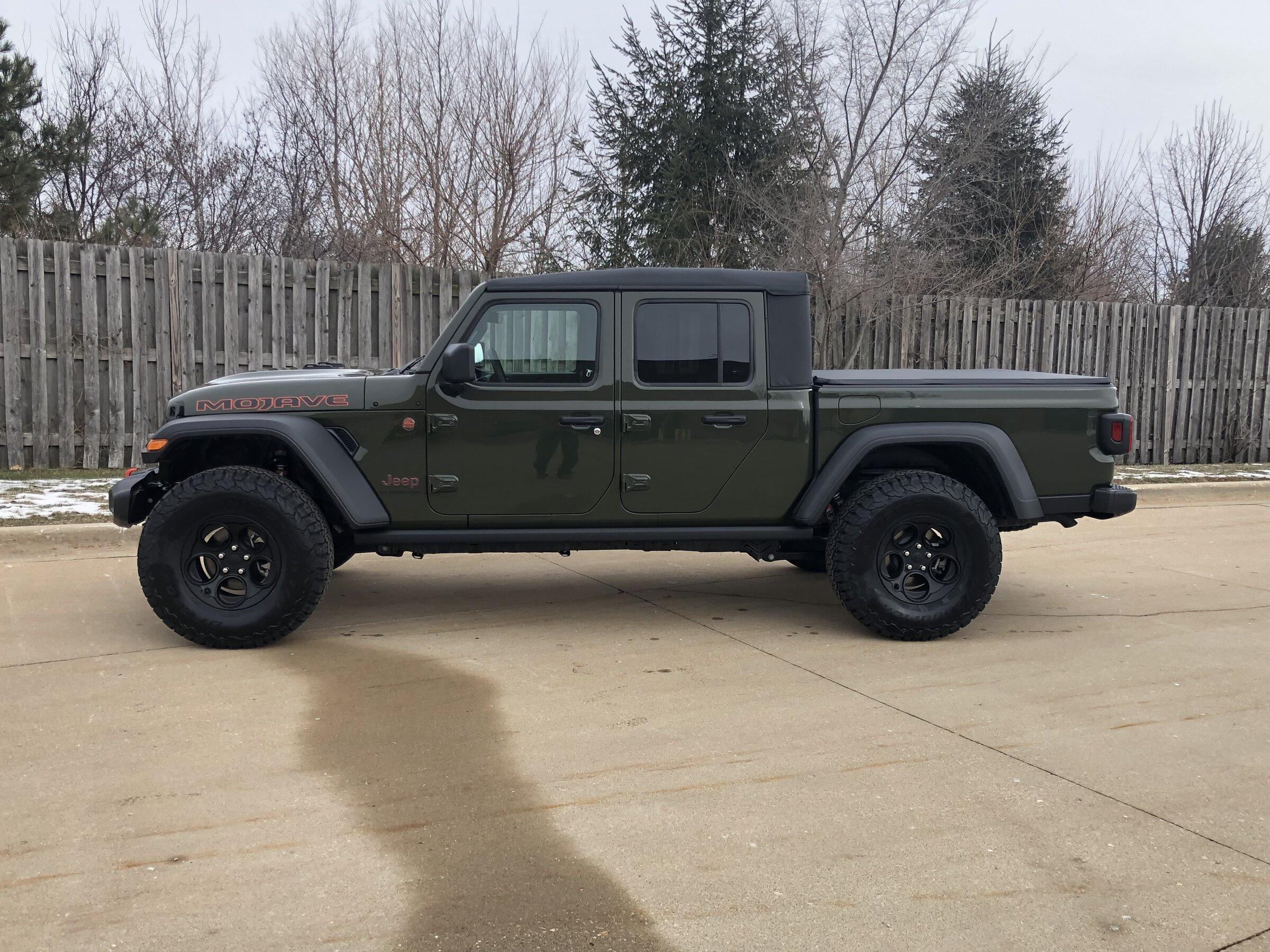

wheatbackdigger
Doug
Jan 13, 2022
Illinois
Gladiator 2021 Mojave
37” BFG ko2’s. Added Teraflex Sport Fixed Length Lower Front control arms to correct caster. Actually over corrected and my caster is around 7.5. Drives so much better at highway speeds. No more wandering, but I may have to go with adjustables to dial back the caster. Not sure what effects a high caster will have on the driveshaft, but I’m sure it can’t be a good thing.

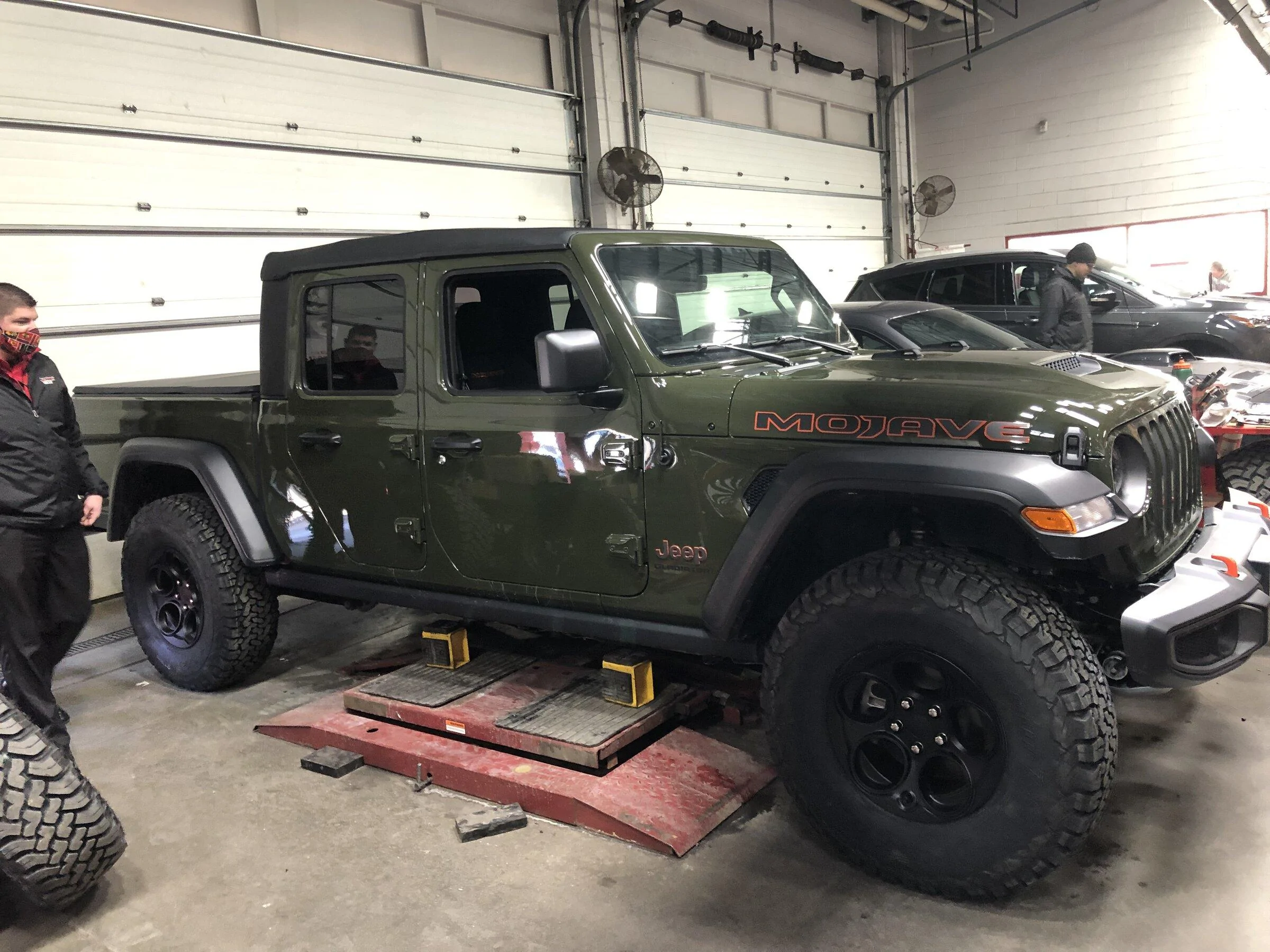

Just added 37” BFG AT KO’s with stock suspension… My AEV 2” lift should be delivered soon. The AEV lift is out of stock and on back order through many of the vendors I contacted but MB Auto out of Indianapolis Indiana has a bunch in stock if anyone is looking for them, spread the word!
